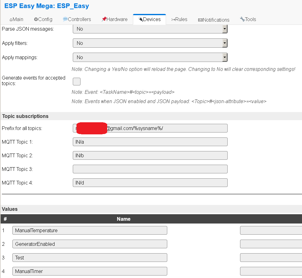

Hi Roman,
Reporting back after applying improvements to the code in my PR. Can you fetch your build from the Github Actions, or do you want me to provide a build for you? If the latter, then please specify what build you are currently using (bin filename please, didn't find clues in this thread) or the ESP type (ESP32/ESP8266), size of flash and a list of plugins you actually use, so I can create a Custom build for you.
Edit: The Github Actions build failed because of .bin size issues (as it does often), so the second option is the best for now ;)

#13 Post by Ath » 23 Oct 2021, 16:38
This is the 'normal' build from my development branch:
ESP_Easy_mega_20211023_normal_ESP8266_4M1M.zip
(606.32 KiB) Downloaded 430 times
And a preview of the documentation: (not yet including the Topic prefix field, that my next task :))

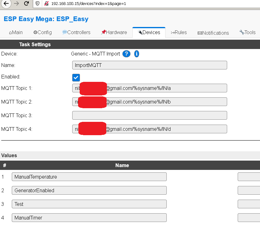

#14 Post by nibiru » 23 Oct 2021, 18:17
Ath wrote: 23 Oct 2021, 16:38 build from my development branch
Already flashed and tested. It is working!
Now I am thinking about applying the new features of the plugin (filter). Now filtering (or rather normalization of incoming values) is done using rules. But by using the new features, I maybe can save a little space in the rules.
Many thanks for the provided build and new plugin features!
Roman.
