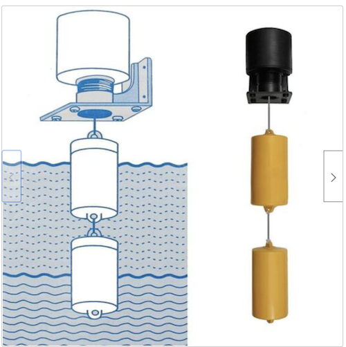

Personally i don’t see why a microcontroller is necessary.
I solved this issue with a levelswitch like the one in the picture below. It is completely analog. The switch opens when the water is lower than the lower buoy and closes when the water level reaches the upper buoy...

I know.. but the answer still solves your problem.... you can of course hook the switch to your microcontroller. whatever suits you.That was not my question!
The fun is in having the status of the switch/pump visible on your computer-screen (PC, tablet, mobile, etc.), and having the on/off log in Domoticz (so you can back-track when exactly it overflowed while you where away

Can you please elaborate your problem. i don´t quite get it i guess....
In my understanding a switch is also a sensor and tied to a buoy it makes a perfekt level sensor.
I should mention that my pond is actually a sewage water tank. I can assure you there is also a little bit pollution in it but it works fantastically ....
