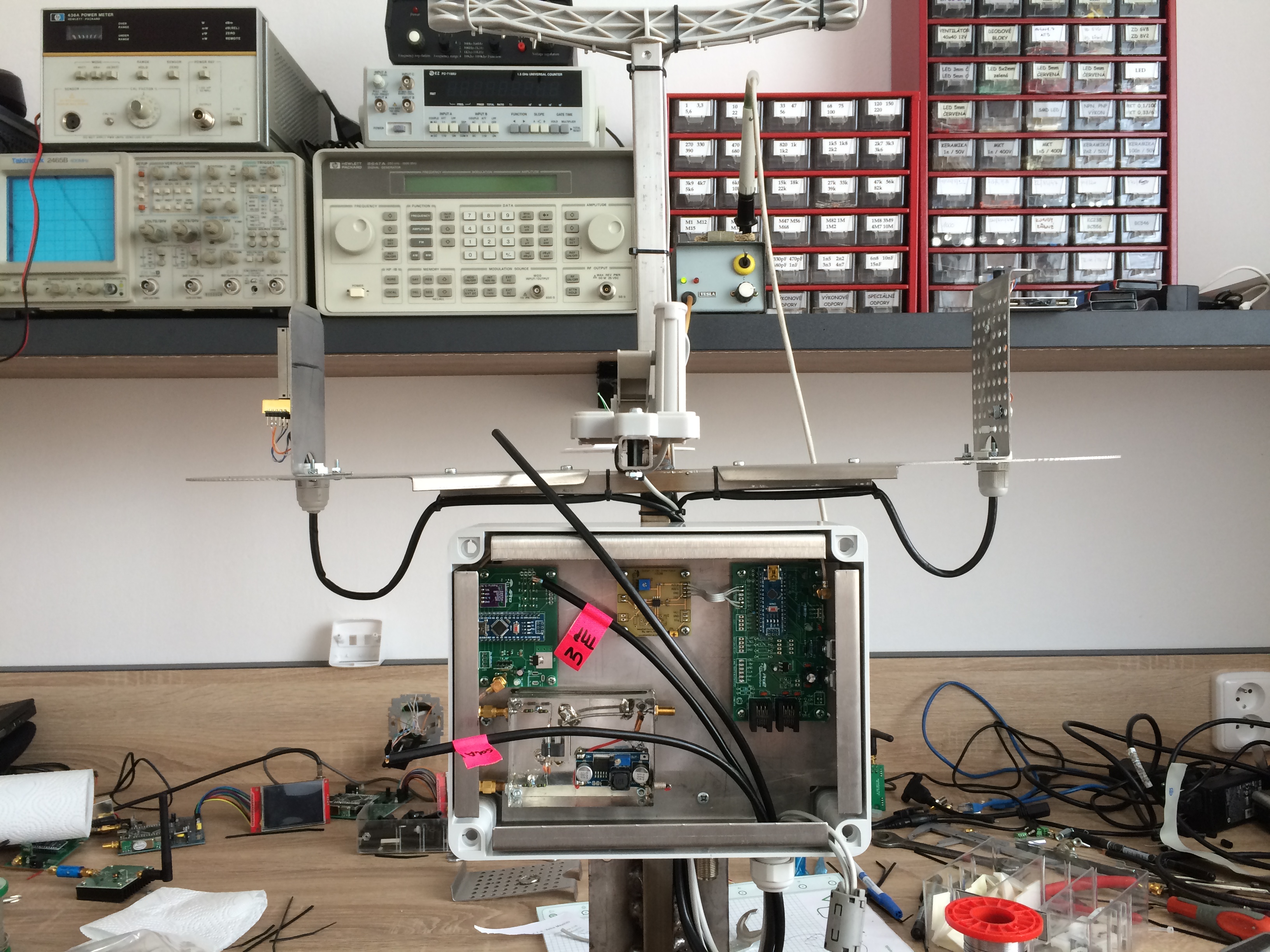

I can use some sensors from old WX... Is also home-made, but i am problem with posting data out from local site. I would like use node-red, mqtt and other, is better...
I found VEML6075 but is not supported in las version fw, anybody know what is not supported?
Some pic from old WX...
