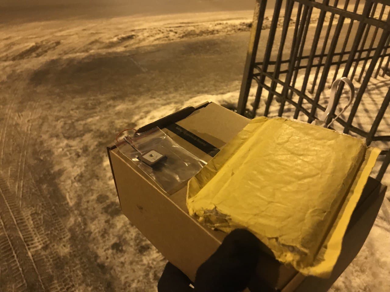

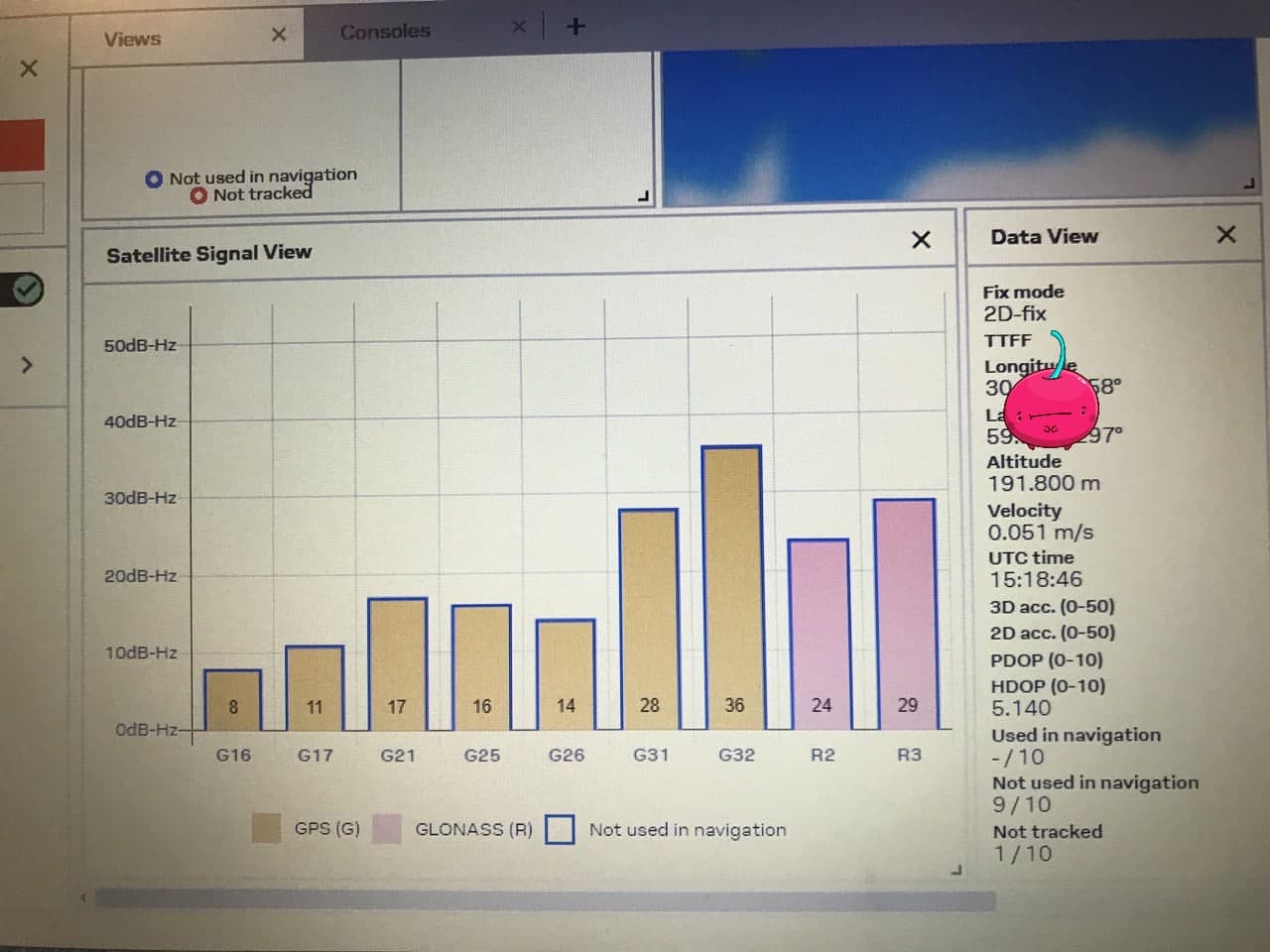

I`ve tried yesterday one of two from the parcel
Weird thing

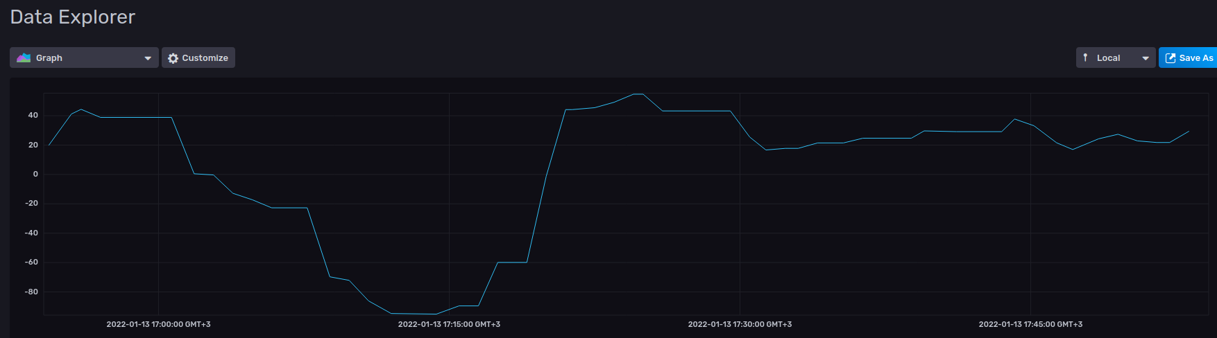

I've already seen: unstable FIx from windowsill, incorrect height measurement and, maybe(!) even ESP hanging.
And it seems to me i cannot get any data via mqtt when bn220 is not in Fix state
(Home Assistant (openHAB) MQTT)
It could be so? I've used tcpdump to look up.
While i'm looking at (old?) GPS data in "Devices" with Fix 0, i could see only service mqtt traffic without data about "long","lat" )
When "Fix 1" is ok with data.

The was shoked about "alt" value in meters.
(i didn`t check the accuracy of "lat" "long" yet)
- Screenshot from 2022-01-13 17-54-08.png (41.15 KiB) Viewed 12837 times
Re: Gps: Neo-6, Neo-7 is good enough?
Altitude is notoriously inaccurate on GPS receivers.
For 2D navigation, you can think of pinpointing the intersection of 2 circles, where the satellite is the center of such a circle.
With 2 satellites you get 2 intersecting points, so you need a 3rd one to know which of the 2 your position is.
But imagine 2 large circles where the centers are rather close to each other from your point of view. Then it is rather inaccurate to pinpoint the right position where they intersect.
If the only satellites you see (or actually, the ones you track) are relatively close to each other, the computed position has a high inaccuracy.
In the GPS NMEA sentences, this is expressed as "HDOP" (Horizontal Dilution of Precision). It is the standard deviation in units of roughly 7 meters. (depending on the used GPS receiver, but 7m is about average for modern chips)
The same applies for the vertical resolution, expressed in VDOP.
However most GPS receivers are less sensitive to the "horizon" and thus from your point of view the tracked satellites are close to each other when looking up.
This does result in a large VDOP value and the factor in vertical direction is also more than this 7m.
For connecting the GPS to hardware serial, you can either connect it to Serial0 on pin 1 and 3 or Serial0 swapped on pin 13 and 15, but then you need to disable "Use Serial" on the Tools->Advanced page.
N.B. for a GPS you typically only need to connect the GPS TX to the ESP. This is especially important when using Serial0 swapped, as GPIO-15 needs some attention.

I've checked with u-box program
Is is usual dBs for the devices?
I see the average level of 20-30dB
Is it`s OK with antenna?
Also I have a recorded file from u-box program and i can send you if it help.
A saw GPS(Gx),Glonas(R) and SBAS(one or two)
