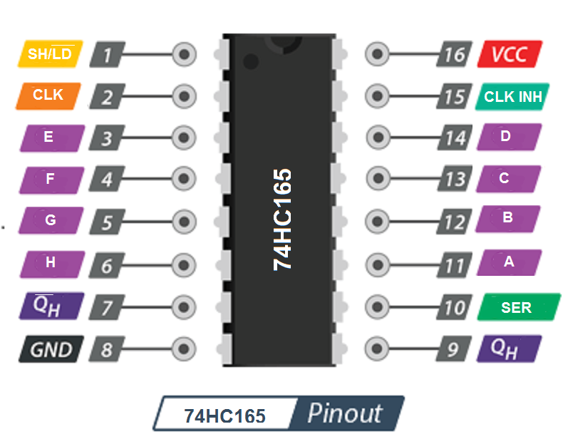

74hc595 and 74HC165 are shift register chips, not really a GPIO extender.
Not supported though.
Those can be useful, but are rather tricky to use.
For example if you want to update 1 output you may need to rewrite all of them, depending on their current state.
This means they may toggle their state during update.
They can also be used to store a burst of serial bits, but I doubt that's how they are connected.

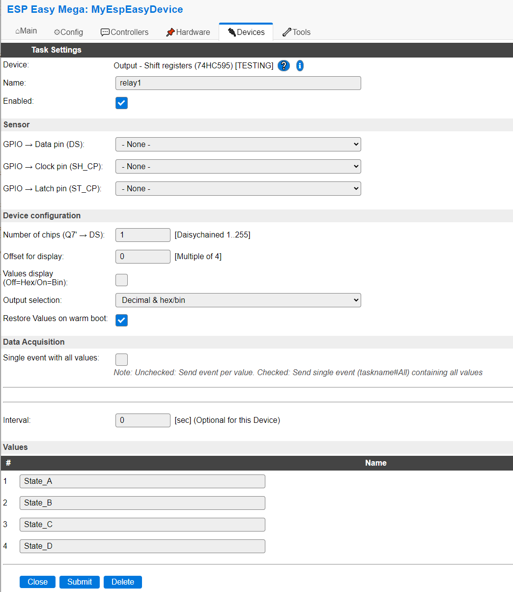

See the progress on the support for the shift registers used on this board: https://github.com/letscontrolit/ESPEasy/pull/3917
So even though Ton doesn't have such a board (yet?), nor those chips, he still managed to make a very usable plugin for it.

Re: Dingtian IOT Relay
#15 Post by Ath » 24 Jan 2022, 13:44
TD-er wrote: 24 Jan 2022, 11:48 So even though Ton doesn't have such a board (yet?), nor those chips, he still managed to make a very usable plugin for it.
Didn't order the board, and probably won't as you can't select having the ESP32 version explicitly (it's not even listed on their site :shock:), and that's the only one I'd want (though it is a bit pricey).
Do have a 74HC595 chip laying around, and can obtain a 74HC165 easily, so, OK, I'll bite, I'll reserve Plugin ID P129 for the Input - 74HC165 Shiftregisters, and create a plugin for that soon. :lol:
#16 Post by Ath » 24 Jan 2022, 13:46
iron wrote: 24 Jan 2022, 13:13 Does this plugin support the 74HC165 as well ?
Shall I try to flash the sample on hand or is it not time for this yet ?
No, the 74HC595 plugin is for output only.
Yes, if you can test your board with P126, I'm very interested in your findings.

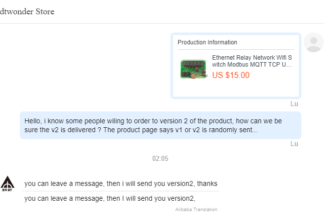

I got in touch with "dtwonder Store" on Aliexpress regarding the random delivery between v1 or v2 of the board. They explained that if we send them a message, they will send v2.
Of course if it's not the case, I believe you're just out of luck, and not sure you could expect an exchange...

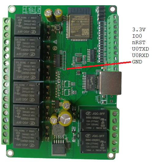

IO0 is used by LAN (RMII_RST) so I tend to believe my failed attempts are due to this
https://docs.espressif.com/projects/esp ... ction.html
Steven's (Dingtian guy) exact words were :
"...For current relay board in your hand, it cannot support develop and program to your firmware by UART..."
I now, after many failed attempts, tend to believe he knows what he is talking about but I am still wondering what he does in his driver the get away with it ?
-D

iron wrote: 21 Feb 2022, 14:14 IO0 is used by LAN (RMII_RST) so I tend to believe my failed attempts are due to this
Need to check closer. Anyway, I'll have to pull IO0 down before flashing..
#27 Post by TD-er » 21 Feb 2022, 15:06
Looks like the LAN crystal is connected to GPIO-0.
But then there must be another pin on the ESP to delay starting the LAN (or the crystal) or else the ESP will boot in flash mode about half of the time.
Maybe you can also pull down that pin?
Not sure how the crystal is connected to GPIO-0.
Some would include a resistor in series, so you can pull down the pin without pulling down the crystal clock output too hard.
#29 Post by TD-er » 21 Feb 2022, 19:50
But I think that's not needed.
As long as you can prevent the external crystal for the LAN adapter to start, you can flash it.
Maybe hard short circuit GPIO-0 and GND (or use a 470 Ohm resistor to be sure) and then power it on.
This will turn the ESP into flash mode for sure.
You then need to remove (or disconnect) this short to boot into normal mode again.
ESP32 does act different on the state of GPIO 0 at boot, when power cycled or during a warm boot.

I have replaced ESp32 by a new one on Dingtian IOT relay 8 and upload EPSEasy with Add 74HC595 Shiftregisters plugin. Somebody can explain me how work?
#40 Post by Ath » 11 Mar 2022, 08:52
bruno17 wrote: 10 Mar 2022, 23:40 I have replaced ESp32 by a new one on Dingtian IOT relay 8 and upload EPSEasy with Add 74HC595 Shiftregisters plugin. Somebody can explain me how work?
The pin configuration is shown here (above)
DS: GPIO 13
SH_CP: GPIO 14
ST_CP: GPIO 15
AFAIK, there is only 1 74HC595 on the board, so "Number of Chips: 1" seems correct.
After setting that up and enabling the plugin, you can use the commands as documented in the pull request. These commands can be entered in a rule, submitted from the Tools page or via a browser-url command to the ESP.

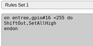

Hello, It's not easy to use rule on ESPeasy, but I try this sample and the output of 74hc595 doesn't high level.
Capture d’écran du 2022-09-15 15-13-44.png (9.11 KiB) Viewed 32810 times
Capture d’écran du 2022-09-15 15-08-50.png (39.78 KiB) Viewed 32810 times
Could you help me please
#42 Post by Ath » 15 Sep 2022, 20:11
Your syntax is incorrect, you can't do a compare on the value in the event definition.
Your event could look like:
on entree#State_A do
  if %eventvalue1% < 0xFF // Hex numbers can be prefixed with 0x, binary with 0b
    ShiftOut,SetAllHigh
This requires the Interval setting to be > 0 to generate the State_A event for the entree task.
But I don't understand what you want to achieve with that logic, maybe you can explain on what 'entree' condition all output pins on 'Sortie' should be set to high?
