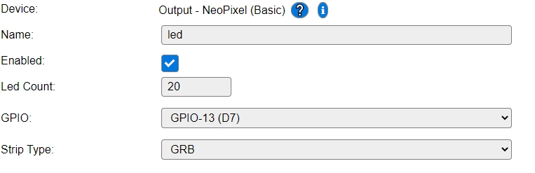

And now it's fun when I send the command NeoPixel,1,255,255,0
A various number of leds switch on with some variable colours...
If i try the command NeoPixelAll,0 : sometimes colors change but never switch off.
