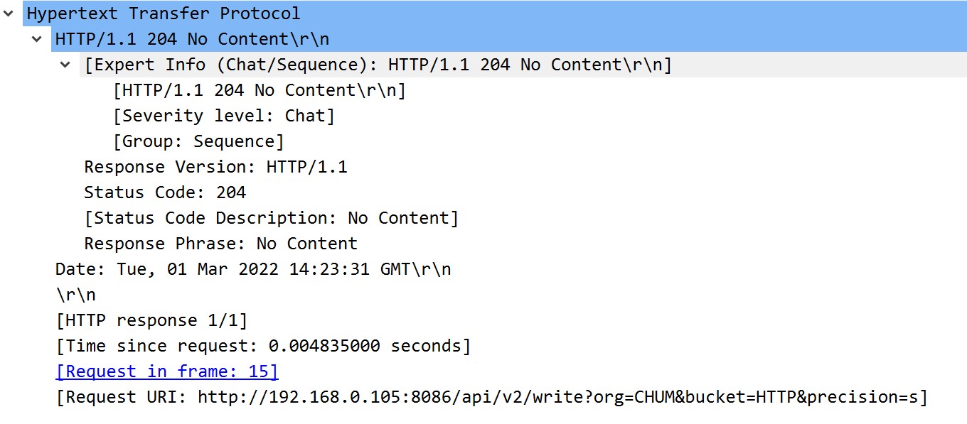

When I use curl, this is the POST that I get:
And this is the response:

#5 Post by Ath » 01 Mar 2022, 16:07
Your OP has "Authorization: Basic <username> Credentials: : " with response "Unauthorized" (status code 401), and your Curl attempt uses "Authorization: Token <tokendata>" that is accepted (status code 204), so your manually pasted Authorization in the Header apparently isn't overwriting the default username/password.
