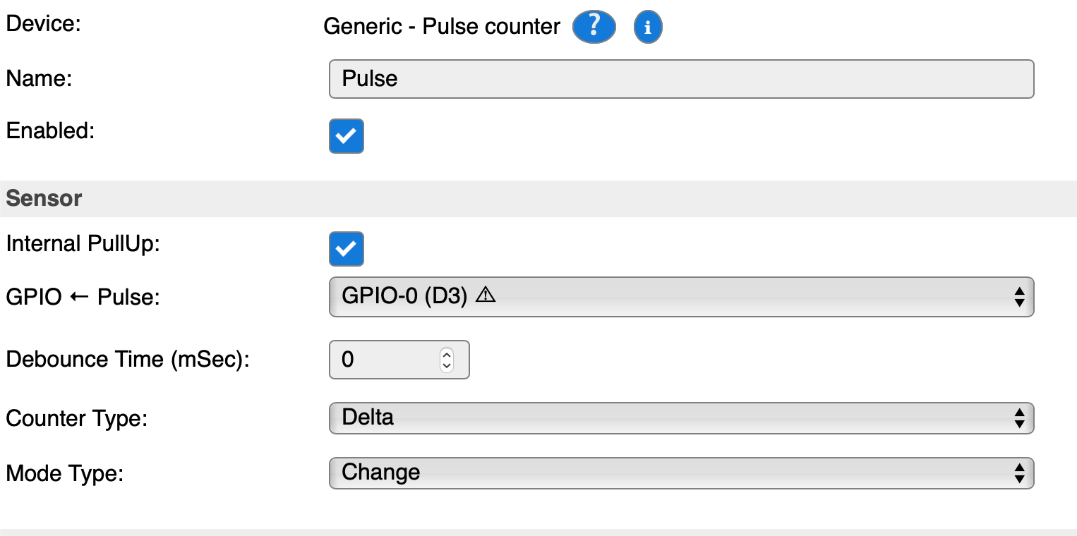

#21 Post by Trainer » 03 Jul 2022, 17:11
TD-er wrote: 16 May 2022, 13:37 The ESP is rather tolerant, so that's not an issue.
But what might be an issue is that it isn't an UART signal.
It seems like it is a 50 Hz clock and not sure if this low baudrate can be read using a UART.
Can you simply test using the pulse-counter plugin to see if you do receive pulses?
If that's happening, then you know it is electrically connected how it should be.
i try pulse count and get some values
Bildschirmfoto 2022-07-03 um 17.10.52.png (99.14 KiB) Viewed 21390 times
Bildschirmfoto 2022-07-03 um 17.09.28.png (43.55 KiB) Viewed 21390 times
Trainer
Posts: 25
Joined: 03 Apr 2020, 15:45
Re: P092_DLbus UVR42
#22 Post by Trainer » 03 Jul 2022, 21:28
How can i fix it?
For me, the temperature data would be very important, as I have to use up the excess energy.
I can still test the next two days if you have a suggestion.
Thank you in advance.
#24 Post by Ath » 08 Jul 2022, 21:20
You haven't yet confirmed if your device is actually sending an UART/serial/DLBus compatible signal. If it is using a different, proprietary protocol, not supported by the DLBus/P092 driver, then there is no way of decoding any sensible values from it.
The pulse-counter just detects any signal that changes from high to low, and reverse, so there is no way of extracting any temperature information from that, it merely counts the irregular pulses, that's why it seems to work ;).

#26 Post by Ath » 09 Jul 2022, 14:46
Well, the last image you shared shows a Pulsecounter task, not a DLBus task. I don't think there is a relation between P092 and the Pulsecounter. That's why I asked.
And to have UVR42 support in P092 you will need a build (with TEST_C in the name) from the PR I created for that, as linked above (Just updated it a few seconds ago).
When connecting the UVR42 to the ESP, proper level conversion has to be done, but I think you've got that part covered.

Ath wrote: 10 Jul 2022, 21:12 If the device is using the DLBus protocol/signal, then the plugin and/or the ESP8266 won't have trouble reading it.
The device configuration just has to be set correctly, and that should take care of things. For UVR42 an extra sensor option had to be added in that configuration, as that code is not yet included in the regular releases of ESPEasy, you should use the .bin file from the pull request, that has the new code. The regular releases don't yet have the option to select the UVR42 device.
i tried it again but no luck. i use a optocoppler to transfer the UVR42 voltage to a 3,3V GPIO signal.
I count Signals an the input but no value shown for my Sensors.
Do you have any hints why i can't see any values?
#34 Post by Ath » 26 May 2024, 13:19
Again you also have a pulse counter task on the GPIO that's to be used by the DL-bus reader. Can you disable all but 1 task that is trying to use that GPIO, (one of the DL-bus tasks should be the only one enabled), to exclude that as a possible cause of interference?
There are, AFAICS, no other reports of this plugin not working, so I expect something in your configuration isn't correct.
