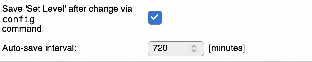

Re: Engine Hours counting when 12v on a particular pin
You could misuse the level plugin to store a value on flash.
This can be stored like this:
config,task,<NameOfTheTask>,setlevel,<ValueToStore>
It can be read like this:
[NameOfTheTask#getValue]
But.... Don't set this value too often as it will save your settings (when checked to save it)
Or you explicitly call "save" from the rules to save the settings.
So when doing this once in 24h will work.
At boot you can restore the value into a variable or dummy task (dummy tasks will keep their value at reboot, as long as the unit remains powered)
This adds a backup feature of the total hours in which you only loose 1 full day at max in your count when the ESP gets power cycled.
As long as you don't decide to save at midnight, but the ESP being powered off at that time every day of course

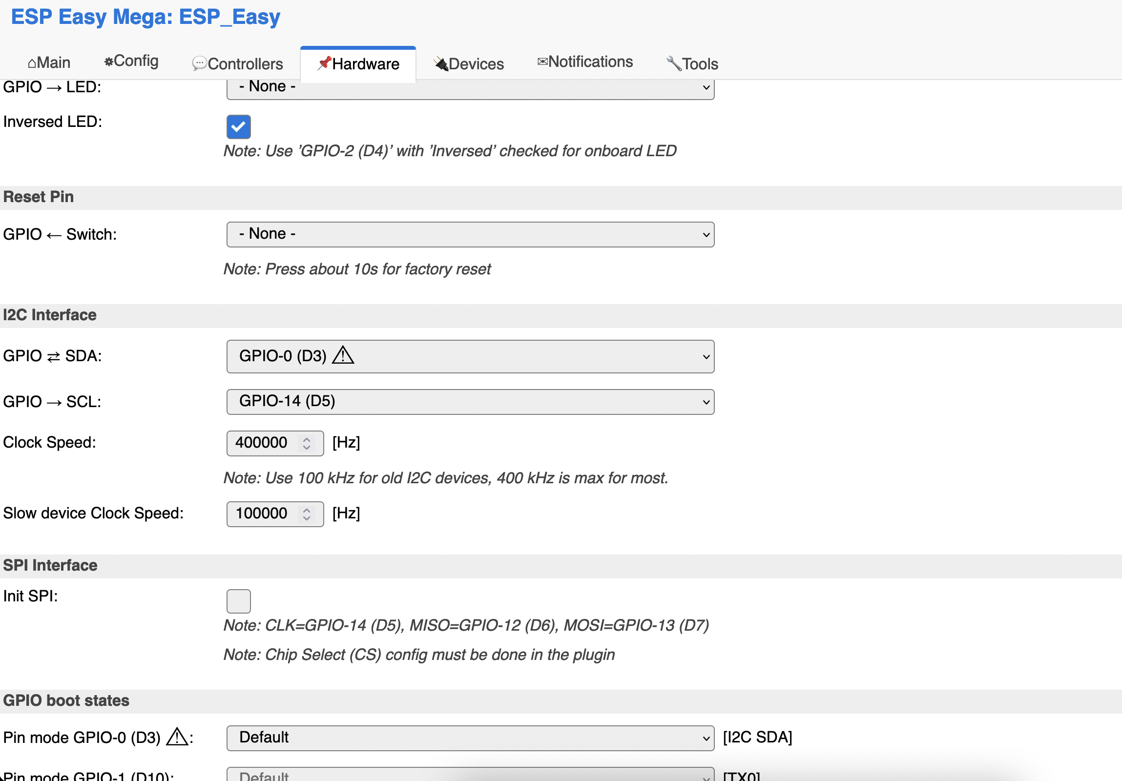

So I tried the above settings with no luck, I'm not sure that I am doing the right thing, thought.
Scanning I2C nothing comes up.
I made a progress,
In Hardware tab, I switched the default I2C Interface pins to:
GPIO ⇄ SDA: D1
GPIO → SCL: D2
Then I scan again for I2C, and it found it.
I created a Device - Display - OLED SSD1306/SH1106 Framed
And it worked!!
I will get back with news.
Thank you everyone for your help.
GPIO ⇄ SDA: D1
GPIO → SCL: D2
And it worked!!

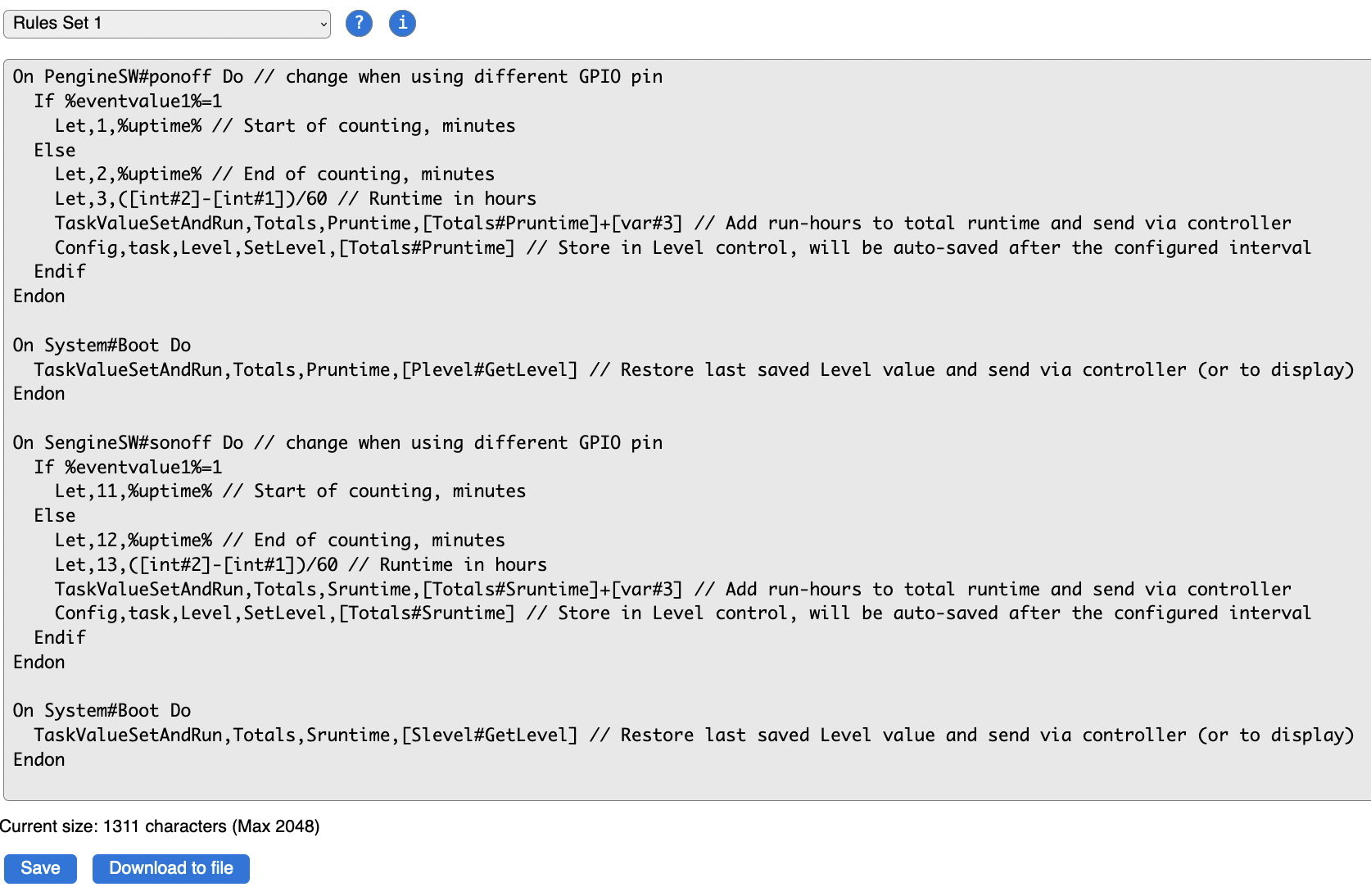

You will have to use a level converter (can be a few resistors to reduce the voltage to 3.3V), as ESP input pins will not handle 5V without damage.
Assumptions:
- A Dummy device is available with name Totals and a value named Runtime
- The input is connected to GPIO 5 (can be changed in the rules)
After adding this code to rules, or changing the GPIO pin, reboot the ESP or run from Tools page this command: event,system#boot
Assumptions:
On System#Boot Do
Monitor,GPIO,5 // change when using different GPIO pin
On GPIO#5 Do // change when using different GPIO pin
If %eventvalue1%=1
Let,1,%uptime% // Start of counting, minutes
Else
Let,2,%uptime% // End of counting, minutes
Let,3,([int#2]-[int#1])/60 // Runtime in hours
TaskValueSetAndRun,Totals,Runtime,[Totals#Runtime]+[var#3] // Add run-hours to total runtime and send via controller
Endif

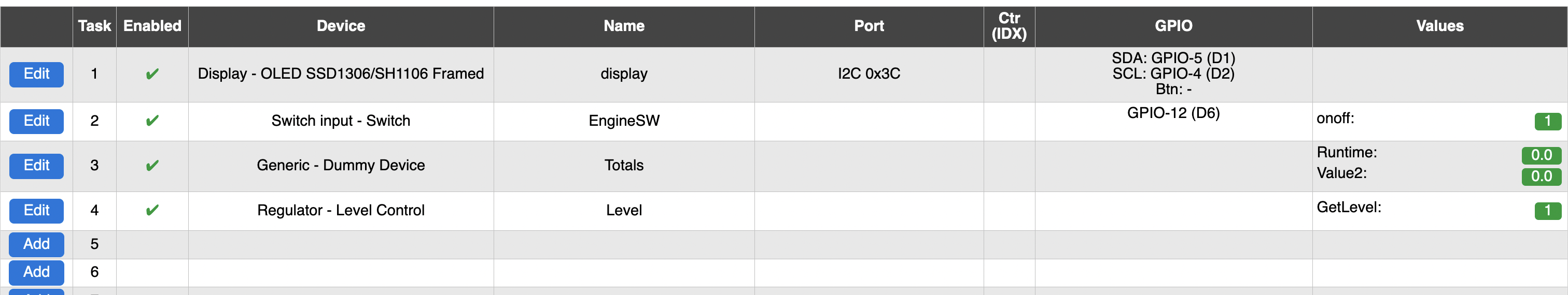

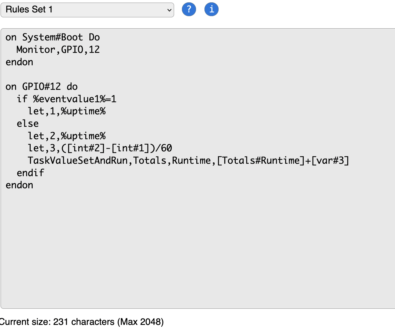

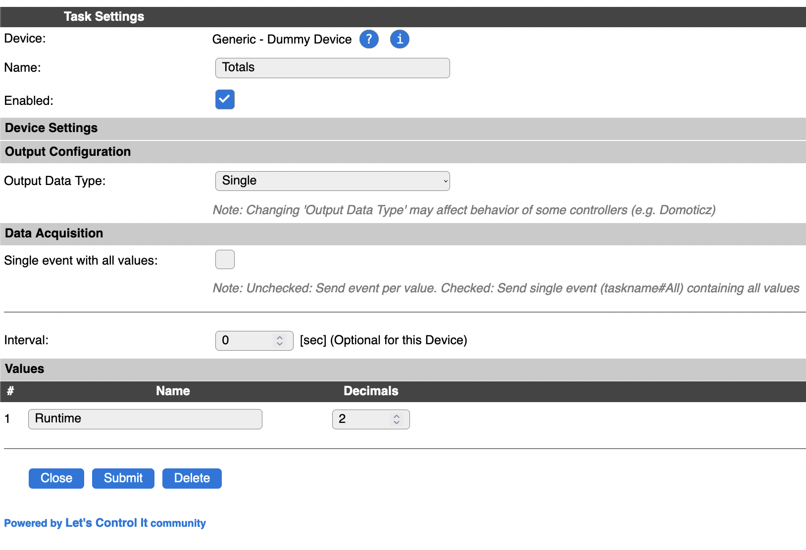

Unfortunately no luck.
When I trigger the GPIO 12 to High (1) and then after some time to Low (0) nothing changes on the Runtime output.
I attach the configuration in case I do something wrong
- Screenshot 2023-03-05 at 10.53.50.png (522.32 KiB) Viewed 8812 times
- Screenshot 2023-03-05 at 10.53.25.png (561.98 KiB) Viewed 8812 times
- Screenshot 2023-03-05 at 10.52.44.png (355.16 KiB) Viewed 8812 times
- Screenshot 2023-03-05 at 10.28.54.png (507.59 KiB) Viewed 8812 times
What build version are you running?
It looks a bit old, as we have the build filename located at the lower right corner for quite a while now. (2 years maybe???)
You could use the Switch input plugin event instead of the monitor command, and checking the GPIO:
Remove the entire "On System#Boot Do" event, and change the "On GPIO#12 Do" to this:
On EngineSW#onoff Do
If %eventvalue1%=1
Else
Endif

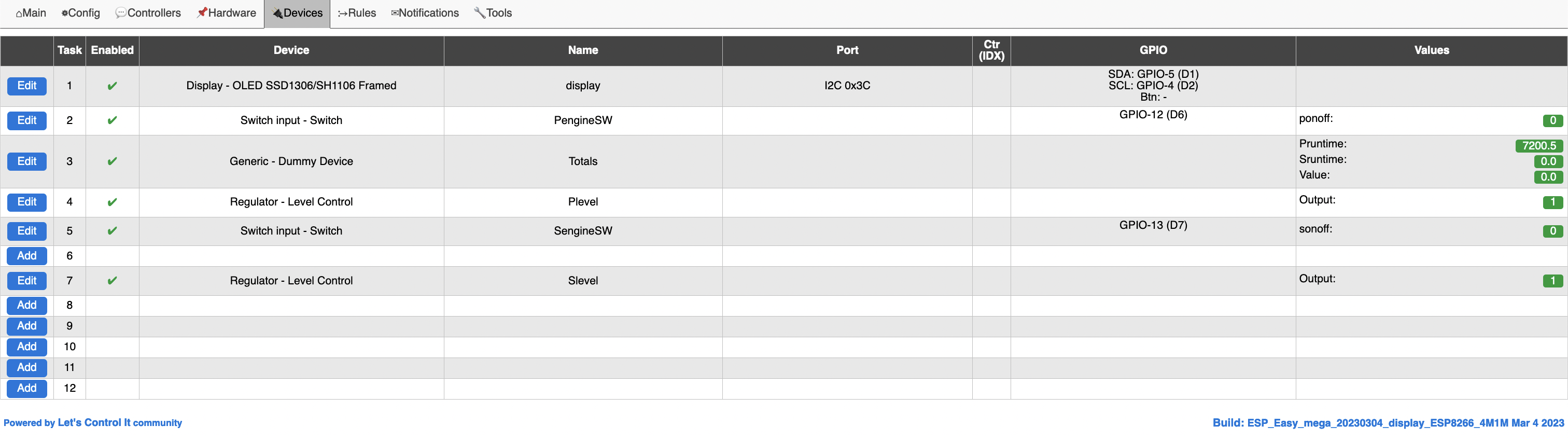

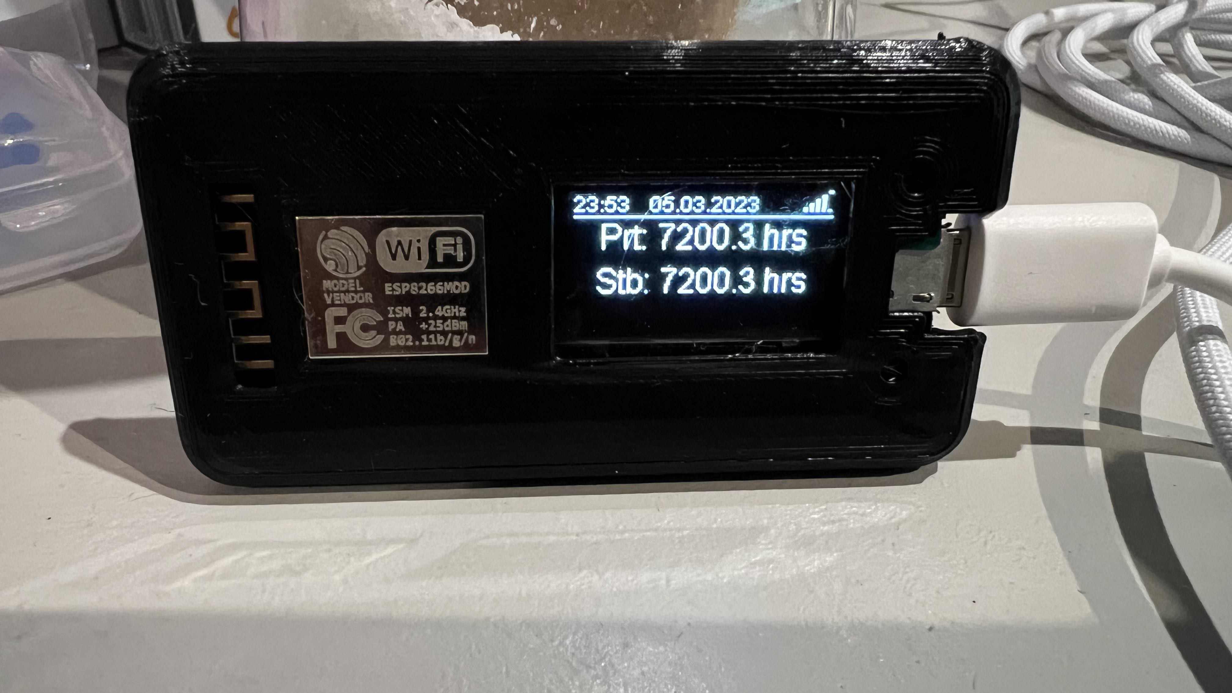

That worked absolutely perfect!!!
Thank you so much!!! It was something I was trying to do for a year or so.
Now I need to add the already working hours in the rule I guess.
- IMG_1408.jpg (470.53 KiB) Viewed 8795 times

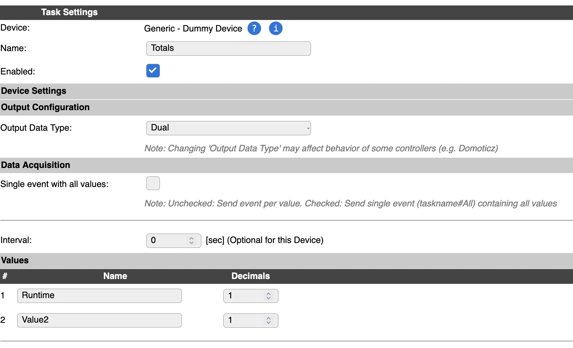

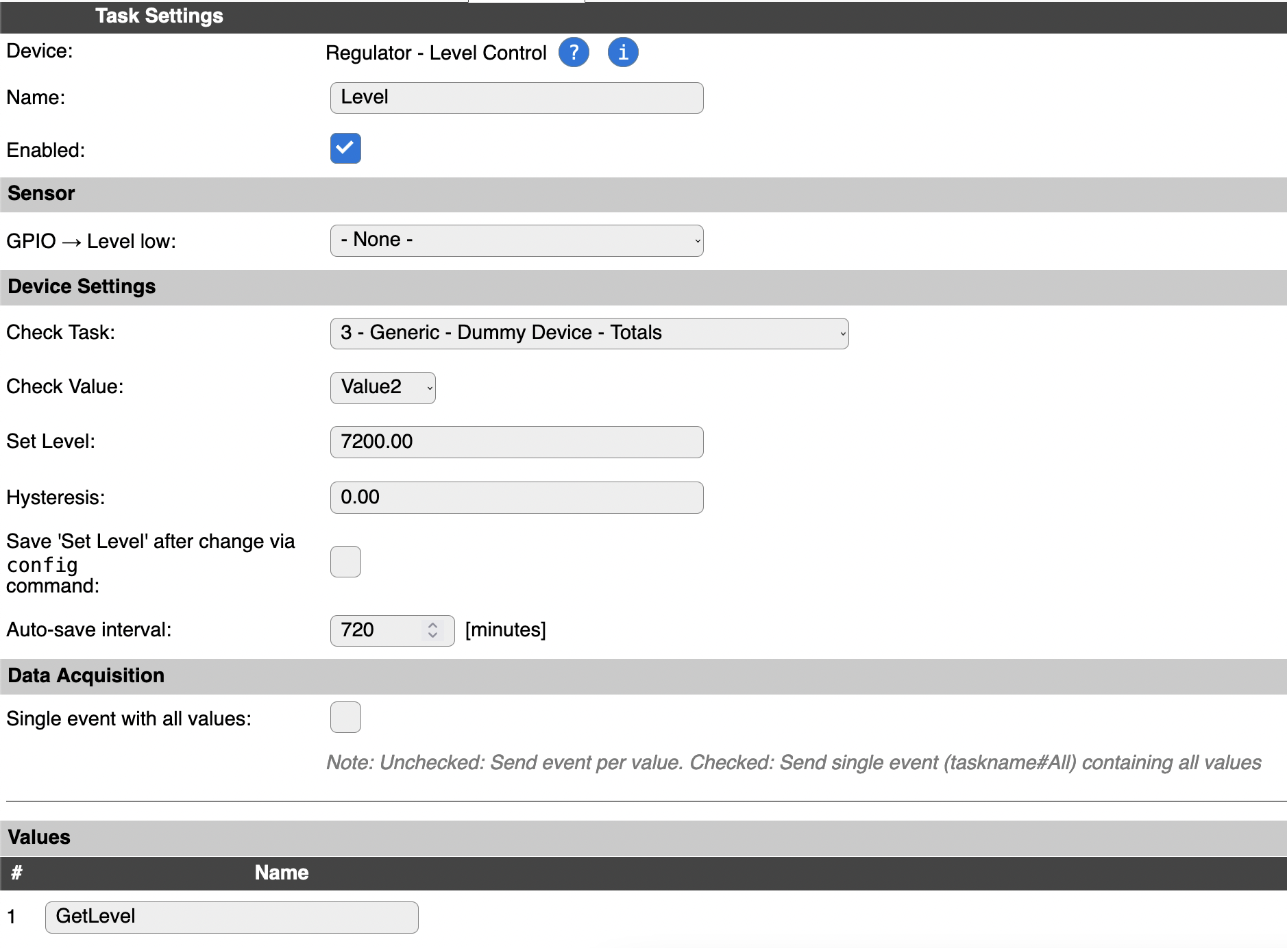

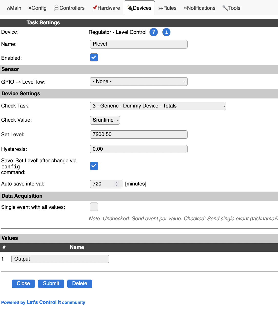

Setting the initial value would be as simple as issuing a TaskValueSet,Totals,Runtime,[value] command from the Tools page, but while that would survive a warm boot of the ESP, it won't be preserved on a cold boot/power cycle of the ESP.
That can be solved by using a Regulator - Level Control task, name that: Level
Don't configure a GPIO on that device, and select a non-changing Task/Value pair (you can set the Dummy Device to Dual, and use the second value for that)
Set the initial Runtime to Set level with your value, and the Auto-save interval to a long time, f.e. 720 minutes (12 hours), to reduce the wear of the flash memory. And assuming the ESP will hardly ever loose power or crash. You can set it to a shorter time if it won't keep running for that amount of time.
Then use these adjusted rules:
On EngineSW#onoff Do // change when using different GPIO pin
If %eventvalue1%=1
Else
Config,task,Level,SetLevel,[Totals#Runtime] // Store in Level control, will be auto-saved after the configured interval
Endif
OMG I totally lost it now again...
I think I've done exactly what you wrote, with no luck...
Also it wont let me change the Set level value, returns to 1 everytime
You should not have changed the Output variable to GetLevel for the Level plugin, that will interfere with the built-in GetLevel special/magic value that will retrieve the current level value. Renaming the Value back to Output should resolve that part.
I think there is no handling of the initial state if the EngineSW is on (1) when the ESP is started, can you check on the Tools/System Variables overview what the current values for Custom Variables %v1%, %v2% and %v3% are? (might be that none is set, but the Custom Variables header will still be shown)
Most likely that will be fixed when the Send Boot state checkbox is enabled.

Would it be too much to double the process for the second engine, you think?
- IMG_1409.jpg (336.28 KiB) Viewed 8763 times
Shouldn't be a problem, just duplicate the Devices with different names and GPIO pin, duplicate the EngineSW rule and use different variables in the rules, I'd probably pick 11, 12 and 13 instead of 1, 2 and 3.
The Dummy Device can be set to Triple or Quad, and the TaskValueSetAndRun commands adjusted accordingly ("On System#Boot Do" should only get another TaskValueSetAndRun line added for the extra Level Control you will need to add.)
Strangling with the second rule regarding the second engine, I do something wrong.
- Screenshot 2023-03-06 at 18.27.56.png (443.9 KiB) Viewed 8707 times
- Screenshot 2023-03-06 at 18.27.34.png (472.54 KiB) Viewed 8707 times
- Screenshot 2023-03-06 at 18.27.22.png (409.51 KiB) Viewed 8707 times
- Screenshot 2023-03-06 at 18.27.10.png (631.61 KiB) Viewed 8707 times
- Screenshot 2023-03-06 at 18.26.44.png (585 KiB) Viewed 8707 times
If next time you could add the script in a Code block in the message (there's a button '</>' in the toolbar above the message edit screen), instead of a screenshot, I could edit it to fix the issues...
There are a few typos in your script:
- The second rule "On System#Boot Do" will never be executed. The line that's in there should be added to the first rule of that name, and the rest of that second rule can be removed
- You calculate var 13 from var 1 and var 2, that should be "Let,13,([int#12]-[int#11])/60"
- The next line, TaskValueSetAndRun, uses [var#3] instead of the desired [var#13]
- The Level Control should both look at the Totals / Value task value, to avoid any unneeded events from the Level Control tasks
Things that didn't need to be changed (but are fine as they are)
- The "onoff" values could both have used that name, as they are in different tasks. It's just that the task names have to be unique, and the value names within a single task too. It is fine as it is now though.
I apologize for that
What if I put the second rule on a Rule set 2?
On PengineSW#ponoff Do // change when using different GPIO pin
If %eventvalue1%=1
Else
TaskValueSetAndRun,Totals,Pruntime,[Totals#Pruntime]+[var#3] // Add run-hours to total runtime and send via controller
Config,task,Level,SetLevel,[Totals#Pruntime] // Store in Level control, will be auto-saved after the configured interval
Endif
On System#Boot Do
TaskValueSetAndRun,Totals,Pruntime,[Plevel#GetLevel] // Restore last saved Level value and send via controller (or to display)
On SengineSW#sonoff Do // change when using different GPIO pin
If %eventvalue1%=1
Let,11,%uptime% // Start of counting, minutes
Else
Let,12,%uptime% // End of counting, minutes
Let,13,([int#12]-[int#11])/60 // Runtime in hours
TaskValueSetAndRun,Totals,Sruntime,[Totals#Sruntime]+[var#13] // Add run-hours to total runtime and send via controller
Config,task,Level,SetLevel,[Totals#Sruntime] // Store in Level control, will be auto-saved after the configured interval
Endif
On System#Boot Do
TaskValueSetAndRun,Totals,Sruntime,[Slevel#GetLevel] // Restore last saved Level value and send via controller (or to display)
If %eventvalue1%=1
Else
Endif
If %eventvalue1%=1
Else
Endif
On System#Boot Do
- Combine the "On System#Boot Do" in 1, and move to the end of the file
- Fix the typos in the int/var names
Please test
Both counters seem to work perfect, except that is not keeping the added hours after the power cycle anymore.
Although I have 720 minutes Auto-save interval.
- Screenshot 2023-03-06 at 20.26.36.png (84.81 KiB) Viewed 8661 times
It will take up to 12 hours (720 minutes) before that setting is saved, you might want to set it to a shorter time, but it should be relatively long, to avoid unwanted wear of the flash memory, eventually causing the ESP to fail, either by save errors or read errors. It will only be saved if the value has changed.
And that checkbox should be unchecked, it will inhibit the time-out value! And do a save immediately after the value is set via the Config command, as it states.
Thank you so much.
It is working great!
