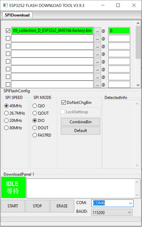

For ESP32 you should actually be using the Espressif flasher, and best to get the latest from the Espressif site, that prevents a lot of issues. I think we should make it a bit more clear that for ESP32 the Espressif tool should be used for best results.
Edit: This should work for your board
On the next screen just enable the first checkbox, select a filename (with ESP32s2 and .factory.bin) and after the @ fill: 0x0 (or probably even just a 0 should suffice)

Re: ESP32S2 - AI Thinker
Using the Espressif flasher worked
Using 0 was ok.
