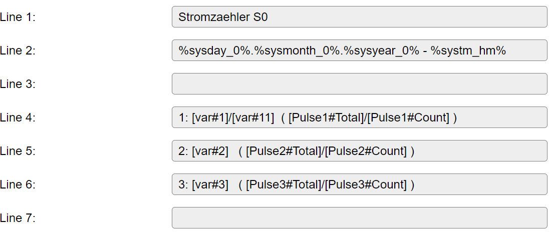

I show the variable on the display as follows
Screenshot 2022-10-30 111327.png (53.22 KiB) Viewed 3954 times
Var#11 is displayed correctly as 100 and all others are still displayed as 0
Any further ideas?
