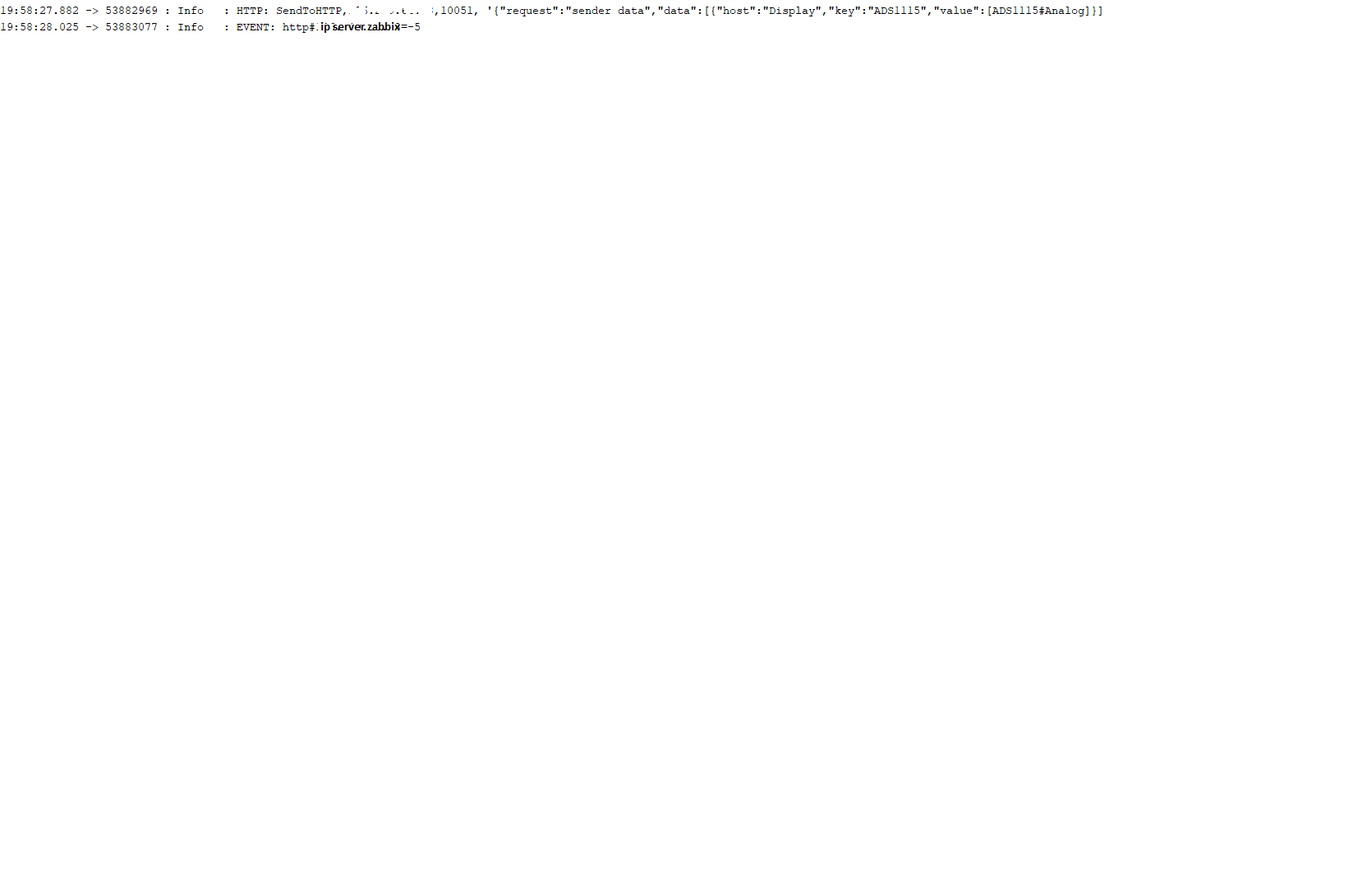

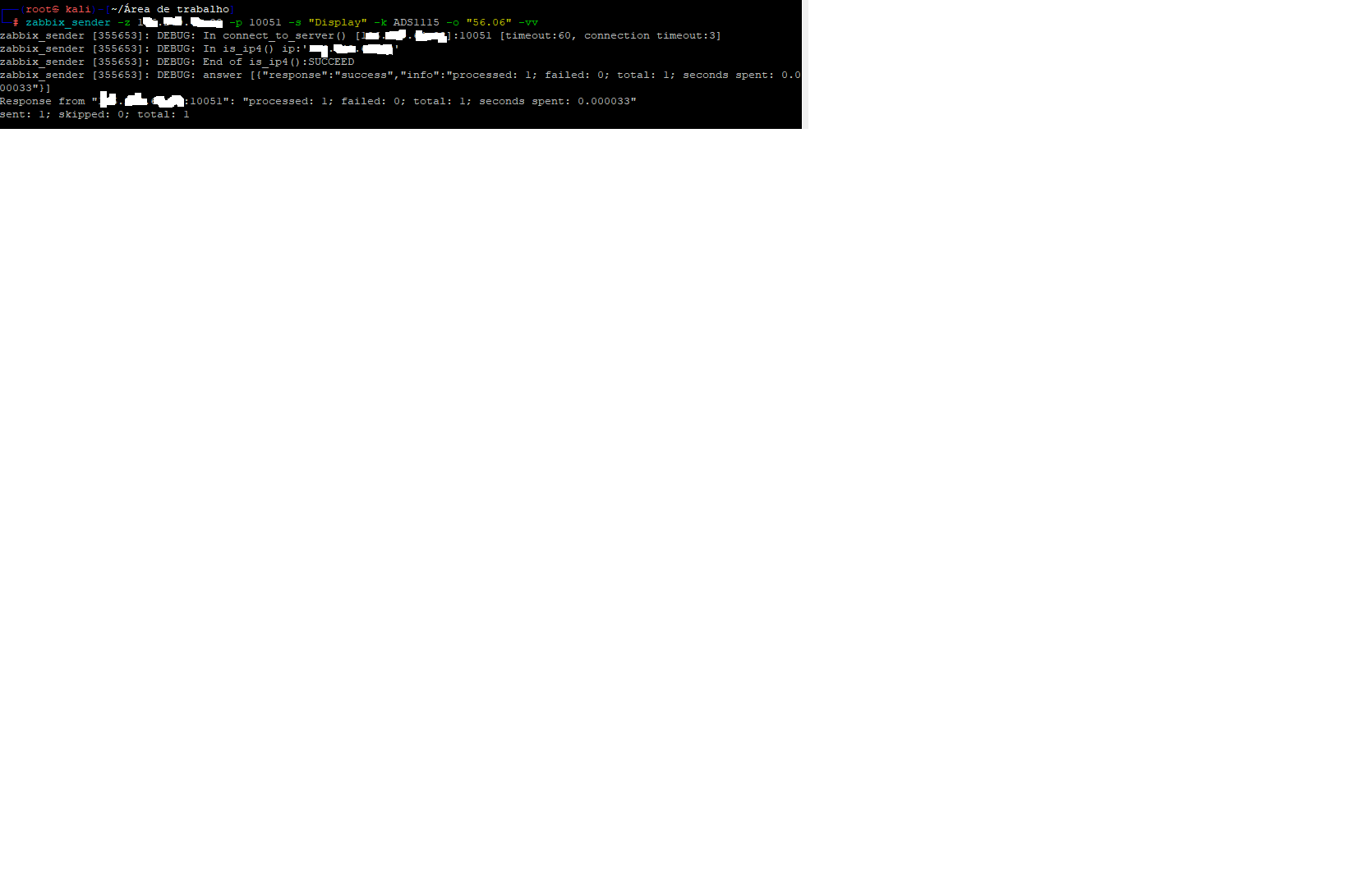

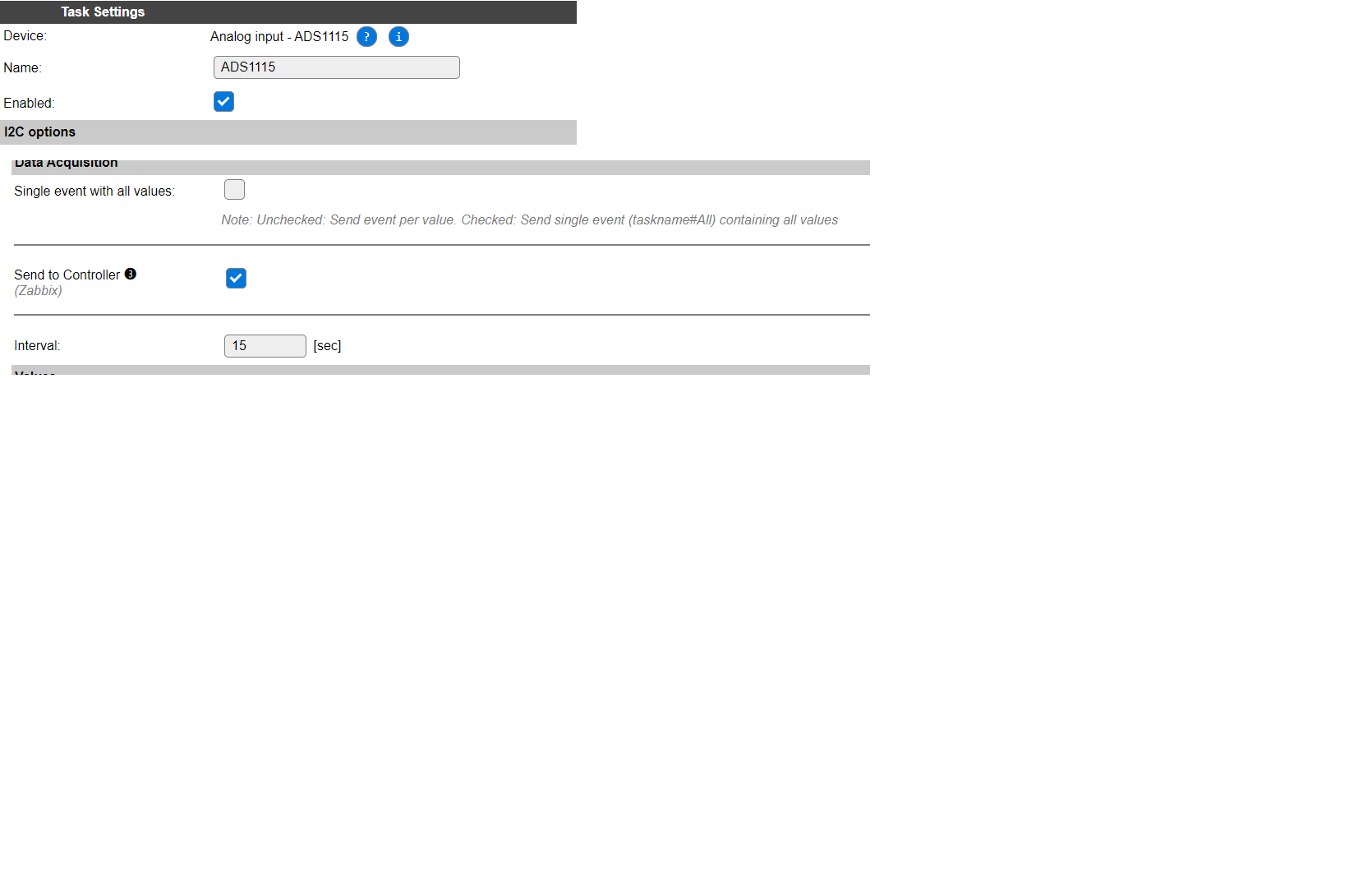

I have a customized compilation of ESPEasy where I use the zabbix controller, it is configured with the IP and port of the Zabbix Server according to this information:
USAGE: at Zabbix server you go to Configuration -> Hosts -> Create host
The "Host name" should match exactly the EspEasy name (Config -> Unit Name)
I used the name Digital
Add a group (mandatory) and hit add.
I used the default group
No need to set up IP address or agent.
OK
Go to the newly created host ->Items ->Create Item
Name the item something descriptive
OK
For Key add the EspEasy task Value name (case sensitive)
ADS1115
ype of information select "Numeric (float)" and press add.
OK
Aslo make sure that you enable send to controller (under Data Acquisition in tasks)
OK
and set an interval because you need to actively send the data to Zabbix
OK
Questions:
With Zabix_Sender it works normally, not characterizing a network or firewall problem, what could I be doing wrong?
Problems with the Zabbix plugin?
OK
OK
ADS1115
OK
OK
OK
Questions:

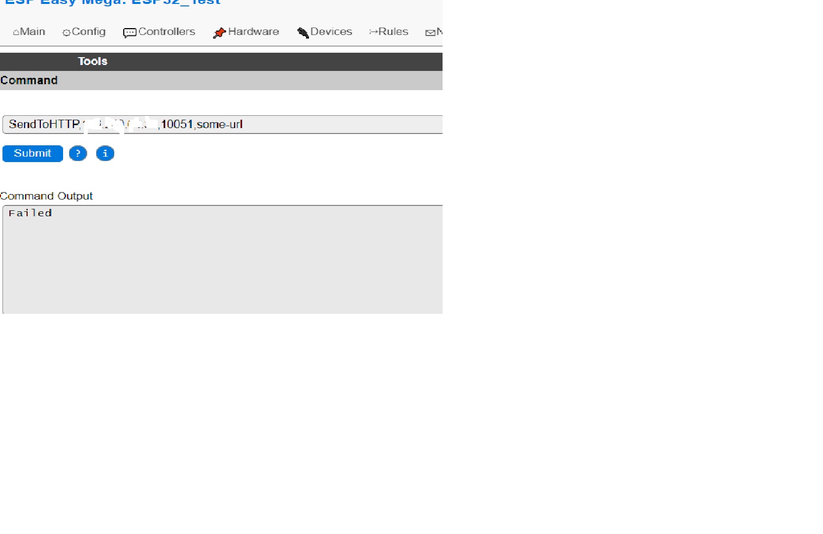

Re: ESP32 Zabbix Controller
Does your Zabbix server accept HTTP connections on that port? As ESPEasy doesn't support HTTPS (yet).
And the ADS1115 reporting a value of -32768, most likely isn't correct either, is it actually connected and working?

ADS115 is not working, but regardless, zabbix intem is in "float", note that with zabbix-sender this value is accepted by zabbix server. I suspect the plugin is not working for some reason.

Failed Command
Would it be possible to indicate which command to list the IP, DNS and Gateway through Espeasy?
- Evidencias SendToHTTP.jpg (80.13 KiB) Viewed 66496 times

TON, this is the Zabbix Server response to the command sent by ESPeasy:pp1wvc wrote: ↑09 Jan 2023, 11:51Excuse my ignorance, but I don't know the meaning of <some-url>:Ath wrote: ↑09 Jan 2023, 10:11 It seems the ESPEasy unit is not allowed to connect to the Zabbix server. The fact it works from your computer isn't relevant, as that's not from the ESP. Can you try to use the SendToHTTP command to connect to the Zabbix server:You can enter this on the Tools page of ESPEasy, to validate that the ESP can actually reach the serverCode: Select all
SendToHTTP,<zabbix-ip>,10051,<some-url>
What does it mean?
- evidencia send test value.jpg (67.35 KiB) Viewed 66432 times
- evidencias repostas zabbix server.jpg (76.54 KiB) Viewed 66432 times

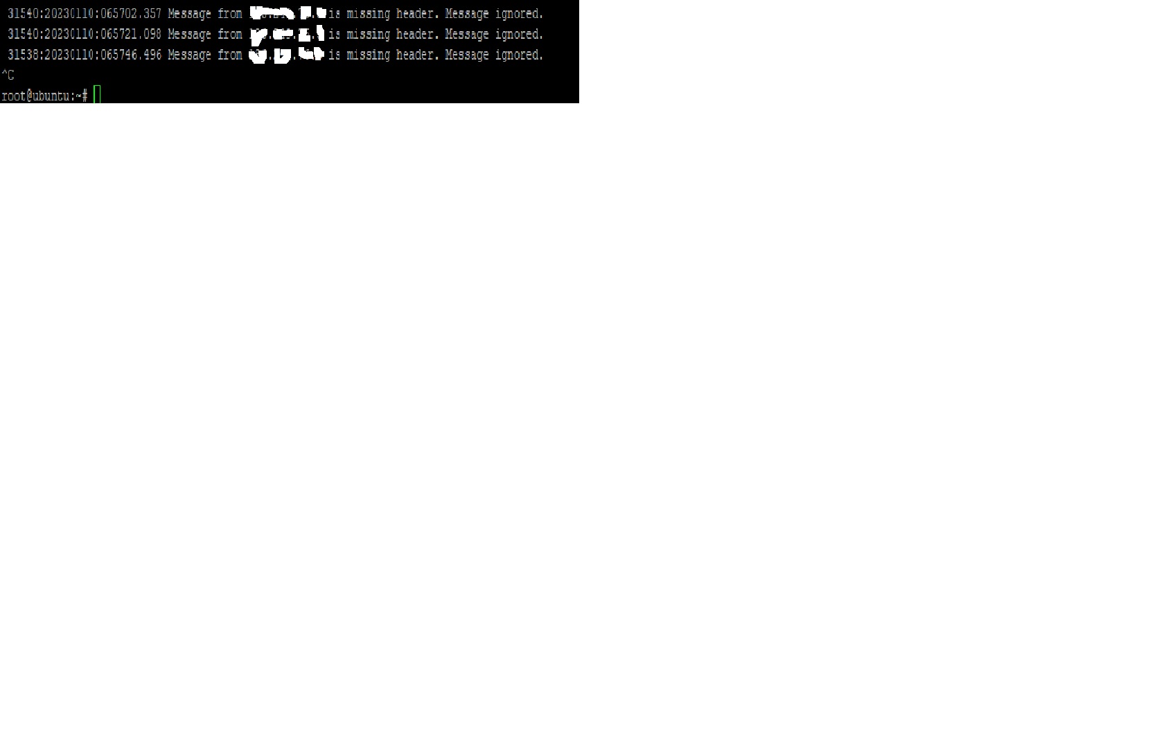

TON, unsuccessfulAth wrote: ↑10 Jan 2023, 11:31 I think it is expecting a JSON message, you can have a hand-crafted one, on one line:(This seems to be the absolute minimum, if I'm reading the controller source correctly...)Code: Select all
SendToHTTP,<zabbix-ip>,10051,'{"data":["host":"EspEasy","key":"ADS1115","value":[ADS1115#Analog]]}'
(Instead of [ADS1115#Analog] you could also include a fixed numeric value)
- testHTPSend01.png (23.94 KiB) Viewed 66376 times
- logEspasy.png (13.67 KiB) Viewed 66376 times
- logZabbixServer.png (22.24 KiB) Viewed 66376 times

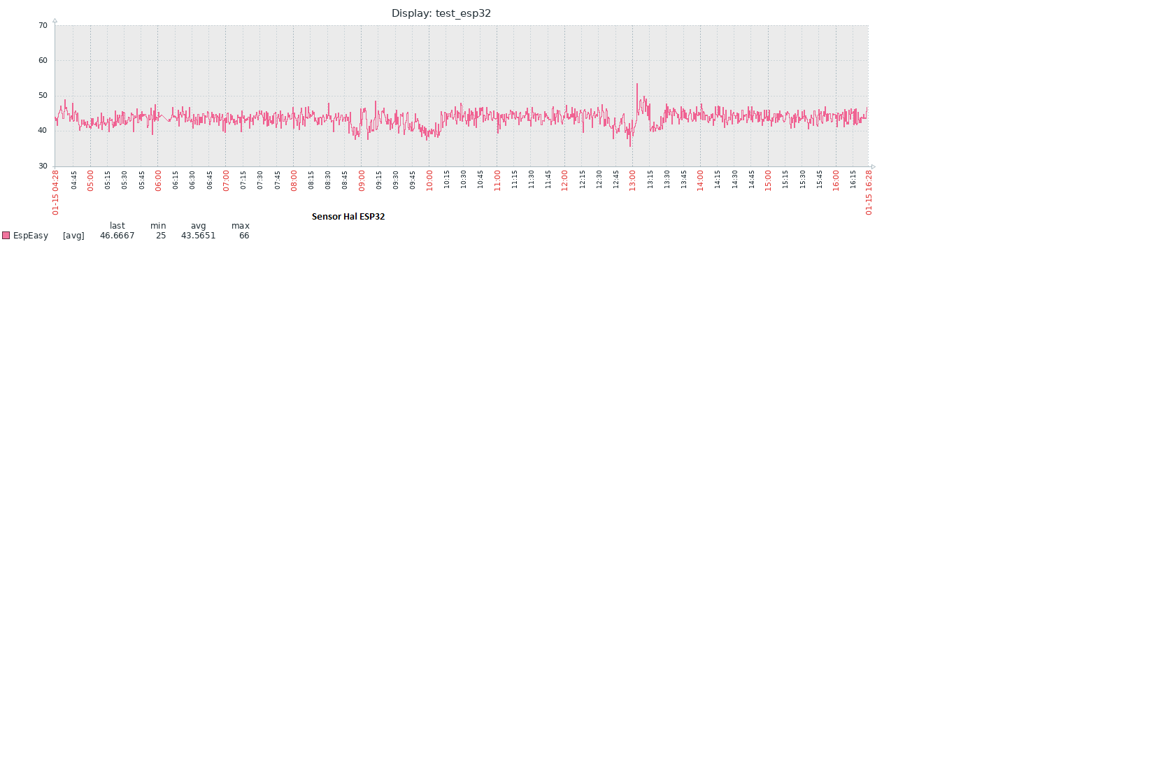

- ZabbixSenderOK.png (36.78 KiB) Viewed 66271 times

My nodes do not send anything actively to Zabbix. Zabbix is calling the /json page of the node (eg. http://node.my.domain/json) and then parse and evaluate the JSON information received (whatever is in there). This should work with any ESPEasy version that has JSON compiled in.
Zabbix expects information in this format;
Json += "{\"host\":\"" + zItemHost + "\",\"key\":\"" + zabbixItemList.key + "\",\"value\":\" " + zabbixItemList.val + "\"}";
I'm studying to understand the conversion because espeasy is being updated natively to this format, correct?
The Zabbix Controller used by espeasy is not sending in this format, so it doesn't work.

My problem boils down to the zabbix controller not working. Being very objective, my problem can be summarized in these few lines:
WiFiClient client;
if (!try_connect_host(controller_number, client, ControllerSettings, F("ZBX : ")))
return false;
It tries to create a TCP connection through WiFiClient which does not work in the latest versions of zabbix.
I suggest that you remove this controller in the next versions, as it is not working, unless you really have a solution.
The solution I'm looking for is to create a new controller based on a .ino file that is tested and working and convert it to the controller format.
There is no controller example in espeasy, only a plugin example, it could help me a lot, guiding which example targets would best suit my research within the structure of Espeasy.

you don't understand, the zabbix controller is not broken. The new versions of Zabbix do not accept this type of work, I have already tested it in other ways and it did not work.
This example works in zabbix 4.2, but is no longer supported in the latest versions:

OK, so there is a new way to interact with Zabbix.
This might indeed warrant a new controller, or if the protocol isn't that different, a checkbox in the controller settings for Zabbix to set the right protocol.
But this doesn't mean all existing Zabbix environments out there will immediately be phased out, so if the Zabbix controller in ESPEasy is still working with older versions, we should not remove the (current) Zabbix controller from ESPEasy.
Or am I still missing the point here?
