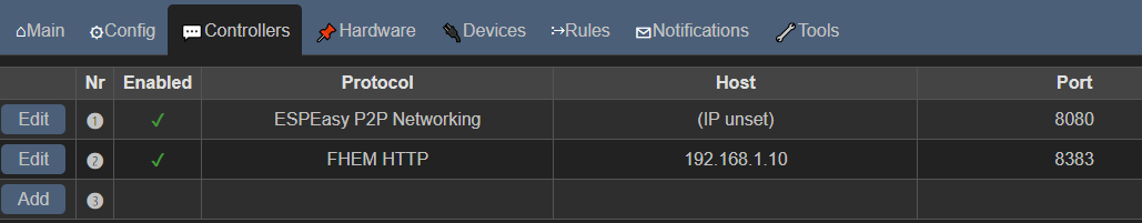

Re: New (old) project...
#39 Post by TD-er » 29 Dec 2022, 14:15
The shown port on the Controller tab for the p2p controller is wrong.
So that's for sure a (cosmetic) bug that needs to be fixed.
But to be honest, I have no clue why other nodes cannot see your "garage" node.

#41 Post by M*I*B » 29 Dec 2022, 14:27
Yes, have seen that but also don't care of it as you suggested ...
