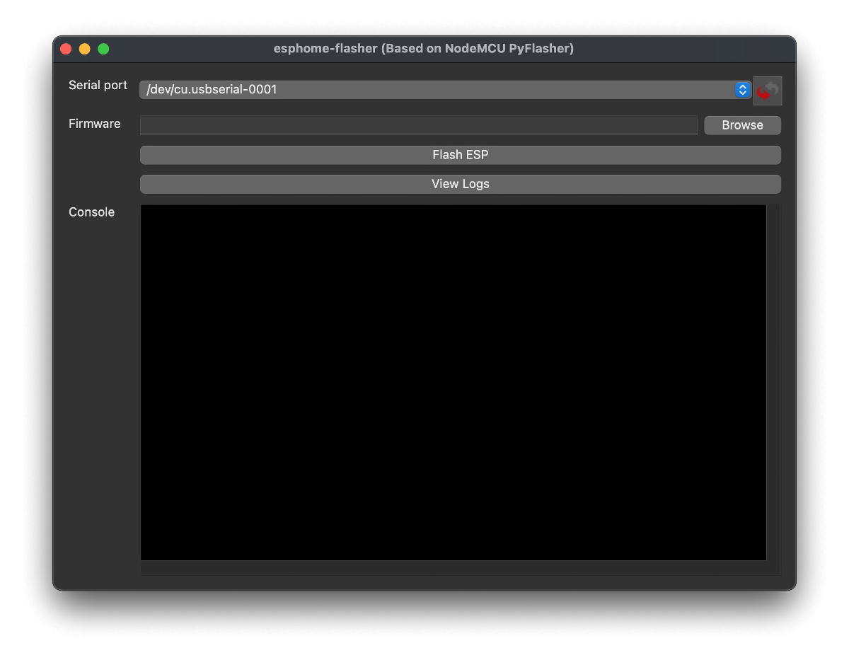

I've tried installing "ESP_Easy_mega_20221224_normal_ESP32_4M316k" on 2 different WROOM ESP32's (non S2) and both flash correctly, but give FS errors and hang.
Can someone give some advice please?

#2 Post by Ath » 31 Dec 2022, 16:36
When using an external flash tool (not via OTA Firmware Update) for the initial upload, you need to flash the .factory.bin file. That includes the partition table, including the FS partition (and other required partitions), so ESPEasy can format the FS as it will be uninitialized.
After configuring the device you can install (future) updates via the Firmware Update button on the Tools page, and then use the 'regular' .bin (without .factory in the name). It will keep the configuration intact, as long as you keep using the same flash layout (4M316k).

#3 Post by TD-er » 01 Jan 2023, 01:58
 - Chip Family: ESP32
 - Chip Model: ESP32-D0WDQ6 (revision 0)
 - Number of Cores: 2
 - Max CPU Frequency: 80MHz
 - Has Bluetooth: YES
 - Has Embedded Flash: NO
 - Has Factory-Calibrated ADC: NO
 - MAC Address: 24:0A:C4:81:AC:40
This part is a bit strange...
Why would it only detect this as max. CPU freq. of 80 MHz?
And also what flash tool is used here?
I don't recognize this info formatting.
Does this tool support some option to "not change bin"?
I think it may have detected the wrong flash parameters and thus set/changed some flags in the binary while flashing.
Some tools can detect flash size/speed and mode and toggle those bits in the binary when flashing it to the ESP.

Ath wrote: 31 Dec 2022, 16:36 When using an external flash tool (not via OTA Firmware Update) for the initial upload, you need to flash the .factory.bin file. That includes the partition table, including the FS partition (and other required partitions), so ESPEasy can format the FS as it will be uninitialized.
Thanks, is there page somewhere that explains the ESP32 flashing, I did have a look.
I've just tried flashing with the .factory.bin file. but I get a magic byte error?

Unexpected error: The firmware binary is invalid (magic byte=FF, should be E9)
Re: ESP32 FS Errors Hanging
#5 Post by Ath » 02 Jan 2023, 10:11
The .factory.bin file has to be flashed at address 0x0 (zero), can't see what you are using now, but when, by accident, I select the .factory.bin file for flashing via OTA I get the same error message. Most likely you are trying to flash at (default) 0x10000, and that's probably also why you also got these FS errors earlier.
It's the ESPHome-Flasher on MacOS, could you recommend another, I could also do it on a PC?
No it's quite basic.

#8 Post by Ian » 02 Jan 2023, 10:17
Thanks again, Best I use the Espressive tool on a PC then
