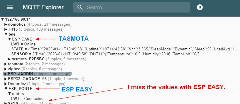

I have some ESP who communicate with a brocker.

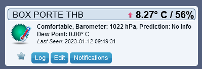

With Domodicz I get the Temp + Humidity + Baro With the help of Windows APP MQTT-Explorer I don't see those values! I have one ESP with TASMOTA and here every thing work well.
Do I have to add a command in the rules to get this?

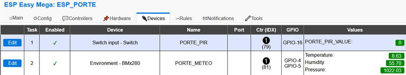

And besides the Controller configuration, what sensor is connected and how is it configured??

- Yes the Domoticz MQTT Protokol is Enabled. I see the value in Domoticz.
- Yes the Controller Subscribe: Domoticz/in and Controller Publish: Domoticz/out ist ok.
I think that if I had made a mistake, I wouldn't see the values in Domoticz! I also tried to add the folling lignes in the Rules:
On Rules#Timer=1 do //When Timer1 expires, do
Publish %sysname%/[PORTE_METEO#Temperature]
timerSet,1,1
But also here I don't see any thing with the help of MQTT Explorer!
The ESP LOG show : 316575: ACT : Publish ESP_PORTE/8.75
My Devices: What I am looking for is to have the following answer in the MQTT explorer (sample sent from TASMOTA):
timerSet,1,1

Sorry I forgot to telle you that I have the following code on the top of my Rules:
What I don't understand with ESPEasy is why I don't see any communication if I use an MQTT Viewer on my Brocker.
I see only for every ESP : status/LWT Connectet.
on System#Boot do
timerSet,1,3
