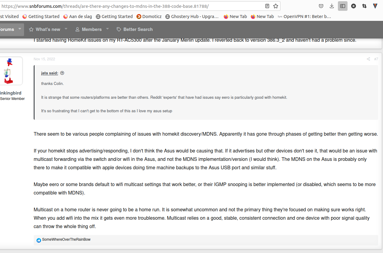

Td,
I don't use p2p in my setup in Espeasy. Only serial,systeminfo and ping device and MQTT controller active to check the connection.
Attached is part of a discussion on snbforum about multicast and IGMP-snooping in connection to ASUS routers. Hence the switching off of IGMP.....
Hope you can make some sense of it. But in the mean time its working oke and I don't have ITV or streaming. My wife has Apple hardware, but that seems to work okay with viewing Netflix etc...
Regards,
Rini
