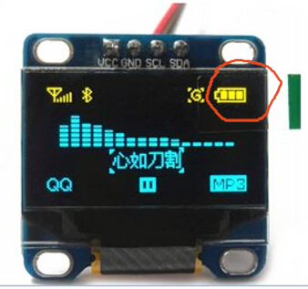

Since we sometimes use power on 3.7V batteries for Wemos D1 Mini it would be very useful to be able to display the status of
the battery voltage whether in the form of a value such as 3.4V or an icon in the header as shown on the example OLEDs
Maybe it would be useful to introduce, similar to the system variables, a second type of user variables of the type
UserVar1, UserV2
Or is it possible to display the battery status in the OLED header and I don't know how to do it ?

Re: OLED SDD1306 own info in header
Battery level isn't regularly available as a variable, as only the (ESP8266) VCC builds can use the analog GPIO pin to measure the voltage, but usually that's just the regulated VCC of ~3.3V to the CPU, not a battery input. To get a real measurement you would have to use another analog input sensor like an ADS1115 or similar.
It would be nice to have a symbol like a battery gauge to show that level, but it is a rather rough indicator, though that may be good enough. Not sure how much effort, and code, that would take. I'll try to implement your initial idea first, but no ETA yet.

Thank you for your reply
I use Wemos D1 Mini with Battery shield where I can connect + Battery via 100 kOm resistor to A0 and I read on forum that I can get battery level with use firmware "*_normal_*" where I need add "Analog input - internal". So I suppose I can get level voltage of battery 18650, and I can try display value or percentage in header if it will exist possible display UserVar variables on which I wrote in my first post.
So if you manage to add such functionality to set UserVar1, UservVar2 etc, which could be displayed in the OLED header, it gives great opportunities to display your own data, for example, the value of 18650 battery level (not as graphic bar but as value" for exmaple BL:45% or BL:3.6V) or the IP address of a remote device. Having "header" and "header alternative" options, it will be possible to display two different types of custom data
