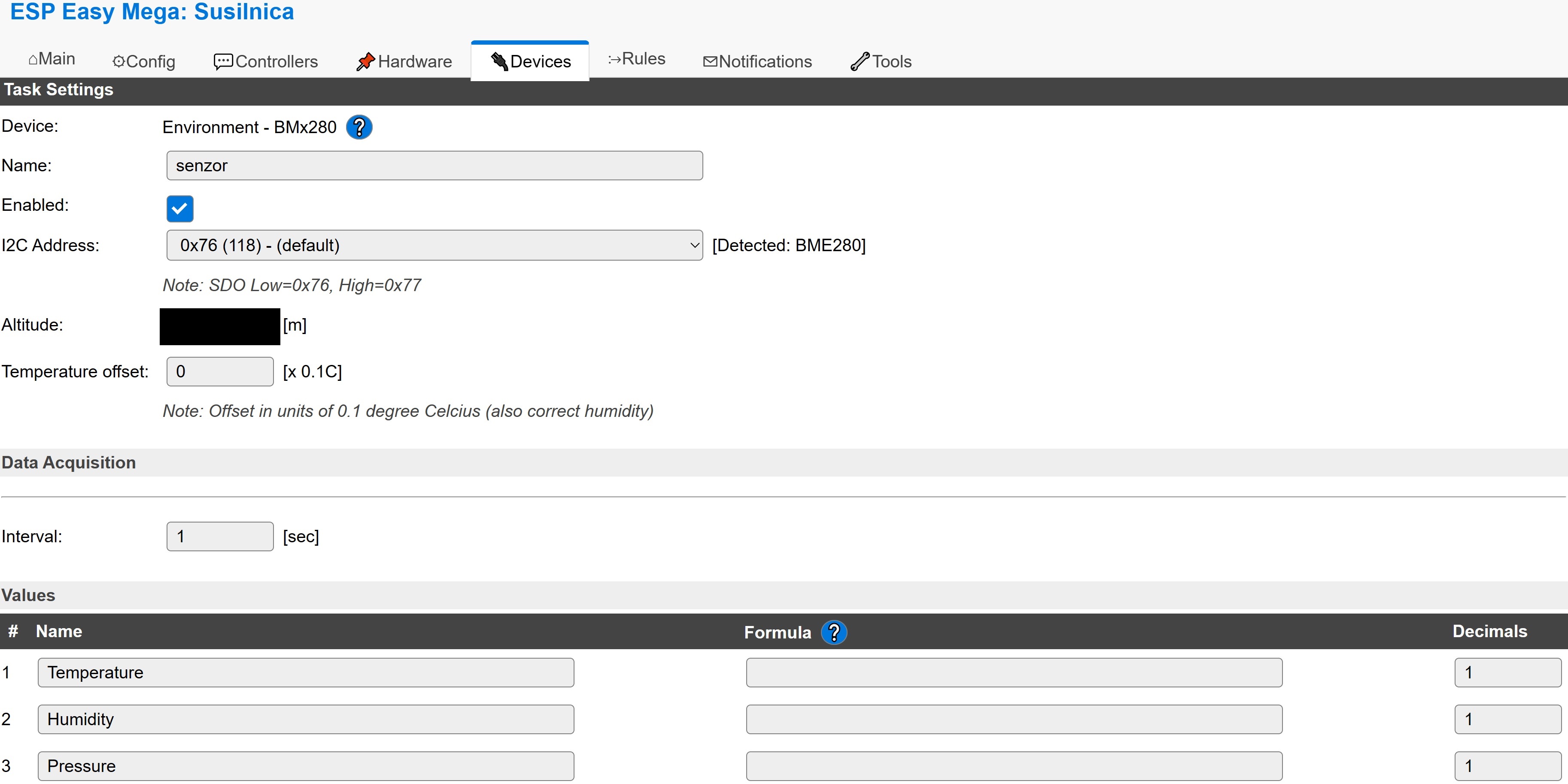

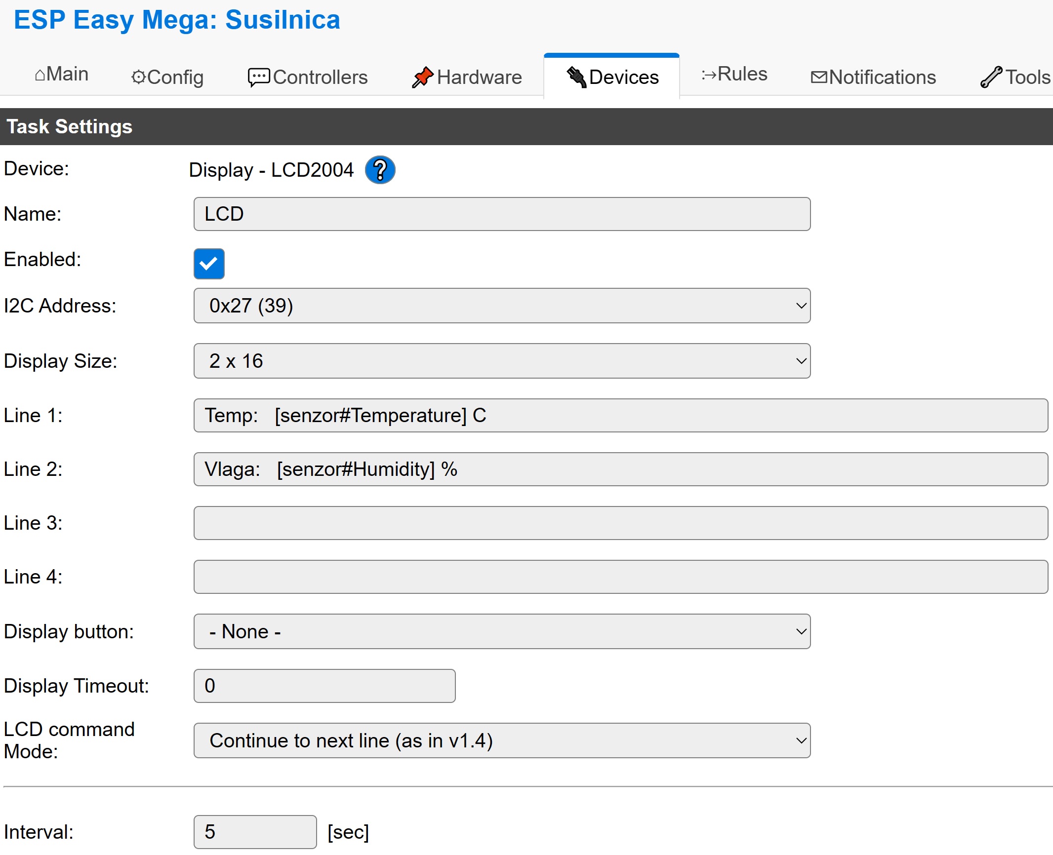

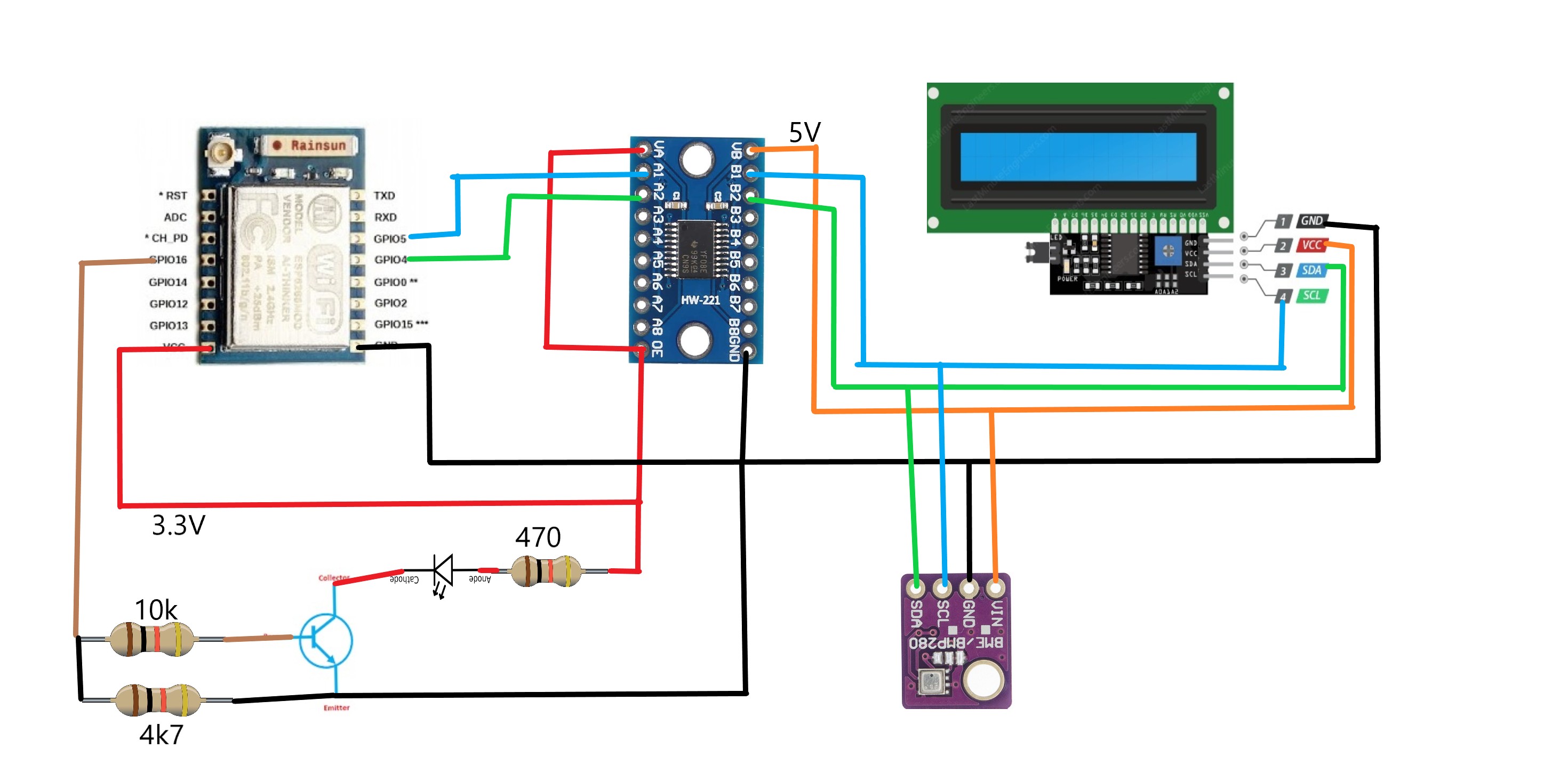

Hello everyone,
i`m newbie with esp modules.
I made some "projects" such as temperature readings on cental heating and light switching from node red and mqtt.
My new project is to make temeprature room reading.
I use esp 07, lcd 16x2 i2c, logic converter txs0108e, bme 280 (5V)...
Uploded version of espeasy is: espeasy mega 20181023 dev.

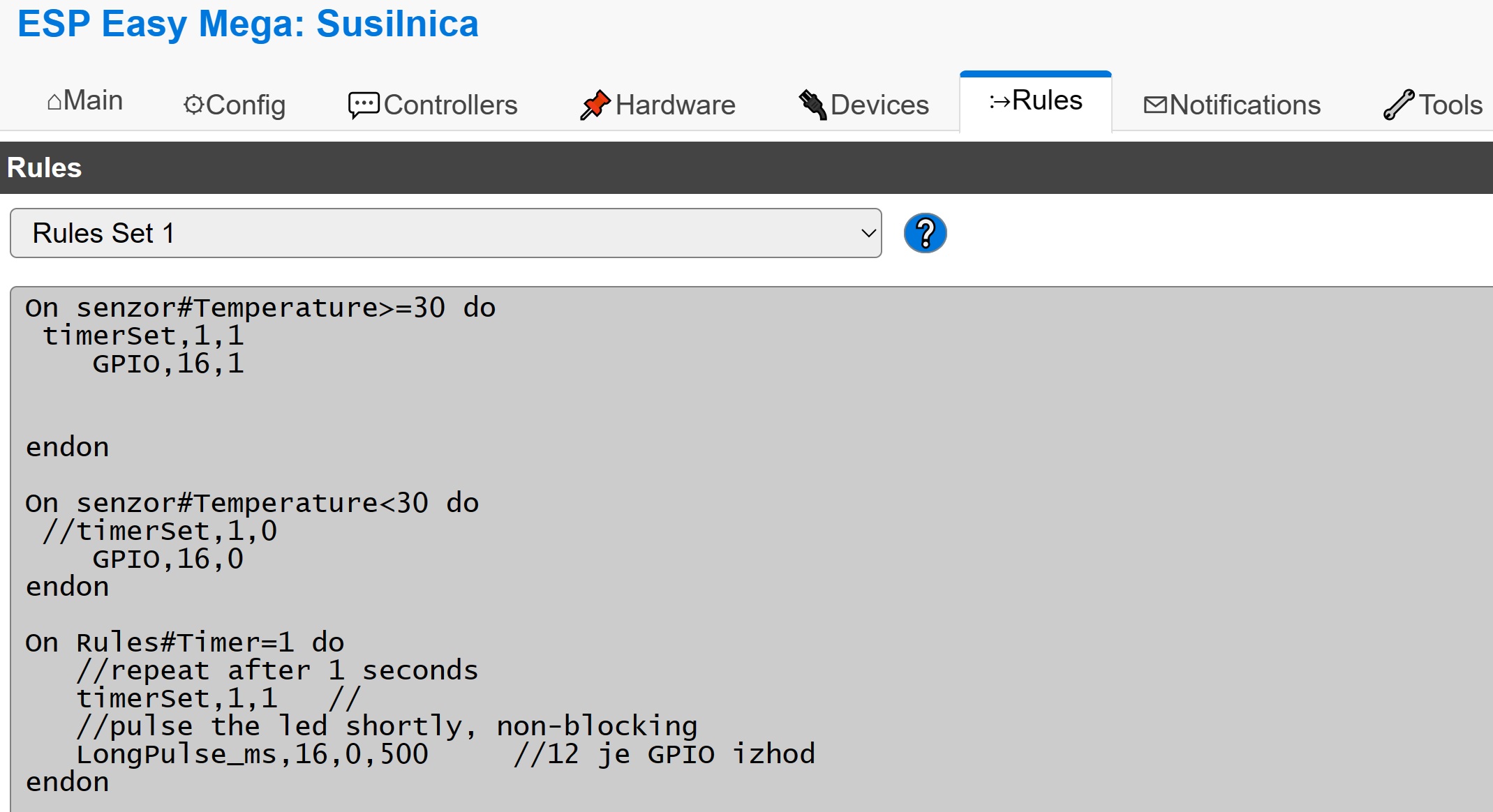

My problem is in want to make alarm if room temperature is exceed 30 degree.
When set temperature is exceeded alarm works but when temerature is below led bliks every 1s.
For better understanding i attached pictures below.
Thanks for your help.
Sam
Posts: 9895
Re: Rule for led blink
#2 Post by TD-er » 27 Aug 2023, 11:34
I think you can simplify it a bit like this:
on senzor#Temperature do
  if %eventvalue1% < 30
    GPIO,16,0
    if [int#1] = 0
      // Variable #1 is set to 0, so we need to start the longpulse continously
      let,1,1 // set variable #1 to 1
      longpulse_ms,16,1,500,500,-1 // Continous blinking at 1 Hz (50% dutycycle)
    GPIO,16,1
    let,1,0 // set variable #1 to 0
See the parameters of longpulse: https://espeasy.readthedocs.io/en/lates ... ernal-gpio

#5 Post by qwerty_21 » 29 Aug 2023, 10:08
Hello everyone,
i think i solve a problem. I upgrade on latest version of espeasy and import rule i attached and it works now.
Thanks for help.
Sam
