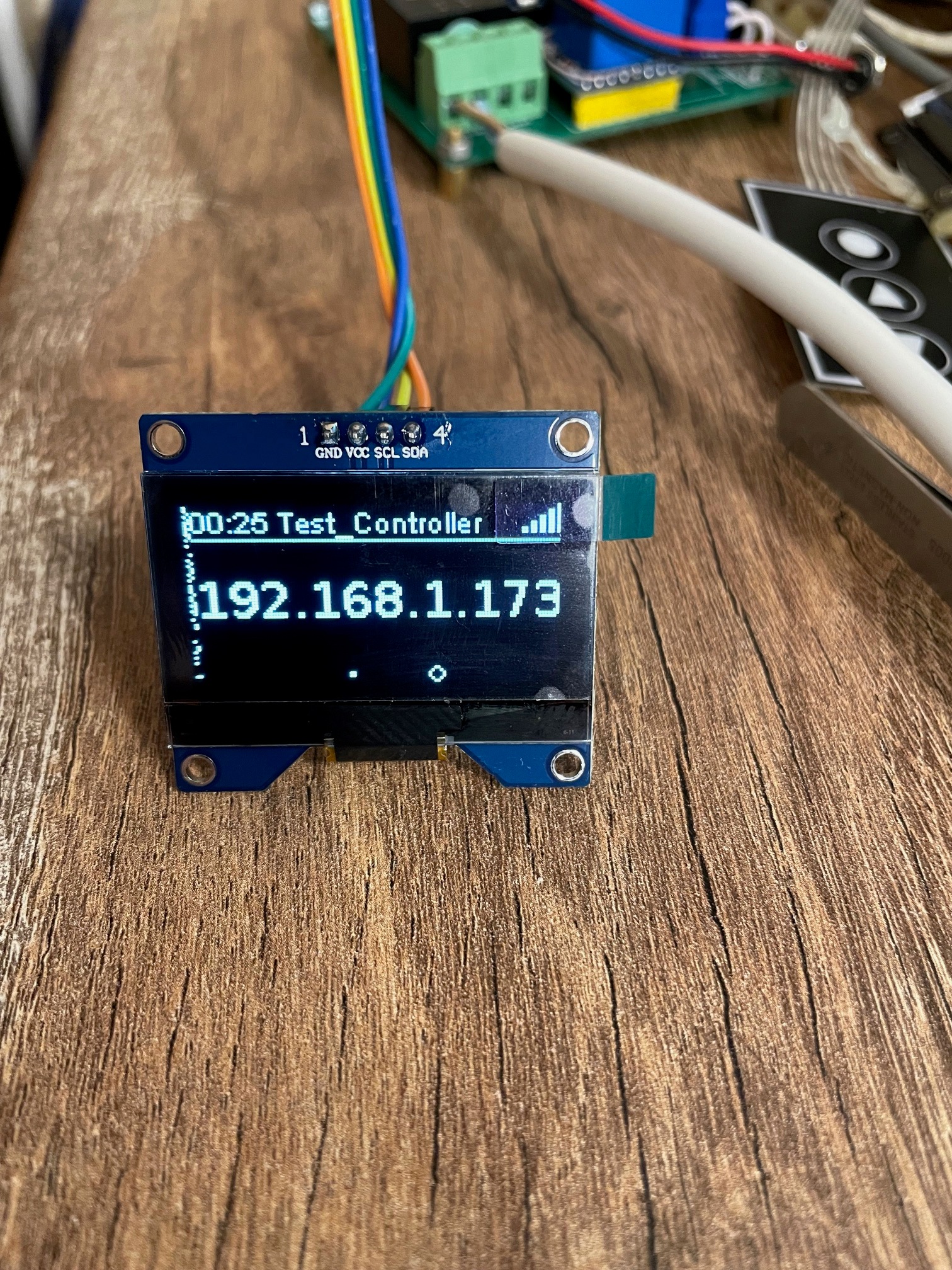

Good afternoon. Are there plans to support I2C display with the SH1116 controller?
If you connect it like SH1106, it looks like in the photo.

#2 Post by Ath » 09 Dec 2023, 23:22
Do you have any documentation on that controller (and display)? It is either very new or very rare...

#3 Post by Pencraft » 10 Dec 2023, 07:53
There is a datasheet.
I bought it on aliexpress.
Probably new, never seen anything like it before.
I2C connection.

#4 Post by Ath » 10 Dec 2023, 13:52
Pencraft wrote: 10 Dec 2023, 07:53 There is a datasheet.
I2C connection.
https://aliexpress.ru/item/400105153583 ... 6725051994
https://cdn.velleman.eu/downloads/29/in ... asheet.pdf
Hm, that datasheet is for the SH1106, and that's already supported and working as intended.
According to that Aliexpress page, the controller is a SSD1309, and that's supposed to be compatible with the SSD1306, also supported by ESPEasy. It just needs to be set to the correct model in the plugin (they have a different initialization sequence/data)

#5 Post by Pencraft » 10 Dec 2023, 14:07
Sorry, I sent the wrong link.
Here's the correct one.
https://www.digole.com/products_picture ... 20V0_2.pdf
The inscription on the display board is SH1116

#6 Post by Pencraft » 23 Dec 2023, 20:07
A compromise solution was found. If you select SH 1106 128x64 Rotated, it is displayed normally, only two dots in the upper left corner.
