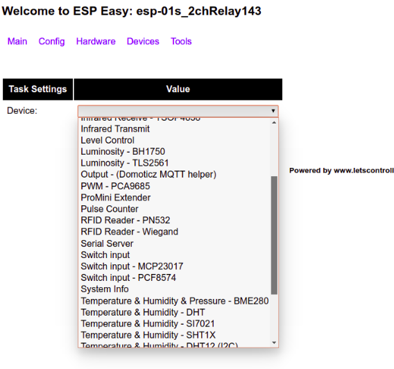

Hi , thanks for this hint.
looks like I am unable to identify this device? too stupid or blind...
in R147 I do not see the Serial MCU controlled relay plugin nor in GIT version: mega-20180104
nor :GIT version: v2.0-20180113
How can I enable the P165?
serial Screenshot from 2018-01-27 09-01-25.png (85.16 KiB) Viewed 7713 times

riker1 wrote: 27 Jan 2018, 09:02 in R147 I do not see the Serial MCU controlled relay plugin nor in GIT version: mega-20180104
1/ You can compile it yourself from github from the Plugin Playground:
https://github.com/enesbcs/ESPEasyPlugi ... Switch.ino
2/ You can use the pre-made binary attached to the first post of the thread, that i linked before:
viewtopic.php?f=6&t=3245&start=50#p16998
If you have enough time to read there are some useful user feedbacks and examples at this thread...
