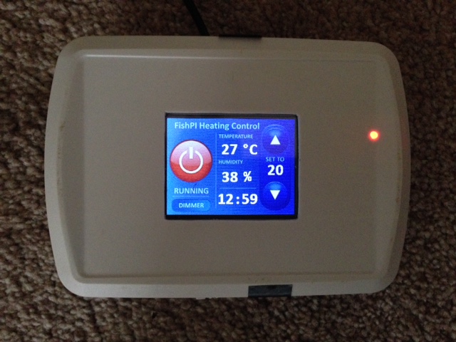

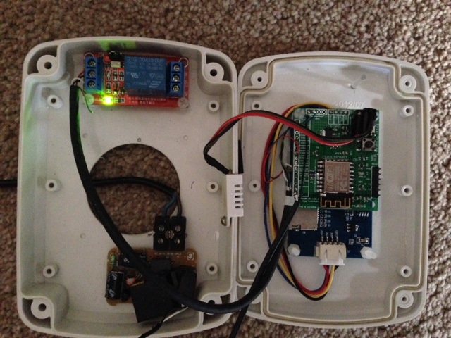

Hi everyone.
So glad this has been developed. I am going to replace my previous incarnation of Heating Thermostat (using a sonoff TH) with this Nextion. I have used Scargills PCB and screen design (modified) with a relay board and small PSU from a phone charger.
The advantage of Scargills board is that is has all the breakouts purposely positioned and also screws to the back of the Nextion screen making it compact.
I added the MQTT Import utility so I can pick up my Heating setpoint and display it along side the Temperature and Humidity from the DHT22 mounted at the bottom. I also brought up the Relay status (light on the right)
