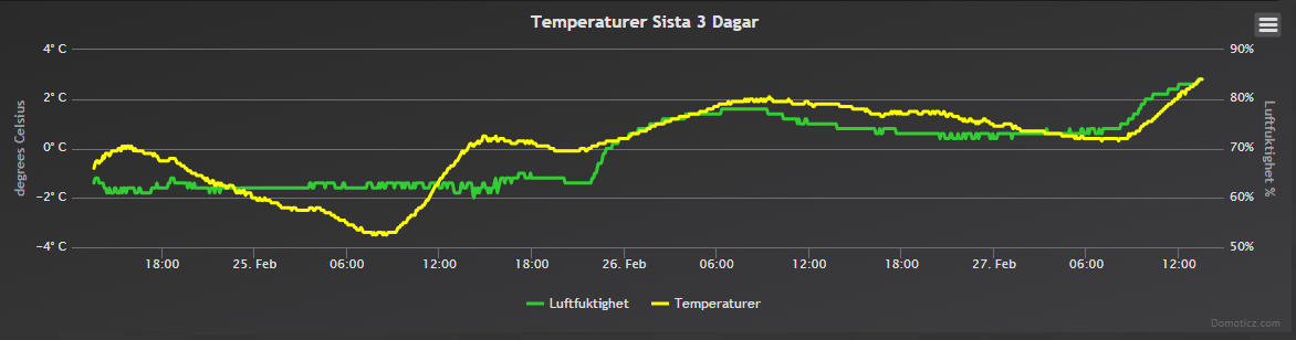

#17 Post by xztraz » 27 Feb 2017, 13:53
Just wanted to say that these sensors now work absolutely fine in test version of firmware (rfl4604_test)
Tested with 9 sensors. read by domoticz
