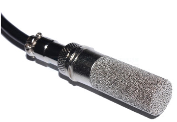

Just recieve this :
http://www.google.fr/imgres?imgurl=http ... aCh1-oANDt]
Plug it on a ESP12 and on Gpio 13, but it on earth with meddium water looks to get good value on ADC :

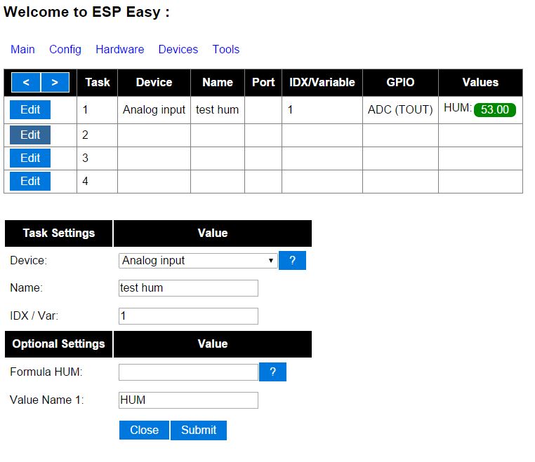

[attachment=0]Capture.JPG[/attachment]
Create a dummy device on Domoticz, and want to update it via HTTP/json.
Device is update but with no value (stay on : 0)
Is there a way to see which json order is send from ESP ?

et voila :

Received an SHT11 in watertight enslosure, with 4 wires peeping out (without any documentation).
From descriptions at AliExpress I deduct that following colourcoding might apply:
- brown = VCC
black = GND
yellow = Data

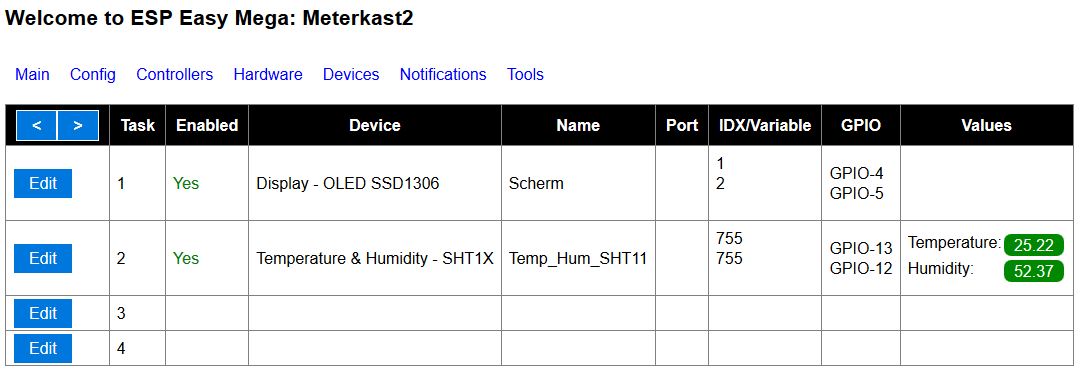

Found time to connect the received SHT11.
To avoid conflicts with the OLED on 'real' I2C (and in fact no choice, because then GPIO4+GPIO5 not made available for selection), similar to I2C at GPIO04 and GPIO05, start with SCL/SCK= D6/GPIO12 at 1st GPIO and SDA = D7/GPIO13 at 2ndGPIO
Under tab 'Devices/Edit' selected SHT1X, set PullUp and set Enabled, and then the 'Devices'-display shows values.
So far OK, but apparently missmatch with the 'standard' driver-software for SHT1X, because I get the display below, while I expect something like (at this moment) approx. 24 degreesC and 55%RH. The displayed values remain fixed regardless of changes in the environment.
In hindsight, these values are displayed if no sensor is connected and ESPEasy has the settings mentioned above ..........
If the result is not as expected, you look in detail & experiment ......
Putting the device-data&clock on GPIO04+GPIO05 and performing I2C-scan does not yield results => device is not I2C [as to be expected]

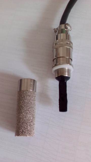

Opening the sensor-head does not help to get info, because the sensor-pcb is nicely shielded&coated.
Looking at the interface-side, I left the SHT-device hardware connected to D6 and D7, but did not set the GPIOs in ESPEasy:
then you get the result below (again with 'frozen' values).
Exchanging the wires on D6 and D7 has no results, hence certainly not the remedy .......
Then another idea popped-up ......
Switch SDA = yellow = D7/GPIO13 to 1st GPIO and SCL= blue = D6/GPIO12 to 2nd GPIO
But the opposite of the information in the Wiki!
=> Careful conclusions
1) lack of colourcoding for the cable => a lot of effort to find out the operational configuration
2) WEMOS & SHT11 can accept/survive quite a lot of molesting .....

Hi There,Got a Good result ! and solve my probleme !
using Json to update Domoticz Humidity device must be :
http://ip:port/json.htm?type=command¶m=udevice&idx=IDX&nvalue=HUMVALUE&svalue=HUM;HUM_STAT
http://ip:port/json.htm?type=command¶m=udevice&idx=IDX&nvalue=HUMVALUE&svalue=0 is allowed too
my probleme was ESPEasy send :
http://ip:port/json.htm?type=command¶m=udevice&idx=IDX&nvalue=0&svalue=HUMValue (the analogique value, saw this using Domoticz MQTT)
on R38 code i made this change on _C001
previous was :
case SENSOR_TYPE_SINGLE: // single value sensor, used for Dallas, BH1750, etc
url += F("&svalue="); //value from analogique was sending as the svalue
url += UserVar[event->BaseVarIndex];
and now is :
url += F("&nvalue="); // now analogique value is send as the nvalue who has to been updated for a HUMDITY sensor
et voila :
