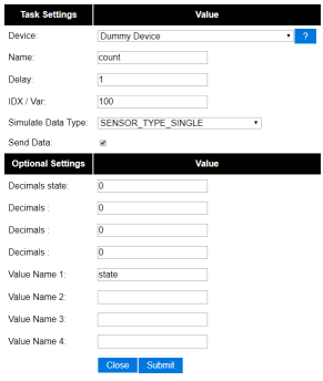

This uses a dummy device called "count" (task number 4) and dump the current state to value number 1 "state".
cracky
Posts: 5
Joined: 06 Aug 2017, 18:56
Location: Bucharest
Re: ESPEasy R120 Rules - [need help]
#6 Post by cracky » 04 Sep 2017, 21:31
Hello, guys!
I really appreciate your help, thank you for that, especially grovkillen.
I tried the script you provided with dummy device and after some more settings it works :)
It looks like this:
Devices:
Rules:
