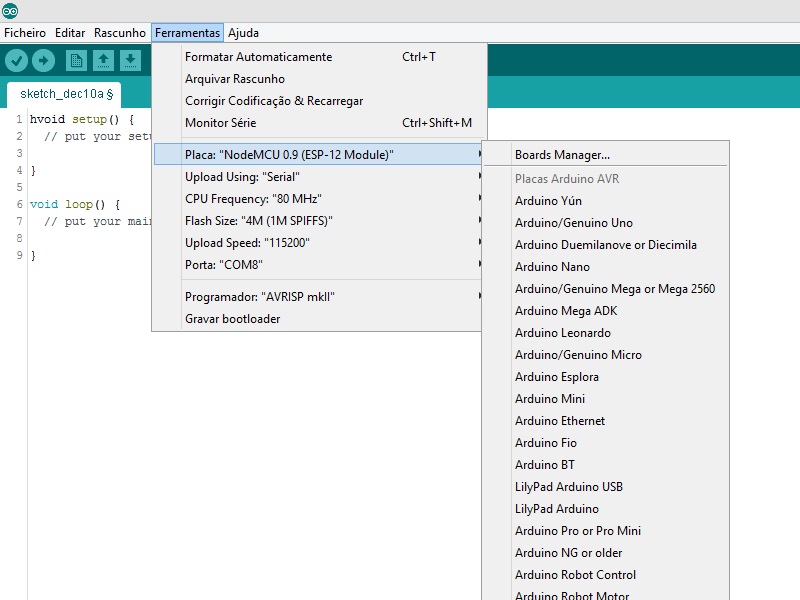

hello to me gives me this error
ESPEasyMySensors.ino:134:22: fatal error: MySensor.h: No such file or directory
compilation terminated.
Erro ao compilar.
Erro ao compilar.

the cosmic gate wrote:Exactely did this but :vmfs1968 wrote:I did everything as it says here and everything workedMartinus wrote:There was a compile bug in the first upload on github. This is fixed now.
I'm not 100% sure on how I did my Arduino setup for this experiment, but it should be something like this:
1) Download Arduino 1.6.5. zipfile and store everything in c:\tools\arduino1.6.5.MySensors
2) Make this a portable setup (this is what I always do to keep multiple versions without interfering other projects)
3) Get ESP8266 2.0.0. using the Boards Manager
4) Download the mysensors zipfile from github
5) Copy the mysensors folder to the portable setup, into c:\tools\arduino1.6.5.MySensors\Libraries
5) Copy the LiquidCrystal_I2C library to the portable setup, into c:\tools\arduino1.6.5.MySensors\Libraries
Run arduino, open sketch, upload.
longer works
Arduino: 1.6.5 (Windows 8.1), Board:"NodeMCU 1.0 (ESP-12E Module), 80 MHz, Serial, 115200, 4M (3M SPIFFS)" In file included from C:\arduino-1.6.5-r5\libraries\MySensors/utility/RF24.h:18:0, from C:\arduino-1.6.5-r5\libraries\MySensors/MyTransportNRF24.h:26, from C:\arduino-1.6.5-r5\libraries\MySensors/MySensor.h:28, from ESPEasyMySensors.ino:134: C:\arduino-1.6.5-r5\libraries\MySensors/utility/RF24_config.h:51:19: fatal error: SPI.h: No such file or directory #include <SPI.h> ^ compilation terminated. Fout bij compileren.
I used a esp8266 nodemcu v0.9
