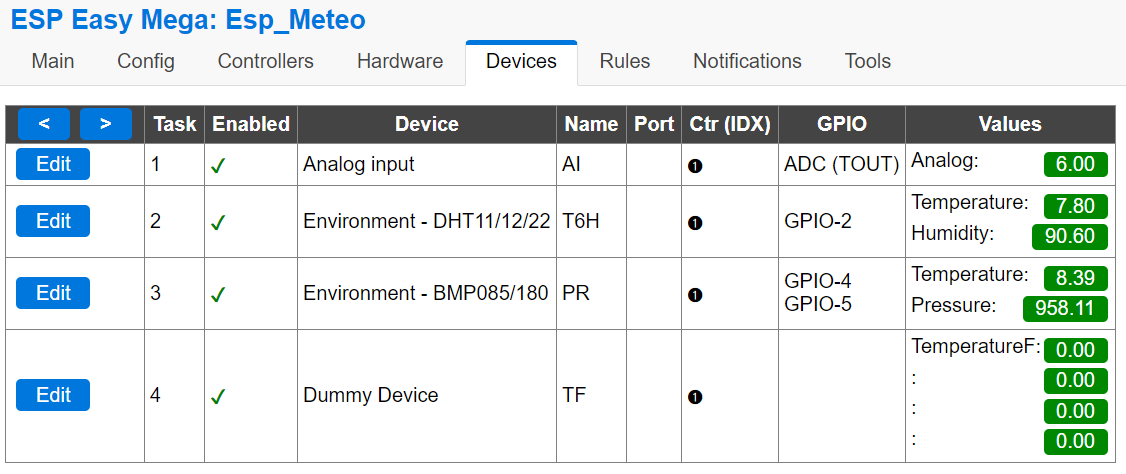

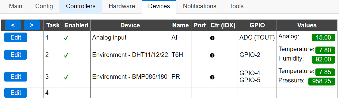

Dear All,
i have this problem:
I have instal the EspEasy on a ESP8266. This board is a weather station with connected DHT22 Temperature and Humidity sensor and BMP180 for a Pressure.
I'am trying for a long time to pubblist this three vale to weather underground site, but without success.
Can someone help me?
This is my device page, I want to use only Temperature Humidity and Pressure value and send this to WU.
Thanks in advance....

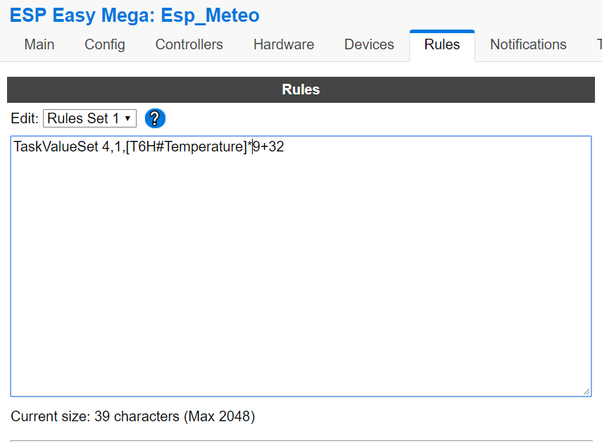

I have studied this guide but unfortunately I don't understand so much.
The firs think I have to do, is to create a Dummy Device who convert a °C in Fahrenheit, because the wu strung need Fahrenheit.
I create a Single DummyDevice with value called TemperatureF. In the rules I wrote this:
TaskValueSet 4,1,[T6H#Temperature]*9+32
But this doesn't work :cry:
Re: Http get request
#9 Post by grovkillen » 29 Jan 2018, 20:37
But you don't have any dummy device on task number 4?

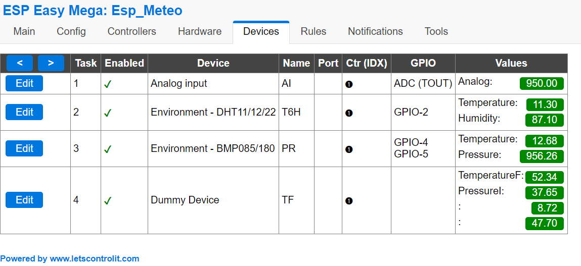

I have partialy solved, but I still have one problem, on the dummy device I'am not able to assign name to the 3 an 4 value. Why??

I have tried also with quad or triple bus the last two is no way to name it... Also if I create a new Dummy no one of the 4 value is nominable...

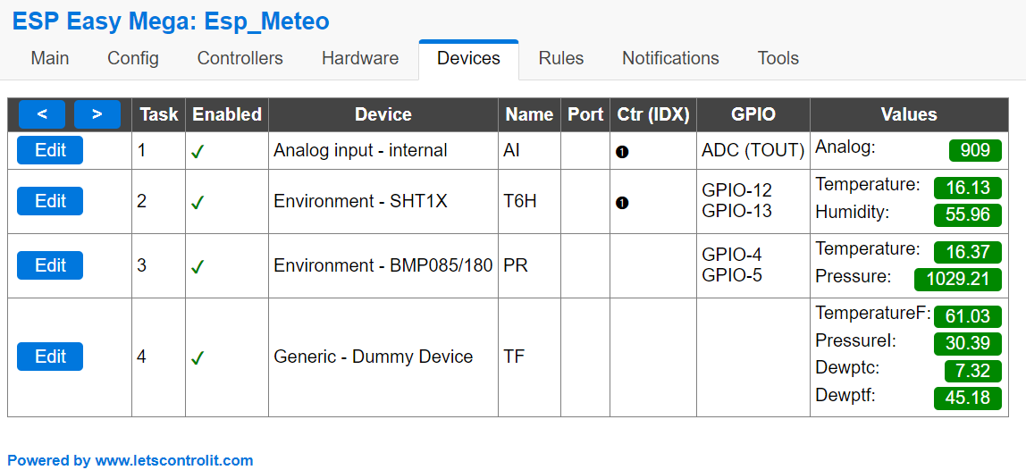

#21 Post by mr-varga » 18 Apr 2018, 19:18
Dear all, sorry for the delay but I not have received the notification for the new post....
By the way, now all working correctly and this is my complete situation:
And this is the two rules I use to converting the value and send all to wu:
