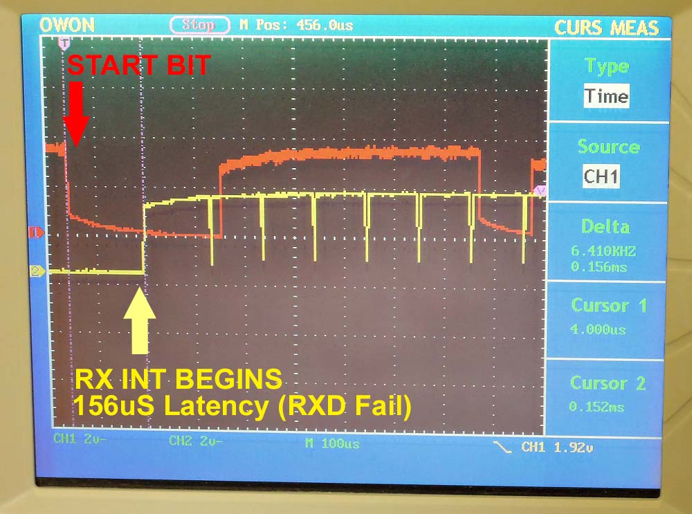

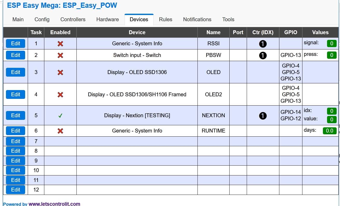

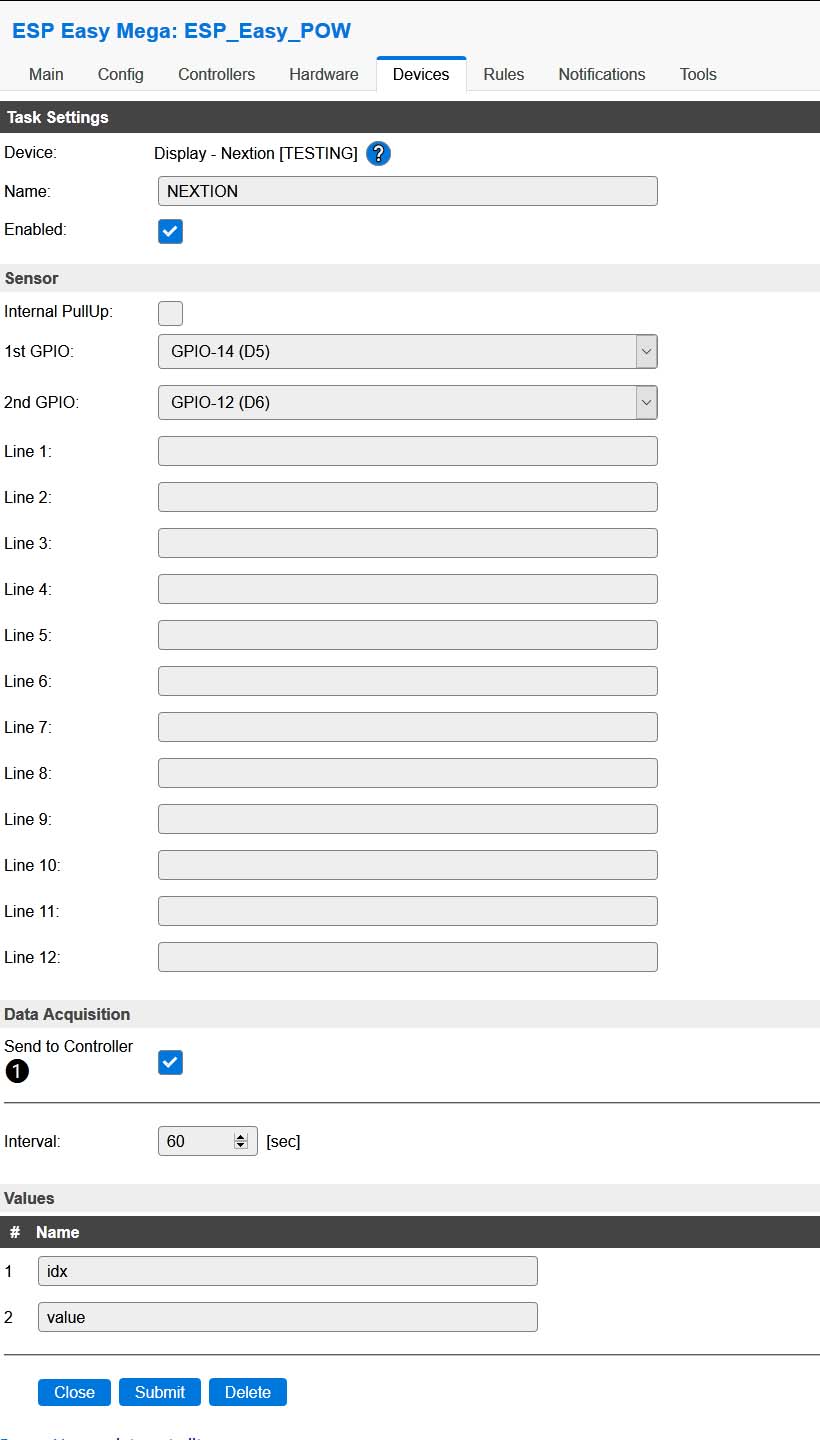

Nextion display plugin, random RxD data corruption
The ESP Easy's Nextion Plugin is ideal for my project. Thank you for creating it!
Issue:
My project is nearly done but I have one nagging issue to resolve. The problem is that the ESP is randomly corrupting the data packet message received from the Nextion display. The good news is that only RxD data is affected; The TxD data sent by Easy ESP to the display is always perfect.
Project Description:
I'm using a NX3324T028 display with Easy ESP installed on a LoLin NodeMCU V3. Easy ESP receives button press commands from the Nextion display and then communicates them via MQTT to my OpenHabian home automation system. It's a simple touch screen app for my wife to let her know when the washer and/or dryer machine have finished. When the laundry is ready (as soon as the machine stops) she gets a voice alert courtesy of the Amazon Echo Dots in our home.
RxD Corruption Description:
The issue is that sometimes the |s data packet payload that is received by the ESP Easy contains random characters. The corruption randomly occurs to either the "idx" or "value" data.
Here are some examples of the corruption.
ESP Log entry of good RxD from Nextion's print "|s,i98,sOff":
ESP Log entry of corrupted RxD from Nextion's print "|s,i98,sOff":
Troubleshooting Info:
* I've flashed the NodeMCU with a self-compiled build of "20102 - Mega" (PLUGIN_BUILD_TESTING) and I also tried the pre-compiled ESP_Easy_mega-20180615_dev_ESP8266_4096.bin. Both experience the problem.
* For development/troubleshooting I'm using the Nextion editor's Debug->User MCU Input emulation function rather than a real display.
* The serial baud rate is the default 9600. The 3.3V Serial Logic levels were verified by o-scope.
* All ESP Easy devices are disabled except the Nextion plug in.
* I have ensured that all communication between the Nextion and Easy ESP is only one |s data packet at a time with a minimum of 1 second interval between transmissions.

Nextion Screenshots:
- Nextion Configuration
- esp2a.jpg (80.74 KiB) Viewed 295230 times
- All devices disabled except Nextion
- esp1a.jpg (118.67 KiB) Viewed 295230 times

After some debugging I found the explanation to my ESP's corrupted Rx data. The Nextion<->ESP communication uses the ESPeasySoftwareSerial plugin which is an emulated UART. This function will sometimes produce corrupted serial data due to the ESP's background interrupts. The issue is random and only affects Rx data (ESP's SoftSerial Tx data is fine).
Reliable Rx byte decoding is based on a nominal interrupt latency time; Unfortunately the actual latency will vary a lot due to other interrupts that are sometimes being processed while a new Rx byte is received. That is to say, if the ESP is currently processing an interrupt, and a RXD start bit arrives, the ESPeasySoftwareSerial::rxRead() data byte is corrupted due to late entry into the RxRead function (because bit sampling timing is skewed).
Typical latency into the RxRead function is ~10uS and fortunately this is what occurs most of the time. But sometimes the latency is much greater and breaks Rx byte decoding.
Below is a o-scope snapshot captured during debugging. It shows the RxRead function's timing while decoding a "|" character that had too much interrupt latency.
The top red trace is the actual incoming serial signal and the bottom yellow trace is driven by a ESP pin that was toggled at each Rx bit's sampling. Because of the interrupt latency on the Rx data byte the start of sampling occurred too late. So the data's 0x7c ("|") value was shifted and incorrectly decoded as a 0x7e. There's no way to know which byte might be corrupted since it's just a roll of the dice.
I suspect that there's not much that can be done to prevent the randomly corrupted Rx data. So as a workaround I will have the Nexion send each ESP message multiple times to help mask the problem (sloppy big hammer approach). Too bad the ESP8266 doesn't have two hardware serial ports!
