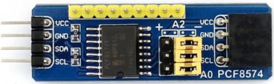

Re: GPIO-1 and GPIO-3. Can I use them?
Thank you for your help.
I bought th PCF8574 device.
It will take a couple of week to come from China, but I am trying to understand how to use it. I found this article: https://www.letscontrolit.com/wiki/index.php/PCF8574, but have a few questions.
First of all, are the connections on the right and on the left the same? Can I use either one of them?
Also, the article says that there will be eight additional pins, but I see nine pins on the board. Do you know why?
It is not clear how to connect it in the ESPEasy. The example show Port: 1 and IDX/Var: 22. What are those numbers? I do not understand that table with A0, A1, A2, Address, and Port range. Can you please explain?
Thank you.
I'm still in the office and don't have a module at hands.
The yellow pins are the additional input/output pins, the 9th pin might be a ground pin, i have to check that myself.
The four pins left and right are identical, yes.
You can chain max. 8 of these modules by just plugging one module to the other.
At this point the A0...A2 comes up: This selects the address the PCF chip uses on the I²C bus.
As you have three jumpers and every possible combination from all jumpers "on" to all jumpers "off" is valid you can select up to 8 addresses.
Connecting to ESP is as simple. I²C is a two wire bus system. The bus consists of SDA (data) and SCL (clock).
On top you need Ground and 3.3V (Vcc). Connect GPIO5 (D1) to SCL, GPIO4 (D2) to SDA, Vcc to Vcc and Gnd to Gnd.
That's it.
For input you need a task per input.
The input port number depends on the address you've chosen with A0...A2. If you have set A0-A3 to "0" or "Off", this is chip address 0,
so input pins for the setup in ESPEasy are pins 1 ... 8 (so called "Port Range")
If you set for example A0 = 0, A1 = 1 and A2 = 0 you selected the chip address 2. Port range will be 17 ... 24 then.
For output just send command:
For example: PCFGPIO,6,1 to switch the pin 6 on chip 0 to "on".
For a detailed description of I²C and how to get it to work see wiki: https://letscontrolit.com/wiki/index.ph ... C2%B2C_Bus
Great, thank you very much. I will try it when I receive this device.
Does it mean that example has a mistake? They have Port 1 and IDX/Var is 22, but in your explanation IDX/Var 22 (17-24) would be with the port 2, not port 1. Am I correct? Or maybe I do not understand it.Shardan wrote: ↑22 Mar 2018, 16:33 The input port number depends on the address you've chosen with A0...A2. If you have set A0-A3 to "0" or "Off", this is chip address 0,
Thank you.
Port number and IDX are not related.onlize wrote: ↑22 Mar 2018, 23:58Does it mean that example has a mistake? They have Port 1 and IDX/Var is 22, but in your explanation IDX/Var 22 (17-24) would be with the port 2, not port 1. Am I correct? Or maybe I do not understand it.Shardan wrote: ↑22 Mar 2018, 16:33 The input port number depends on the address you've chosen with A0...A2. If you have set A0-A3 to "0" or "Off", this is chip address 0,
Thank you.
In the example in the wiki:
The 3 adress bits (A0-A2) of the PCF chip are all set to 0.
This means the chip will have the I2C-Adress 0x20 and the port range is 1-7.
If the adress bits were set to 1 0 0 the adress of the chip changes to 0x21 with the port range 8-15.
This way, up to 8 chips can be daisy chained.
The IDX is the unique identifier for Domoticz. It has nothing to do with the adress/port of the PCF.
Got it. That IDX value confused me. Thank you for explaining.
