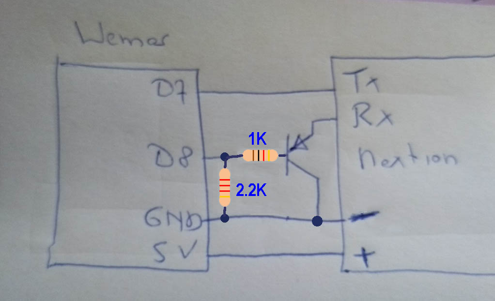

After installing the PNP buffer transistor I discovered that sometimes boot would hang (on both hardware reset and web reset). Perhaps once every 50 boots the board would hang. The issue can be resolved by adding two 1/8W resistors to the PNP transistor. BTW, the PNP can be any general purpose type, such as PN2907 or 2N3906. See revised schematic image.
Because of today's fixes I need to re-validate the code again. So I'll need a bit more time.

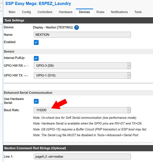

Attached is the Nextion Plugin revisions dated July-10-2018. There will probably be some more minor edits, but it's time to let others try it out.
There were a lot of code changes, but the plugin stays true to the original; It supports the |u, |s, 0x65 commands. The rssi easter egg is still available too (but has been renamed to rssibar).
With hardware serial I have not experienced a single communication problem (100% data reliability). Furthermore, hardware serial would reliably support faster baud rates (softserial would fail). Faster data would be desirable on an app that transferred waveforms. But I didn't add a baud rate selector since I don't know if there were any ESPEz Nextion users that would care. For me, 9600 baud is fine. Any baud comments?

      addFormSubHeader(F("Enhanced Serial Communication"));
      addFormCheckBox(F("Use Hardware Serial"), F("AdvHwSerial"), Settings.TaskDevicePluginConfig[event->TaskIndex][0]);
//    addRowLabel(F("Hardware Serial Notes:"));
      addFormNote(F("Un-check box for Soft Serial communication (low performance mode)."));
      addFormNote(F("Hardware Serial is available when the GPIO pins are RX=D7 and TX=D8."));
      addFormNote(F("D8 (GPIO-15) requires a Buffer Circuit (PNP transistor) or ESP boot may fail."));
      addFormNote(F("The Serial Log file MUST be disabled in Tools->Advanced->Serial Port."));

Rather than regret not doing it, I added the Baud Rate drop-down for hardware serial. The Nextion display supports baud rates 2400, 4800, 9600, 19200, 38400, 57600, and 115200.
The baud rate function has been tested with the Nextion Editor (via user MCU Input). I'll do more testing (with a Nextion Display) in a couple days. Also, I'll hold-off posting any more code to allow some feedback on today's release.
