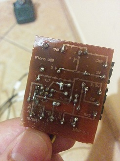

I ended my project to control the temperature of heating with underfloor heating through of water panels,
I will use 4 sensors DS18B20
- Sensor to see the temperature of the hot water that goes into home
- Sensor for the actual temperature of the water after leaving home
- Outdoor temperature
- Indoor temperature
After testing in bradboard , I decided move to the final version of my project, then started to build a board with the necessary components.
[attachment=0]IMG_20151115_200655.jpg[/attachment]
- Esp8266-01
- 2 x 4k7
- DC 5V to3.3V convert
- Micro USB
- 8 pin female
- ScrewTerminals

- IMG_20151115_200655.jpg (35.01 KiB) Viewed 15278 times

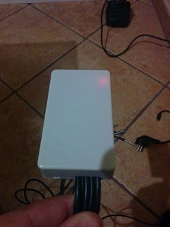

Re: Water heating panel /Ds18b20 Temp
the final version with enclouser

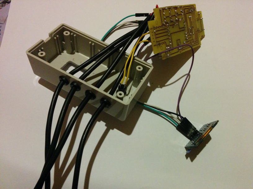

hi guys
since the last project i was working to improve my floor heat control so i have done this:
i have change to a esp 12 because have more GPIO to play
, has add a jumpers to reset, Gpio0/gnd, and upgrade (have to put gnd and vcc by fti too only put RX/TX), add blue led when module are on, lcd to display the temperatures on local, and a switch to turn on/on the LCD (the switch is working by domoticz but i think better work like action control or logic level by esp easy but not implement, nobody tell me if we will get any day).
so this are the photos:

- rsz_img_20160104_234415.jpg (72.94 KiB) Viewed 14883 times

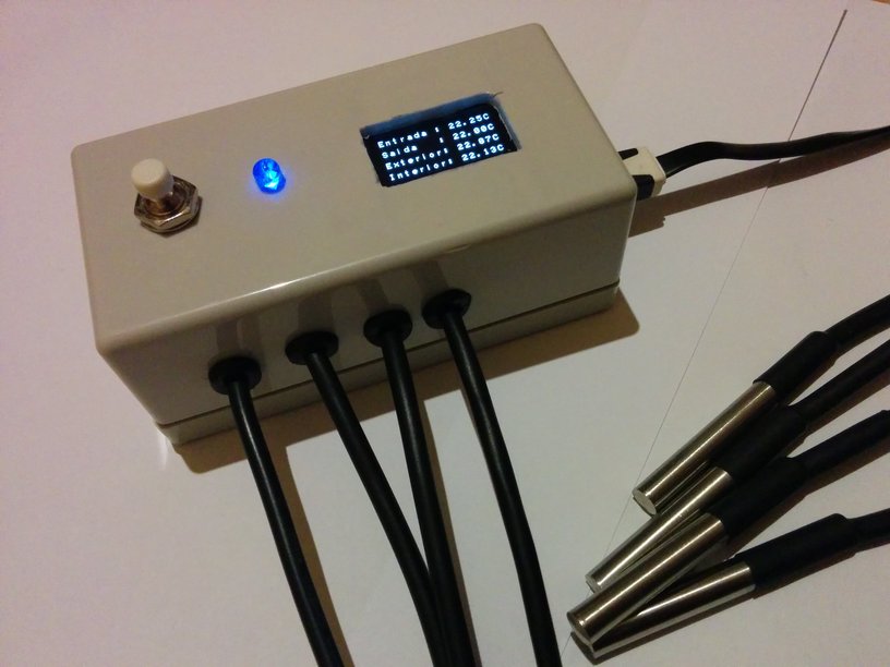

- rsz_img_20160112_192827.jpg (74.69 KiB) Viewed 12925 times

so this was my renew project that i will offer to my daddy, lucky for him.
thanks esp easy for the support and the guys with the same doubt that was posted on forum and help me to understand minimal this stuff.
- rsz_img_20160112_212317.jpg (53.18 KiB) Viewed 12925 times
