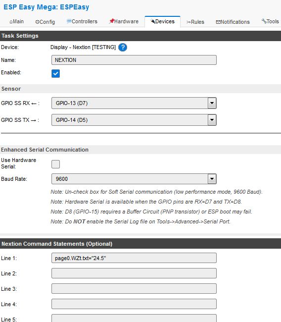

meanwhile I think, I am stupid. I scrolled through the whole thread. My Nextion is connected to a Wemos D1, blue cable=> D7, yellow cable => D5. Serial port disabled.
Configuration of the Nextion in ESPEasy:
In Nextion, I have a textfield named "WZt", when I am tying to send esp_ip/control?cmd=NEXTION,page0.WZt.txt="hallo" nothing happens.
pi@raspberrypi:~ $ man woman
No manual entry for woman
pi@raspberrypi:~ $
Posts: 1367
Re: Nextion display plugin
#413 Post by ThomasB » 24 Oct 2018, 22:35
1. When you issue your http command from a web browser, does the browser show a response that looks like this?
NEXTION075 : WRITE = page0.WZt.txt="hallo"
2. Your Line 1 Nextion Command Statement is configured to write "24.5" to the Nextion WZt text field every 10 seconds. Do you see this value on the Nextion Display?

Yes, the browser shows me exactly the response that you've posted. Sorry, I should have added this info to my post.
And no, the "24.5" doesn't appear on the Nextion. Thats why I tried to send whatever to the node connected to the Nextion using the http control command.
pi@raspberrypi:~ $
Posts: 1367
#415 Post by ThomasB » 25 Oct 2018, 03:54
That confirms the Nextion plugin is active.

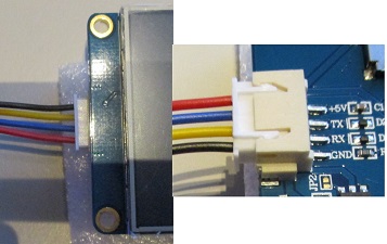

1. Check the ESP's serial wiring for problems.
BTW, don't forget the Nextion's black (ground) wire needs to be connected to Wemos ground. Nextion requires 5.0V (not 3.3V).
2. Check your Nextion software that you created. Maybe there is an error in your code.

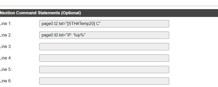

I did the same as you, setup the Nextion plugin. And put in the first line: page0.WZt.txt="24.5"
Then i start Nextion Editor, I have selected a font. Then i select in in the Toolbox the first line, Text.
Give it as objname: WZt
Compile it and save is as WZt. After that i bring the two files to the Nextion. I see on the screen "newtxt"
When i do esp_ip/control?cmd=NEXTION,page0.WZt.txt="hallo" it respond with NEXTION075 : WRITE = page0.WZt.txt="hallo"
But i don't see "24.5" on the Nextion screen.
I do something wrong in the Nextion Editor part, and here i need some help.

#430 Post by Wiki » 01 Nov 2018, 11:32
What you have done is absolutely correct. Talking to the Nextion using the Nextion-plugin is really that simple - if you do have a working serial communication.
Check your wiring twice and triple, assure you have connected GND ESP and GND Nextion, use baudrate 9600, disable serial communication in ESPEasy Tools/Advanced.
In my first step I followed This wiring diagram, except diode and resistor, they are not necessary. My first configuration RX/TX of ESPEasy-plugin is shown here. To use hard serial my Nextion is meanwhile connected to the RX/TX pins of the Wemos.

Thanks Wiki, it works now. You have right, a wiring problem. I was looking to much too the colors. But the wiring of my screen was reversed. Better looking at the rear side of the print was the solution.

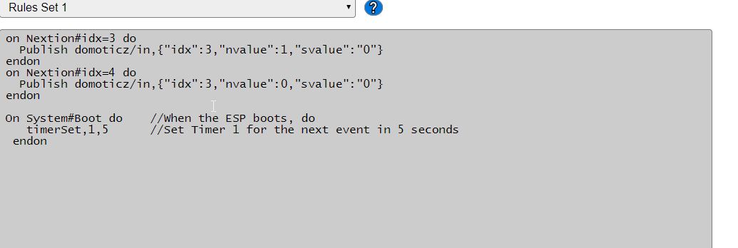

First I added two variables va0 and va1 and unchecked the Send Component ID of
Bt0, b0 and down buttons.
Next I put some code under the buttons:
Under Tough Release Event of bt0:
if(va1.val==0)
va1.val=1
print "|s,i99,sOn"
printh 0a
}else
va1.val=0
print "|s,i99,sOff"
printh 0x0a
I also added some rules to the ESP.
on Nextion#idx=99 do
if [Nextion#value]=1
sendtohttp 192.168.0.243,8080,/json.htm?param=switchlight&type=
command&idx=304&switchcmd=On
command&idx=304&switchcmd=Off
on Nextion#idx=230 do
sendtohttp 192.168.0.243,8080,/json.htm?param=udevice&type=
command&idx=79&nvalue=0&svalue=[Nextion#value]
With the code below, you can now also send values.
As for now I distinguish |u for update and |s for switch
First of all I will thanks BertB and ThomasB for this plugin. After a lot of reading and trying i can now switched the three lights in the livingroom on and off with the Nextion Display.
With the help of the part I quote it runs fine.
