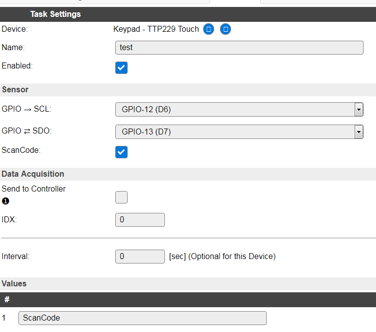

Conneected :
SCL- GPIO12 (D6)
SDO- GPIO13 (D7)
Device- Keypad - TTP229 Touch
MPR121 touch sensor

IC on my board MPR121
IC in espeasy mega-20190511 -TTP229
but Plugin 062: MPR121 KeyPad says it should work properly but i don't see it in devices in espeasy.
