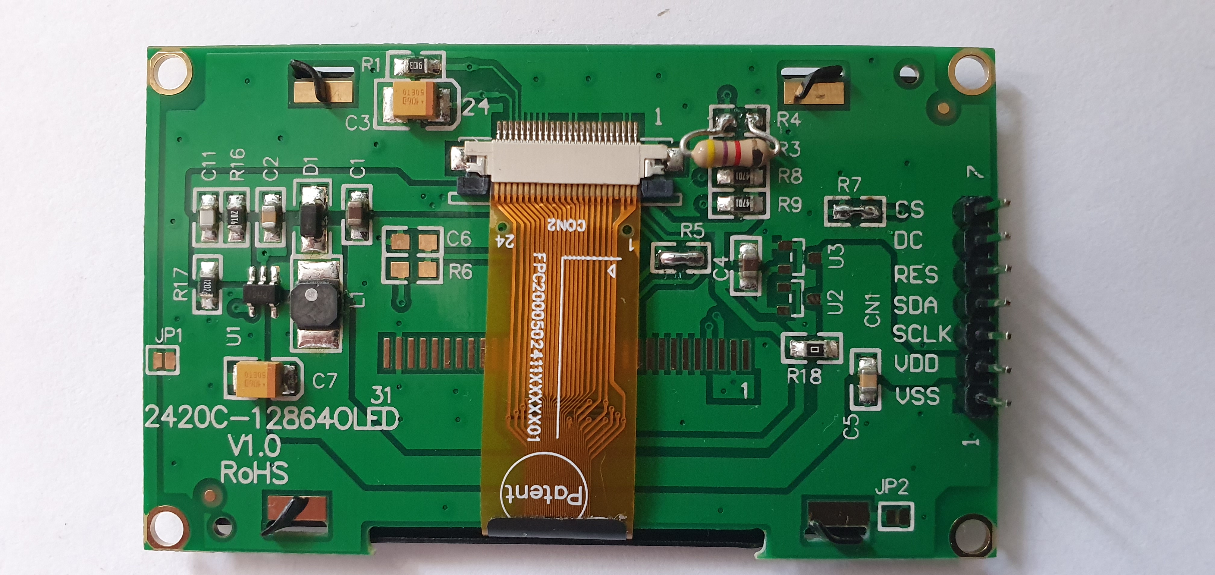

I use exactly the same 2.42 display with ESPEasy for some time now.
You have to prepare the board before it will work:
Remove R17 and place it on position of R15
Solder a short or 0 ohm on position R13
Solder a short or 0 ohm on position R18 or connect the CS pin to ground
Connect the OLED display to the ESP with Gnd, 3.3V, SCL and SDA
also connect the RES pin of the OLED display to the ESP_reset_pin. (or 3.3Vcc)
If you do not connect the CS pin to ground and the RES pin to RST the display will stay dead.
The Oled uses the normal address 3C and works perfectly well with the standard OLED SSD1306 plugin.
It looks like the controller on this display board is NOT a SSD1309 despite what the info says.
I tested the OLED with the U8G2 library on a Arduino and the best results I got with a SSD1306 constructor, using a SSD1309 constructor will give ghosting on the first 2 columns

#7 Post by costo » 17 May 2017, 11:02
-macke- wrote: 15 May 2017, 23:00 Thanks for your awnser. I could now find the display in ESP Easy and I got some light. But I could not put back 17 to R15.. it was to smal.. how did you managed that?
Indeed the 0603 SMD resistors are extremely small but you have to remove R17(4k7) and solder a resistor with a value between about 1k and 10 k on the place of R15 otherwise the display might not be recognized as I2C.
The first time while desoldering R17 I lost it ,( never saw it again :? ) , I had some 0603 smd 4k7 resistors in stock so used a I new one, using a soldering_iron with a small point, a tweezer and soldering flux.
(p.s. if you live in my neighbourhood you can get yourself a new 4k7 smd from me or else you order them in China https://nl.aliexpress.com/item/100pcs-l ... ee89881dac)

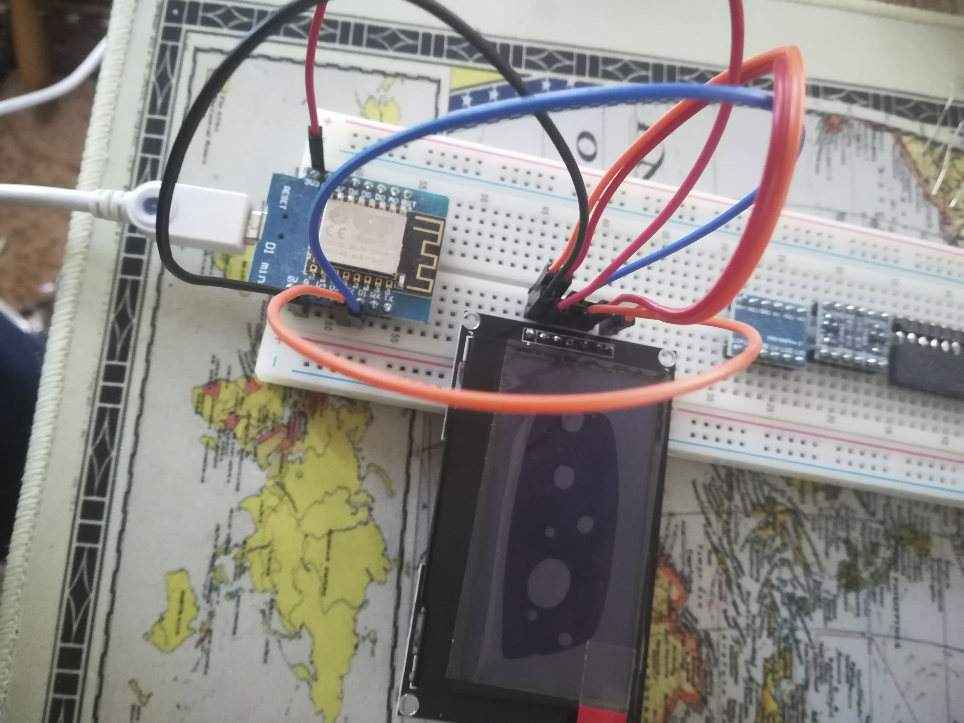

I have following model:
I would like to use it I2C mode therefore
I have
* moved R4 to R3
* R5 short
Connectd via Wemos D1 mini
GND, VCC, SDA, SCL, RES to VCC, CS to GND
With I2C scanner I get only "Unknown error at address xx" for every address.

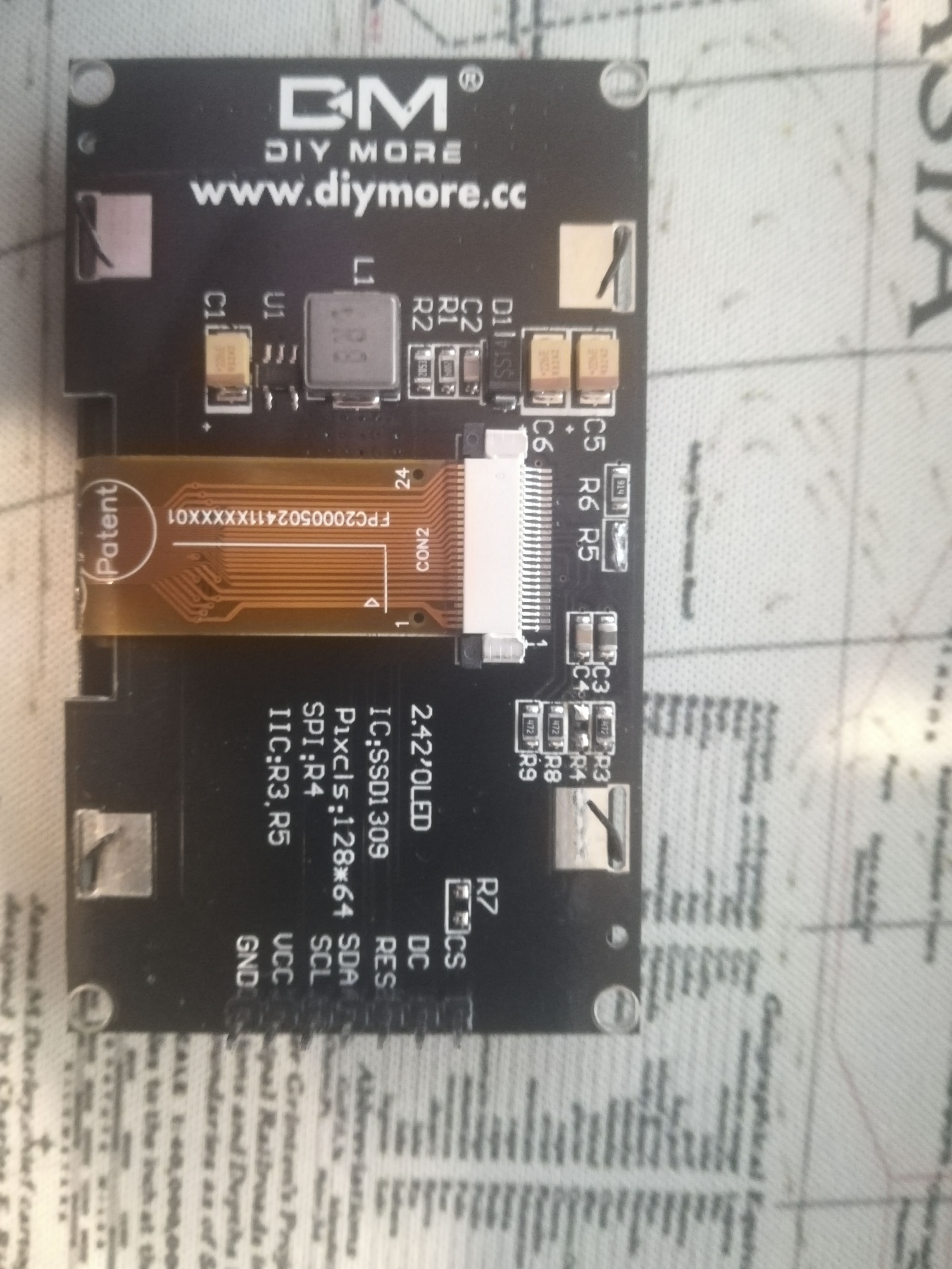

#13 Post by Abdelabdel » 21 Jun 2019, 00:10
You must connect CS with DC and strap R7
Abdelabdel
Joined: 21 Jun 2019, 00:03
Re: OLED 2.42"
#14 Post by Abdelabdel » 21 Jun 2019, 09:39
CS and DC to ground via strap

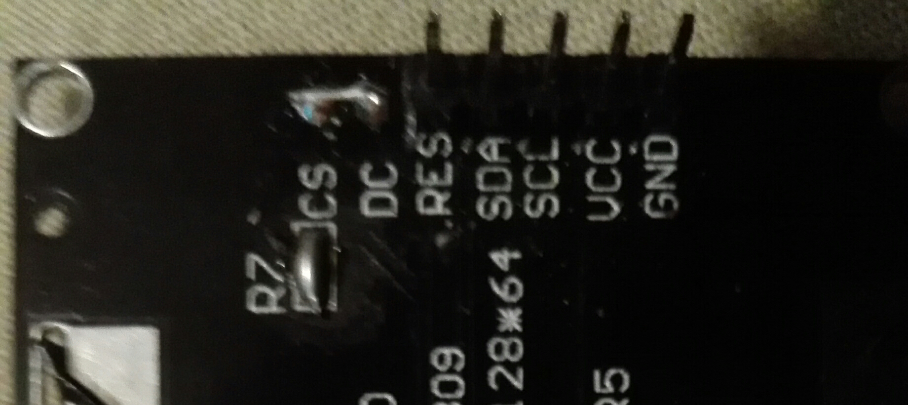

#15 Post by dereks » 24 Aug 2019, 14:57
I have moved/replaced resistor R3 to R4, strapped R5 and R7, connected DC and CS to ground and connected RES to Vcc. My i2c scanner either reports "No I2C devices found" or "Unknown error at address 0x..". If I unplug the display and pop in one which is only an i2c device, it picks up the device at address 0x3c so I know the i2c wiring is OK.
Sometimes the display shows some content at startup which I've gather from some reading could be a timing issue. I've tried connecting RES to an IO PIN and keeping it low for a fraction of a second at startup and then keeping it high. No luck.
Any suggestions would be highly welcome.
Thanks in advance

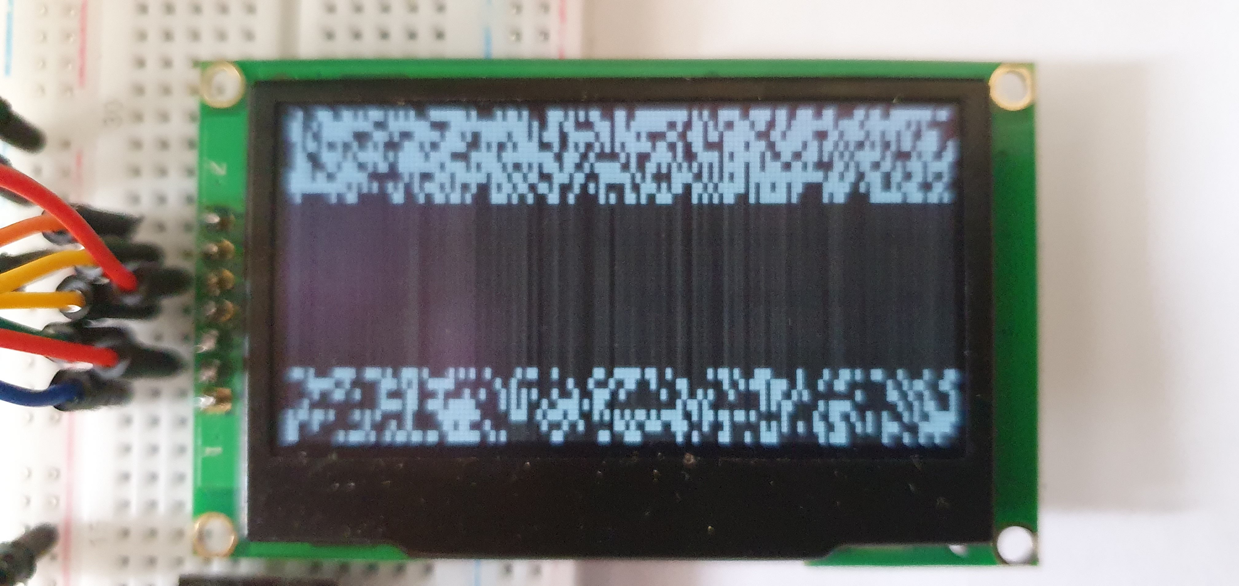

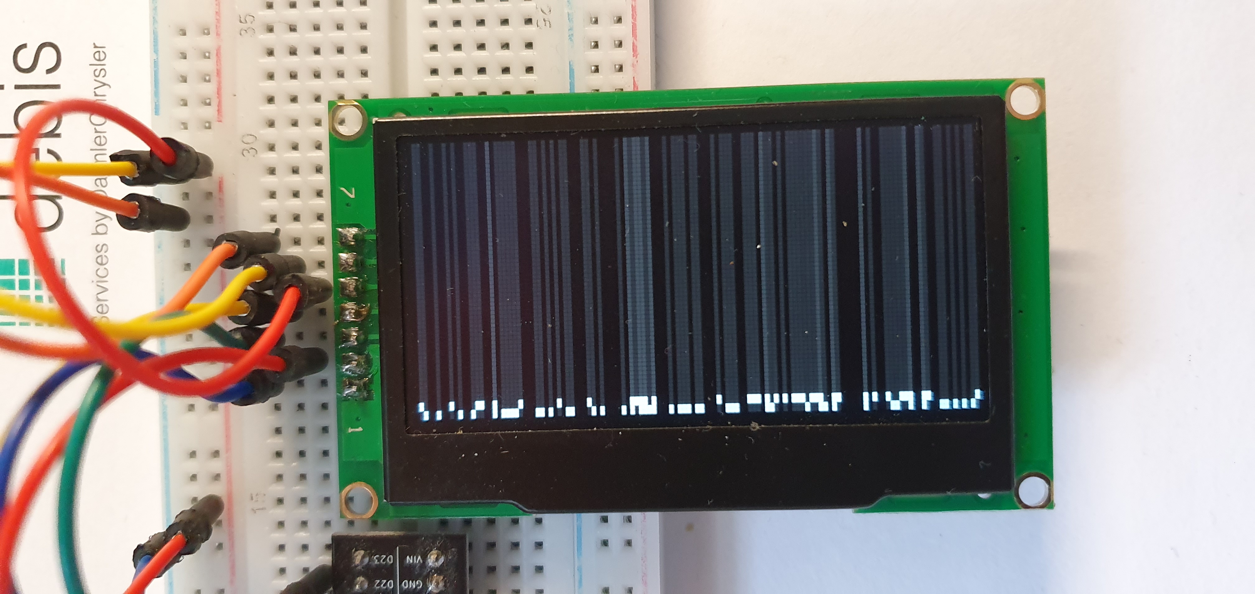

#17 Post by dereks » 25 Aug 2019, 11:38
I did. I then either get the screen showing either the above picture or flashing a kind of "snow". The pic below is not 100% what is visible to the eye.
