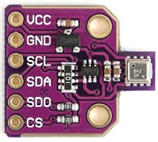

Hi, I ordered a CJMCU-680 including a BME680 sensor. I want to add it to my ESP8266 with ESPEasy.
What are your suggestions for including it in my project using GIT version v2.0.0-dev13 ?
I found a Github with the file _P119_BME680.ino but it is 2 years old, he has not more recent ?
I've made some trail on Arduino, then the read back for Gaz is Kilo-Ohms !!! Not really a good Air Quality indicator.
I would also like to know what to do for the library BOSCH lib, is it really necessary for the calculations of the IAQ?
