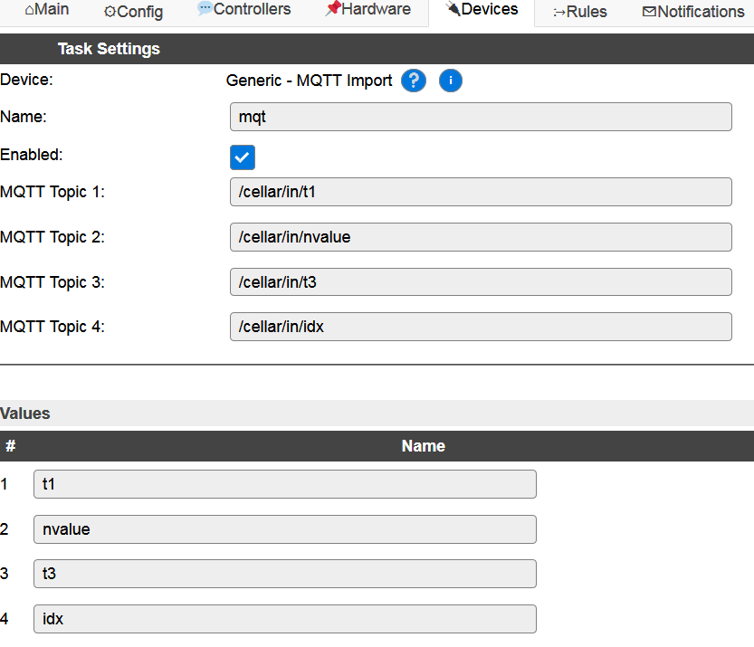

I would like to transfer data from nodered over MQTT to my ESPeasy device.
I can not configure this.
I configured Controller, and I saw in mosquitto_sub how ESP sends data.
Client mosqsub|11803-orange received PUBLISH (d0, q0, r1, m0, 'cellar/status/LWT', ... (9 bytes))
Connected
Client mosqsub|11803-orange received PUBLISH (d0, q0, r1, m0, 'cellar/out/LWT', ... (9 bytes))
My data that I want to receive in ESP is as follows:
Client mosqsub|11803-orange received PUBLISH (d0, q0, r0, m0, 'cellar/in', ... (59 bytes))
{"idx":10,"nvalue":31.19,"svalue1":"31.19","t3":31,"t4":19}
Client mosqsub|11803-orange received PUBLISH (d0, q0, r0, m0, 'cellar/in', ... (55 bytes))
{"idx":7,"nvalue":29.3,"svalue1":"29.3","t1":29,"t2":3}
I configured device in ESP. What mistakes have I made? I tried different options in Generic setup - MQTT Import, but I did not receive the data.

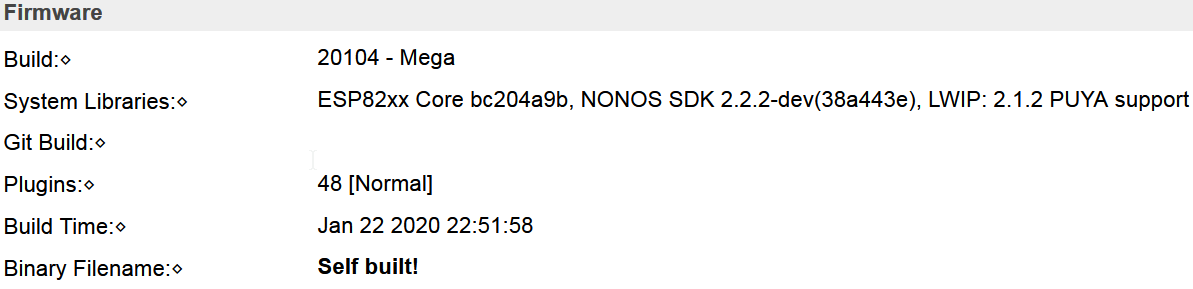

Maybe MQTT is not working correctly in my firmware version? But, I can not use another version because of the PZEM-004 device.

Wow! Thank! I did the conversion in NodeRed and everything started working correctly.
[attachment=0]FwlFnNf8Mf.png[/attachment]
