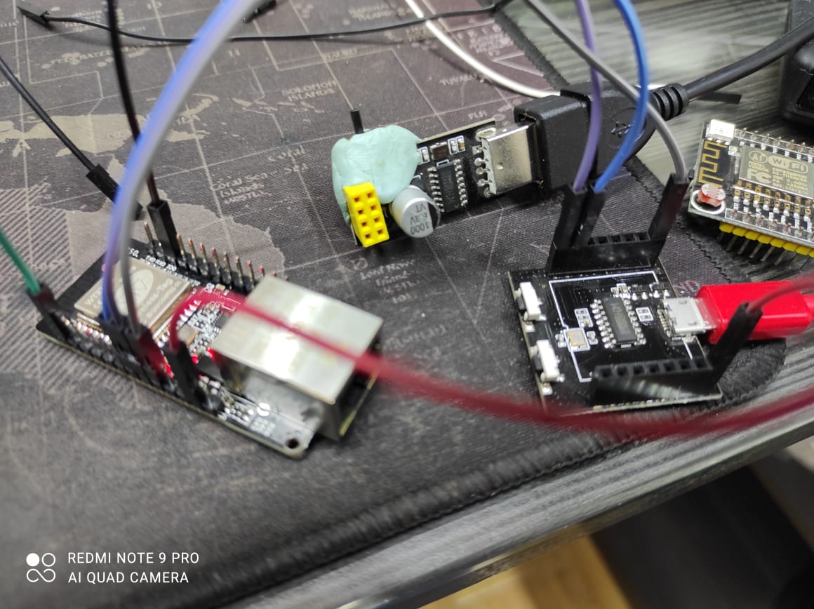

I'm trying to flash or load my own code to this board.... at the moment to try upload the code the board is not getting connected, you know, it keeps like .....____.....____ I'm trying with these serial converters (in the image) without luck, actually I'm reading serial messages good, since when I connect to my USB the device I can see in the serial monitor the message "module ok" sent by the default firmware, my problem is at load my code... :( , could you share some info about how you are programming this board? or some diagram of connections.
thanks in advance!
WhatsApp Image 2021-01-22 at 4.44.36 PM.jpeg (132.83 KiB) Viewed 176417 times
Re: WT32-ETH01
#36 Post by TD-er » 23 Jan 2021, 00:07
If your board doesn't have an embedded USB to UART converter chip, you may need to trigger the boot-into-flash-mode yourself.
To do this you need to perform these steps in this order:
- Connect GPIO-0 via some resistor (470 Ohm, or direct connect) to GND
- Reset the node, while keeping GPIO-0 connected to GND
- Only let the GPIO-0 loose if the flashing has started.
The reason to use a resistor for pulling GPIO-0 down is to protect the GPIO pin if it may be running some firmware which has the pin set as an output and high level.
But I guess you can also get away with just connecting it to GND.
Most boards have the "boot" button connected to GPIO-0 like this.
Oh and if you're connecting an external USB to uart... make sure RX of the USB chip is connected to TX of the ESP and vice verse.
Also double check the voltage is correct as a lot of those converter boards do have a very bad voltage regulator on them.

Pepe wrote: 22 Jan 2021, 23:51 Hi guys,
If GPIO-0 connected to GND and serial connection did not start, you have to try a bigger power supply, around 5V1A. But be careful with common GND!
This module may use up to 0.2A at startup especially when wifi is connected and/or LAN cable connected. The serial adapter itself can not provide as much, even the best CP2102 (max 100mA) can not do that.
I do not see the converter type on your picture, i guess it can be a CH340G which can provide ~25mA max.
But if wifi/LAN is not connected i'd able to program it CP2102 + the wiring below, using Thonny:
As i looking your wiring i guess you are using GPIO35 and GPIO17 for RX/TX which will never work. Real RX/TX is near the ESP chip at the right side.
https://bitekmindenhol.blog.hu/2020/11/ ... kes_lan-al

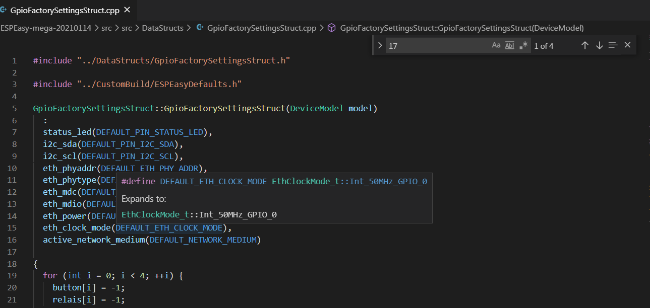

What I did now if trace to where the 'DEFAULT_ETH_xx points to and made that correct. So i now compiled a ESP_Easy_mega_20210124_normal_ESP32_4M316k_ETH-factory.bin and I loaded it and the settings as far a clock, MDC MIO and power pin are correct directly after flashing the firmware.
1651 : Info  : Eth Wifi mode: Ethernet ETH: PHY Type: LAN8710 PHY Addr: 0 Eth Clock mode: 50MHz APLL Output on GPIO0 MDC Pin: 16 MIO Pin: 17 Power Pin: -1
What I am still unsure off is that any of the other pins
IO19, IO21, IO22, IO25, IO26, IO27
are perhaps not configures wrongly somewhere... I have ordered some spare LAN8720 ic's so I will try to solder one on and see if I can make it to work
Hi enesbcs,
Men!!! you make my day! I don't know why I never tested "Real RX/TX is near the ESP chip at the right side" that was my mistake... :D :D :D
now it's working :) , I share the simple test code I used to check this board if this helps to someone else...

I'm reusing the this USB to UART adapted to ESP8266 to flash this board
https://es.aliexpress.com/item/40012677 ... web201603_
and the wiring (as enesbcs's previous diagram)
WhatsApp Image 2021-01-24 at 9.10.36 PM.jpeg (124.48 KiB) Viewed 176215 times
