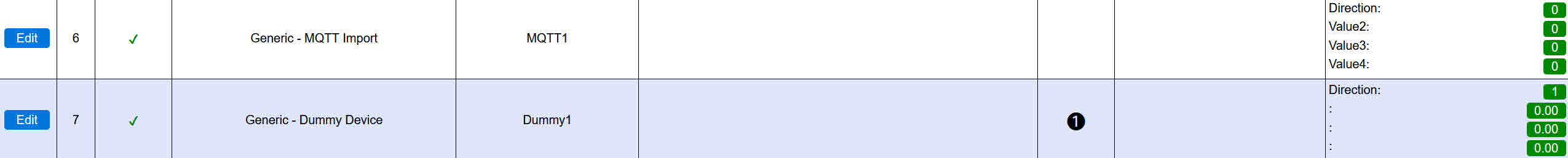

Running ESPEasy (ESP_Easy_mega_20210503_normal_ESP8266_4M1M) on an original Wemos D1 mini, I'm struggling a bit with a rule, it seems like it's not parsed correctly.
I have two devices:
The rule:
