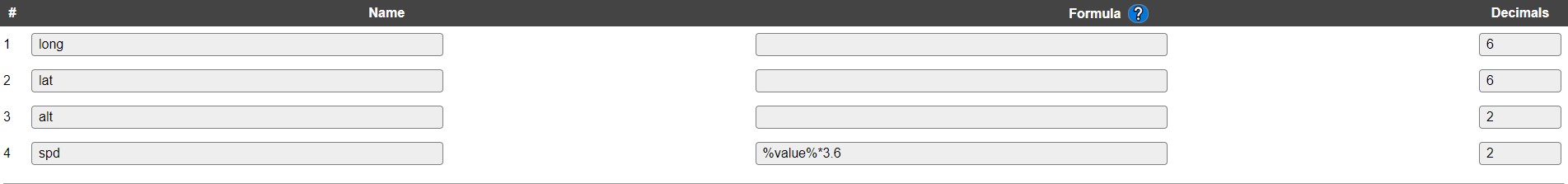

#3 Post by Sasch600xt » 11 Sep 2021, 20:02
Hello TD-er,
I forgot to tell i multiplied by 3.6 already :)
Screenshot 2021-09-11 195155.jpg (39.42 KiB) Viewed 31760 times
Thank you for the hint about the post formatting.

i do the conversation right in the plugin:
Screenshot 2021-09-11 195155.jpg (39.42 KiB) Viewed 31597 times

this is how it looks in my Software so far:
Screenshot 2021-09-15 172240.jpg (314.18 KiB) Viewed 31558 times

#32 Post by giorgino » 24 Oct 2024, 22:22
WHERE AM I WRONG ??
Hi, just bought a GPS NEO6m, connected for testing to a PC serial, it works !
Reading data at his 9600 with a serial monitor, got fix.. OK
Then I connect it at espeasy, and doesn't work; there is something I miss:
gps espeasy.jpg (196.67 KiB) Viewed 9580 times
the GPS tx is connected at pin 25
No other device (for testing I've unflagged all the "enabled" flag in other device)
any idea?
thanks
Re: GPS Plugin P082
#33 Post by TD-er » 24 Oct 2024, 22:27
Please set it to "Serial 1" as on "Serial 0" you probably have the ESPEasy console.
