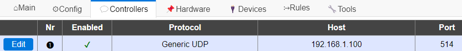

I have Controller 1 set to Generic UDP.
I just don't know how to set those events to be sent to the controller.

Re: MCP Status without device
#21 Post by Ath » 07 Aug 2024, 16:54
Hm, that's one of the controllers that doesn't have a direct command to send out values.
(Best) alternative is to use the SendToUDP command from rules, but you'll have to manually provide the url and format the payload (also part of the url...) as intended.
on mcp#1 do // Act on MCP pin #1
  SendToUDP,<destination-ip>,<port>,'%sysname%_mcp_1_state=%eventvalue1%'
// Or alternatively for all pins in a single rule:
on mcp do
  SendToUDP,<destination-ip>,<port>,'%sysname%_mcp_%eventpar%_state=%eventvalue1%'

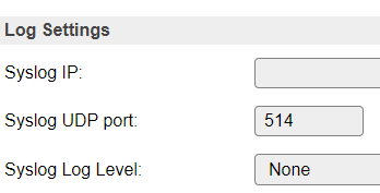

I found another option in tools
Only the whole log goes there again, everything.
