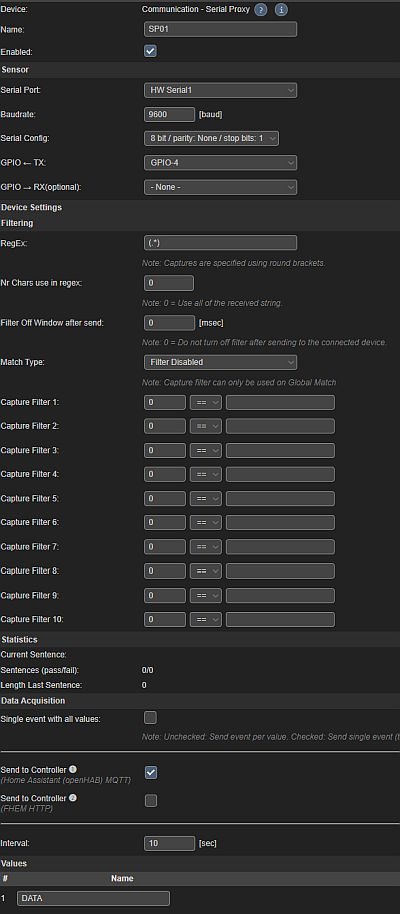

I have just take a look... But where can I chose the GPIO that the GW have to take data from? There is nothing about to see... ... but I'm sure that I just overview some .. or not?Or use ESPEasy plugin P044 P1 WiFi Gateway, that can be installed multiple times.

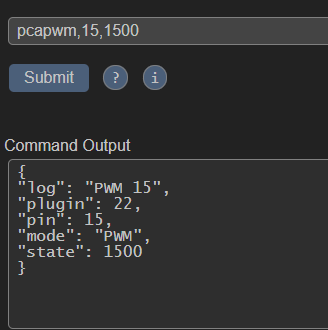

Ok, today the PCA9685 PWM crash into my postbox.
I have connect them and also 3 servos at PWM 0, 4 and 15. Also I have set all as default at "Extra IO - PCA9685" (0x40, shown in the "I²C-Scan", 0x10 for mode2) except the frequenz for mode 2 that I have set to 60
Now I send i.e "pcapwm,0,2000" but they do nothing...
What I'm doing wrong?

Yesterday I did type an elaborate post about the specifics of a servo. So I just link it here
viewtopic.php?p=62217#p62217
TL;DR
Servo's need quite a specific timing sequence.
So maybe you should test the servo's first on a GPIO pin on the ESP using the servo commands.

Ok, last for now...
I have read a while at the datasheet https://www.nxp.com/docs/en/data-sheet/PCA9685.pdf. Special side 14 and 16 are very important. I start with side 16.
There I find out that 0x10 can't be the default due BIT 2 of ModeRegister 2 default are 1 (TP on output) but the outputs are set to OD with 0x10. So if you set the Mode2 to 0x04 or 0x14 (inverted output) the servos walk without an external pullup...
That's the 1st one.
The 2nd one is how to touch ModeRegister1 (see side 14)?
I don't can call all servos via "all" and also not via "sub". So I can't initialize all servos at startup and have to touch every single port step by step.
then for all my servos (6 different types) ...
M2 = 0x04 & Range = 10000 --> pwm from about 340 to about 1210 works for 0° to 180°-190°
M2 = 0x14 & Range = 10000 --> pwm from about 8890 to about 9760 works for 0° to 180°-190°
So it comes to 180/870 steps while ignoring the low resolution of 12bit
... and ...
while running the testloop rule to check out these ranges the esp sometimes crash and reboot...
Power source for servos are a 6V12AH PB, VCC for PCA9685 PCB and ESP are independent (ESP from PC, 2A USB / PCB from labor PSU)
Script is simple to test stability ...

I have not (yet) looked at the code for pcapwm, but given how blocking the "fade" option on the regular PWM command is, I can guess what it will do there.
Better not use those 'fade' options for the PWM commands.
I still need to think about something to make them a bit more useful, since (at least the normal PWM command) does perform an active loop to update the duty value.
We now have a lot more options to schedule task actions, so I guess we must do something like that to perform the fade options.
On ESP32 there are some hardware features to let PWM update over some range, but I have not yet updated the code to actually use those HW timers.

yepp, that will be a good one... But former I don't have used fade and then it crashed more often. Seems that fade soften that problem instead of harden ...
Anyway... This PWM to drive a servo don't work as expected right now so I will swap back to my coil winding option. Time to test the counter device to count the winding

Ok, back to topic.
Meanwhile I have set two Serial Server as devices. Both only receive. Device1 with HWserial1 on GPIO4, Device2 with HWserial2 on GPIO5.
At the Moment I have placed one IR-Reader provisionally and get every second a result like that:
This looks similar to what I expected, except the unknown signs. SO I have play around with the settings, but the funny thing is, that I can change the communication parameter from 7 to 8 bit, one or two stop bit... Nothing change
An other problem is: How can I grab that with FHEM? I have set that the device have to send it to the FHEM-controller but FHEM ignore that...
Or do I just use the wrong device for that?

Meanwhile I have connect RealTerm by LAN to the ESP.
If I set there ASCII and 7bit I really got what I expected; take a look:
Start is ever / followed by the hardware-ID and firmware rev.
1. Unique ID of the meter
2. Cumulative since 1st start
3. L1 actual power
4. L2 actual power
5. L3 actual power
6. Cumulative all phases actual power
7. No idea what 80 means
8. Meter ID again
So the question is how to send that to FHEM or, as option, to MQTT ??

Ok, have the latest running.
But sorry... I have no idea what I have to use to transfer the data at GPIO4 to FHEM
We have the WiFi-Gateway, the Serial-Proxy and the Serial-Server. I have try all of them but I have the feeling that I don't understand which module does what or whether I even have to combine two modules here...
Normally, FHEM sees a new device immediately and integrates the transmitted readings directly via AutoCreate. It doesn't seem to work here somehow... Or I only understand "Bahnhof-Kofferklau'n" again

Ok... I'm lost
I have spent the whole day to catch any result.. but failed ...
All I have read is that the Serial-Proxy is that what I have to use. And the SP sent all then to i.e. MQTT...
The only what I got is that: So I have play around with all I get in mind but no result...
So I need a little help what I have to type into the proxy fields to get my data.
As you can see at viewtopic.php?p=62493#p62493 there is not so much. At the end I need readings "DV, CN, L1, L2, L3, LC" filled with the data between the starting ( and the 1st * or ) from the 1st 6 lines starting with "1" so as result I got ...
So how to????? I'm running out of ideas ...

Test:
Create a device "Serial-Server" and a device "P1 Wifi Gateway".
Set the 1st to HWSerial1 <-GPIO4 and i.e. port 2221, the 2nd to HWSerial2 <-GPIO4 and Port 2222 (or verse visa).
Provide data to GPIO4
On Windows open i.e. RealTerm twice
Set RT1 to ESPIP:2221 and RT2 to ESPIP:2222
Result:
RT1 show the data on GPIO4 via SerialServer, RT2 via P1 WiFi don't
Change ports and HWSerials if you like or try it one by one... The result is ever the same
