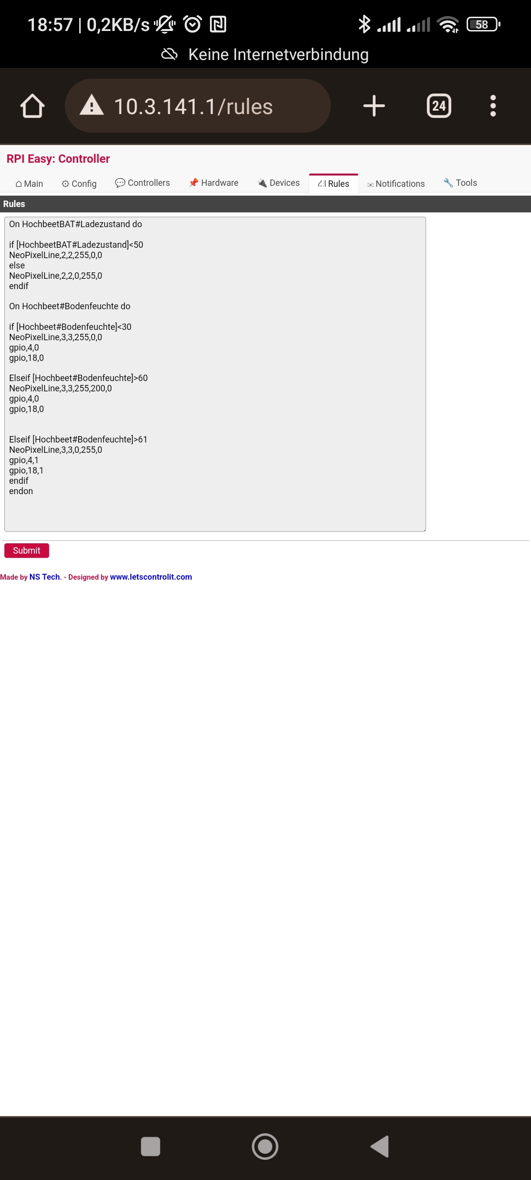

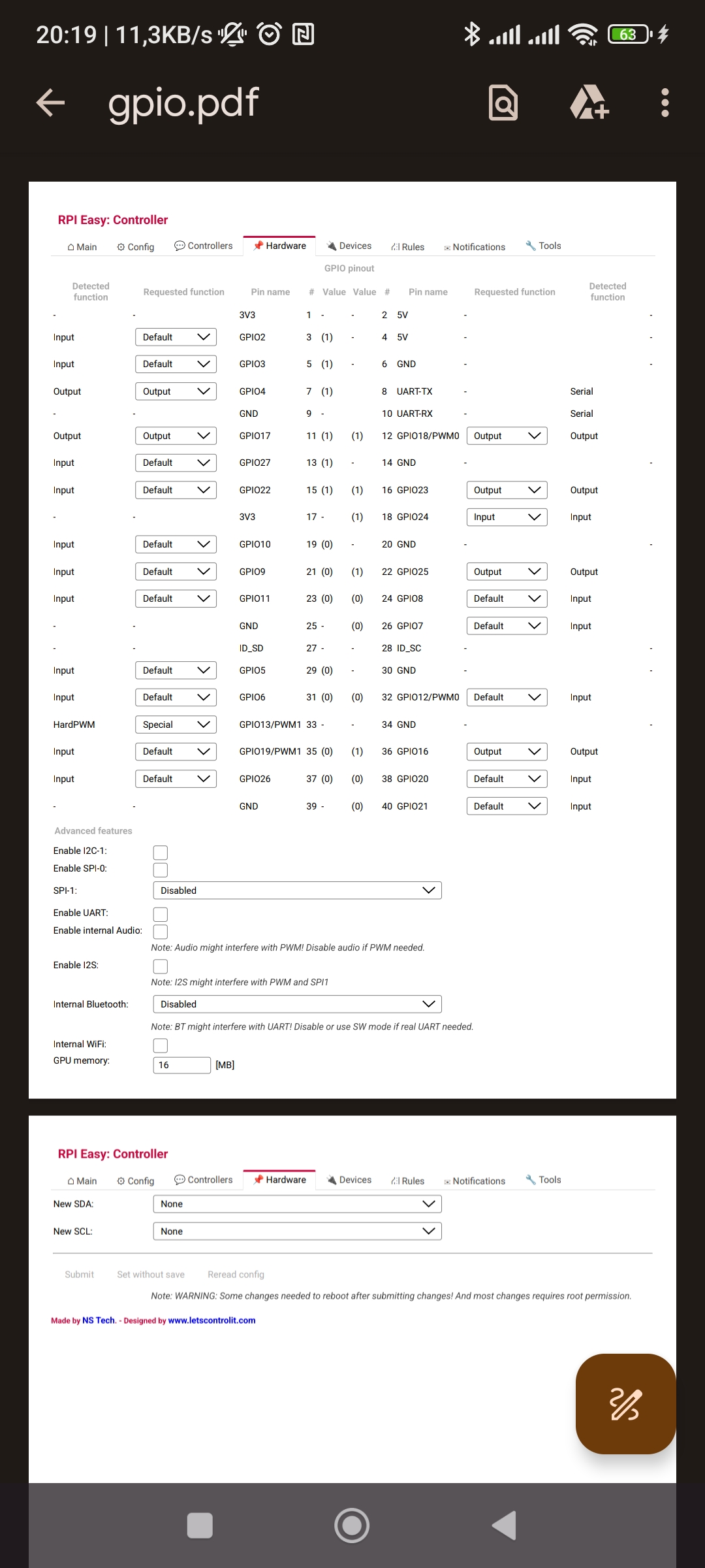

Hello today i was in my garden and wanted to advance my project but i had problems with the rules.
I set there the function to check a Task from the P2P bridge. Under the "Devices" tab i got all the informations and they actualize well.
In the rule i set the task that it should set a ARGB to the right colour as desired and this works great BUT i wanted in the same way that this rule will trigger a GPIO Pin but in the log i got errors.
CMD not found: GPIO,4,1
i forgot to make a screenshot and i´m now not there.
In the "Hardware" tab under "pin configuration??" i set the pins to Output. Where is my failure?
Thanks Have nice Day

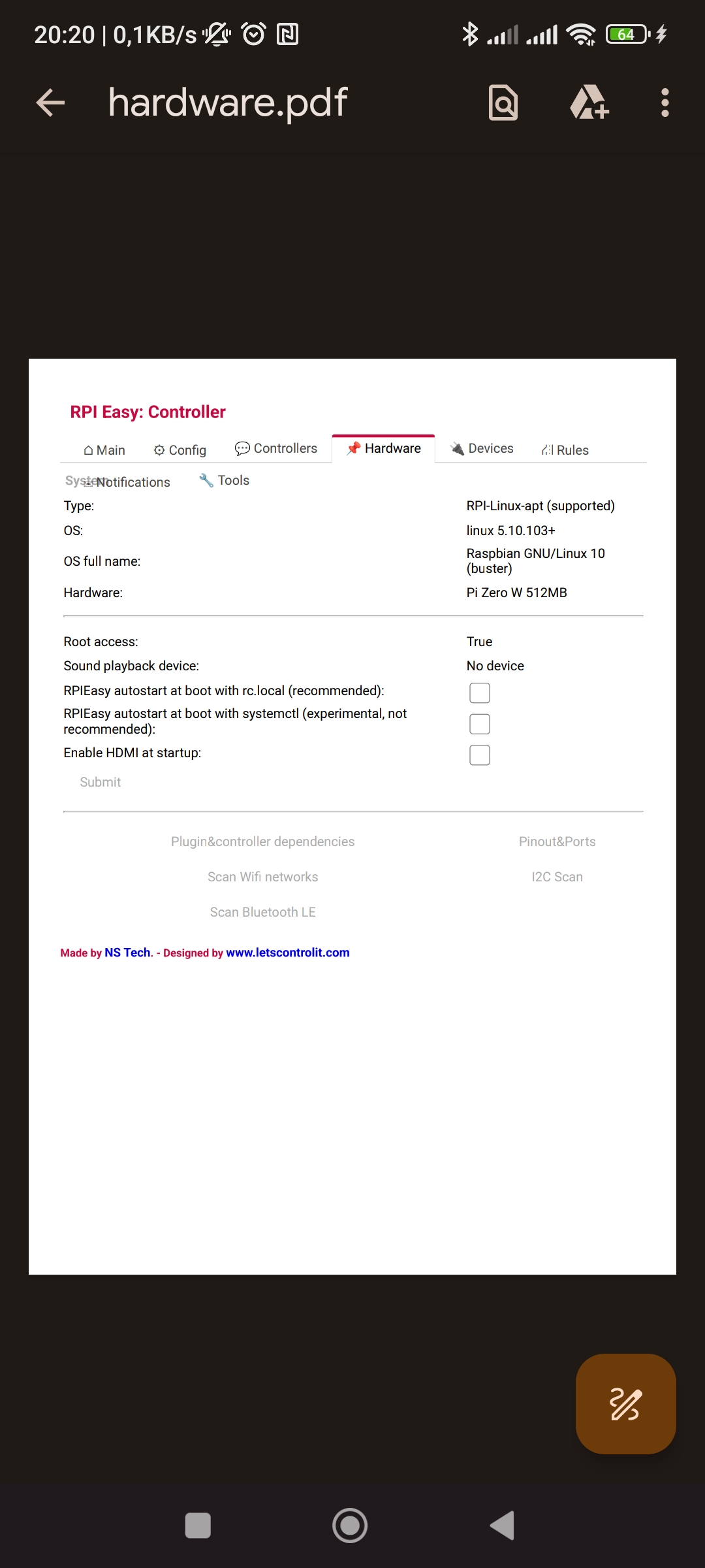

Screenshots are cute, but for a succesful debugging at least these thing are needed:
- specification of the hardware, operating system and python version
- full logs
- content of the data directory (under rpieasy)
If those are not available, only a clairvoyant can tell the problem.

Hello i got some details but not enough because theres no option actual to get in the data explorer.
I tried today some different changes in rules but i got 2 states:
No Errors, and no Executions or
Errors and no executions,
under the attachments you find screenshots.

Hello again,
thank you i got it to work but there comes now more questions.
I had to rewrite the Rules because "elseif" didn`t work. Or did i something really wrong?
So i had to wrote it to:
On Hochbeet#Bodenfeuchte do
If [Hochbeet#Bodenfeuchte]<85
NeoPixelLine,3,3,255,0,0
gpio,4,0
gpio18,0
If [Hochbeet#Bodenfeuchte]>85
gpio,4,1
gpio18,1
Why i had to do this?
Have a nice day
Re: RPIEasy
#333 Post by Ath » 06 Jun 2023, 23:23
Obstsalat wrote: 06 Jun 2023, 22:42 So i had to wrote it to:
Your script isn't complete, the if needs an 'endif', and just 'else' should be enough
