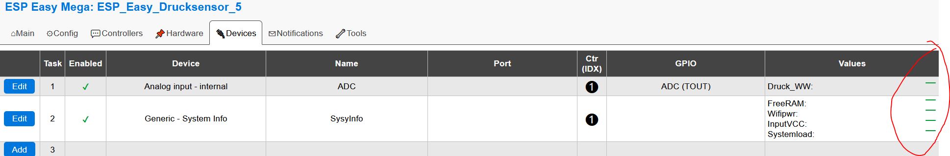

I read a pressure sensor with ESP_EASY on a Lolin NodeMCU V3. The reading works and I can see the correct pressure.
I want to send the values to iobroker. MQTT is working (I use it with other ESP_Easy devices) but I get no values?
What is wrong with my configuration?
Thank you!

Re: ADC Problem, reading is ok but no value
#2 Post by Ath » 12 Nov 2023, 22:32
What binary file did you upload to the unit? If it includes "VCC" in the name, then the analog pin is wired to read the 3.3V power of the ESP8266...
You can upload the same binary without VCC in the name to fix that.
#3 Post by TD-er » 12 Nov 2023, 22:34
I think you should have a look at the controller configuration.
Also, what build are you using?
Are you sure the JavaScript files are active for refreshing the devices page?
#4 Post by obstbauer » 12 Nov 2023, 23:47
I use Build: ESP_Easy_mega_20230507_normal_ESP8266_4M1M May 7 2023
I guess without VCC
But the measurement is working? I get correct values.
The controller configuration is the same as in the other devices which work
"Are you sure the JavaScript files are active for refreshing the devices page?"
How can I check this ?

#6 Post by obstbauer » 13 Nov 2023, 14:52
I added a task and I have the same problem
no values like free Ram etc. are shown

obstbauer
Posts: 61
Joined: 25 May 2023, 15:46
#9 Post by obstbauer » 13 Nov 2023, 16:40
there are no issues in the console
I tested with chrome firefox and Edge
I checked the options, Javascript is enabled for websites

#11 Post by obstbauer » 13 Nov 2023, 23:38
this post was from me too
with my ESP01 it works now
but here I have another problem, the web interface looks normal, the measurements shows right values but not on the page I showed

#22 Post by obstbauer » 15 Nov 2023, 22:46
no
no values are shown
only indicator reachable on the picture I posted

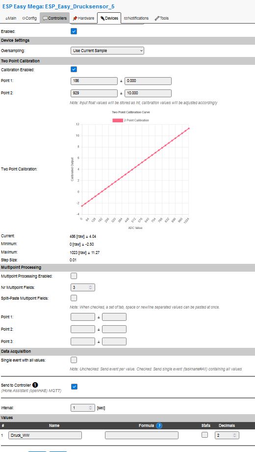

#23 Post by Ath » 15 Nov 2023, 23:09
You haven't shown your Controller configuration yet, can you share that?
I assume you've validated the server address, username & password multiple times? (that's usually where the mistakes can be found...)
For some servers the "Client Timeout" setting needs to be increased, 1000 msec should usually be enough.
#24 Post by obstbauer » 15 Nov 2023, 23:23
I have three ESP01 which all sent their data to iobroker without problems
and I use the same settings of them for this devide so I don't think that the controler setup is a problem?
#37 Post by obstbauer » 18 Nov 2023, 22:25
I use the A0 pin ?
I Think this board has only one ADC ?
#38 Post by Ath » 18 Nov 2023, 22:30
Yes, but did you also check the "Send to Controller" for the "Home Assistant..." controller checkbox in that task?
#39 Post by TD-er » 18 Nov 2023, 22:41
obstbauer wrote: 18 Nov 2023, 22:25 I use the A0 pin ?
Sorry, I thought you were running on an ESP32 variant.
#40 Post by obstbauer » 19 Nov 2023, 00:02
Yes send to Controller is enabled
#42 Post by Ath » 20 Nov 2023, 14:57
If you enter %sysname% in the Controller Client ID field of your MQTT Controller, is it then showing the values for the unit named "ESP_Easy_Drucksensor_5" ? Because that's the name that is used when sending the values...

#43 Post by obstbauer » 20 Nov 2023, 19:30
this is the entry:
