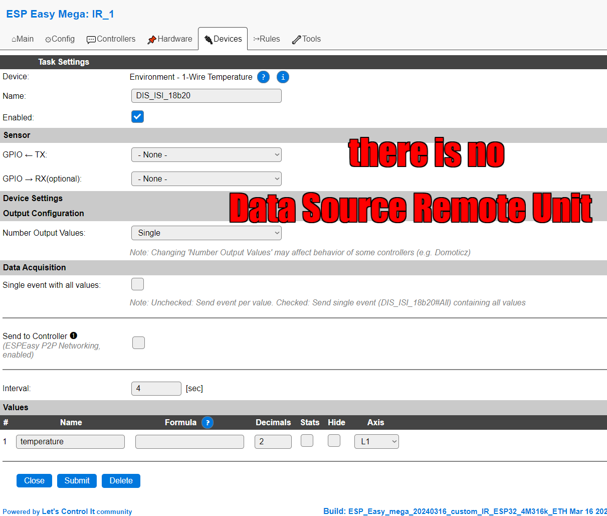

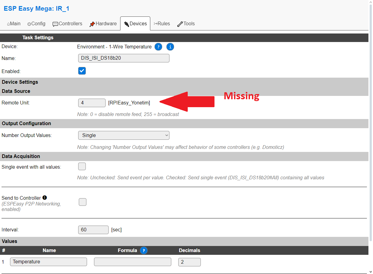

Thanks for the all, that built solve my problem with esp32. Sorry but at my old built I can get temperature value from ESPEasy P2P Networking but this built I cannot. Please see the old and new builts Environment - 1-Wire Temperature page, at new build there is a missing Data Source Remote Unit:
new build
new build
old build
old build

You will have to repeat the configuration procedure, as documented in the P2P Controller page.

Ath wrote: 16 Mar 2024, 19:07 You will have to repeat the configuration procedure, as documented in the P2P Controller page.
Thank you very much, I hardly fix it
