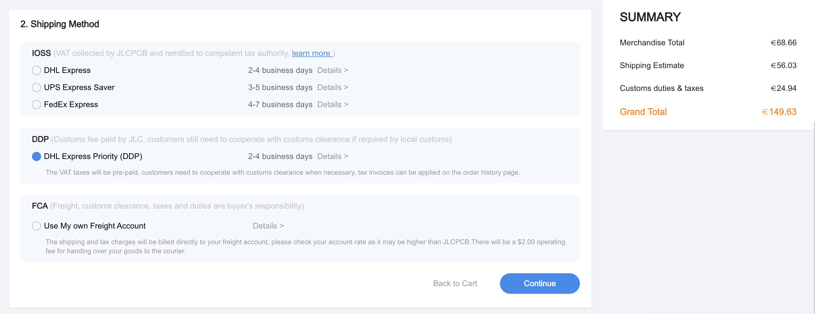

149 euros!!!
It's nothing like before.
When you get to the payment stage, it jumps to 142 euros for DHL DDP (with customs fees included).
Otherwise, it's over 130 without customs fees and only 3 shipping options (UPS, DHL, and FedEx).
It’s nothing like what was advertised.
I even tried 3 times and removed as many items as possible...
This is outrageous.
This is outrageous.
- Capture d’écran 2025-02-17 à 19.23.44.png (306.48 KiB) Viewed 4850 times

The costs are very likely because of through-hole component placement.
If you only have the PCBs, the shipment costs will still be the most expensive part.
You can also order 5 or 10 PCBs and then let them only assemble 2 or 5 boards.
With JLCPCB assembly you have 2 types of parts: Basic and Extended.
The Basic parts will add just the costs of the parts, the Extended parts add about 4 euro per different part.
That's why you should always look at the stock count and whether it can be done using a "Basic" part.
And if you need an Extended part, you should try to use it as often as possible (e.g. assume you need 10k and 20k resistors for whatever reason, you better use 2x 10k in series compared to 1x 20k)
Also through-hole components are _always_ "extended" parts.
And those larger parts like the HiLink transformers are quite heavy, which will add to the weight and thus shipping costs.
Those are also quite easy to solder yourself, so you could order those yourself from AliExpress or some local webshop.
You probably don't need 5 of those HiLink ones, right?
Those are probably the more expensive parts anyway.

I will take a look at all of this and maybe remove the 3/4 and go back to the simpler approach to solder the components myself.
It's not necessarily the almost 70 euros for the supplies that bother me, since for 5 PCBs and with the Hilink, it comes to almost 15 euros per PCB.
What bothers me are the almost 80 euros for shipping, which is excessive. They also impose express shipping, and I can’t even choose Europacket as initially stated.

Check what happens if you uncheck the HiLink modules when uploading the BOM.
I guess the weight and dimensions of the package greatly depends on those.

If I remove all the components and only leave the small resistors, the fuse holder, and the PCF chip, the price drops to 92 euros for 5 PCBs, delivered with DHL Express Priority (DDP).
If I only remove the HLK-10M05, the price goes to 104 euros.
Leaving everything as is, the total is 137 euros this morning (surprising how much prices fluctuate...).
If I only assemble 2 PCBs, I don’t save much—around 10 euros (without the HLK).
At around 5 euros per HLK on AliExpress, I’m wondering if it's really worth removing everything...

Well at least it is worth looking into the pricing structure as it will help you make an educated guess.
And this will help you accept the costs too
This is a rather simple board, but still assembling it yourself would at least cost you 30 - 45 minutes per board if you do it methodical and in series.
In other words, for roughly 45 euro more you don't need to spend about 4 hours soldering.

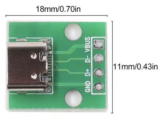

Hi, yes, I think you got it right
I'm getting addicted.
I have a question:
I removed all the components that are too complicated for me to solder myself, such as the PCF chip and resistors. I added this USB module, which is the one I currently use on my prototype and with which I haven’t had any power issues.
Should I also add the two 5.1kΩ resistances on D+ and D-? I also wanted to know if it’s possible to flash the ESP32-ETH01, which doesn’t have a USB port, using this USB module.

The 5k1 resistors are connected to the CC pins.
Since those are not exposed on that board, you just have to hope they either have them included or your power supply will accept it as discussed before
I am not sure whether you need to have resistors between the D+/D- and GND/VCC.
I would leave them alone for now.
When needed, those pins are still accessible.

So, to flash it, do I absolutely need the USB-to-serial module?
Wouldn't the small USB module on my PCB be enough?
So I just need to create a connector grouping TX, RX, GND, (5V, as I believe 3.3V didn’t work), and GPIO0?

The USB connector does only have pins with USB-level signals.
Not UART level signals.
The ESP board is going to be plugged in pin headers.
Programming you only need to do once, so you can pull out the ESP and program the board.

That's not a must. As Mr. TD-er has said above, "Programming you only need to do once, so you can pull out the ESP and program the board."
However, if you want to keep a provision for on-board programming in your board, it's better to modify your PCB and add an USART pinout that you mentioned. That will let you modify the program whenever you want to without removing the ESP from the board. By the way, is your board still in the designing phase or have you made a prototype? If you are thinking about the cost, you may have some idea from here: https://www.allpcb.com/blog/pcb-orderin ... -unit.html
