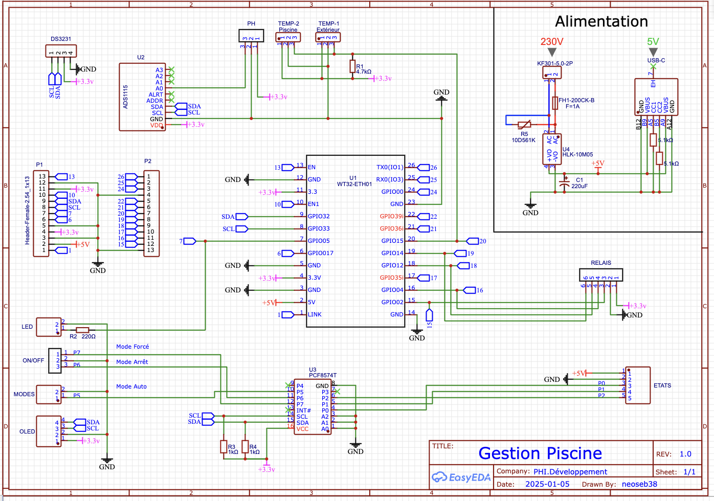

Hello everyone,
First of all, thank you for your quick and detailed responses.
Time Synchronization with DS3231
Since ESP-Easy updates the ESP32’s time in the order GPS > NTP > p2p > RTC, this works perfectly with the DS3231. My question is: once the DS3231 device is created and configured, will everything work automatically as described, or is any additional configuration required?
PCB Design – Choosing a DS3231 Module
I am currently designing my PCB and realized I forgot to include the DS3231. I am now debating between two DS3231 modules:

Attached is my PCB currently in progress:
- Capture d’écran 2025-02-02 à 12.20.22.png (360.84 KiB) Viewed 13220 times
- Capture d’écran 2025-02-02 à 12.01.23.png (226.28 KiB) Viewed 13222 times

First of all, let's start with the PCB design and safety...
I think your 'low voltage' part of the design is too close to mains voltage pins.
There is still some solder mask present, which also does isolate traces, but since you're using through-hole components, you have to take extra care especially in humid environments.
So for now, I would suggest to mount that PCB vertical in such a way that the mains voltage parts cannot drip any condensation water on low voltage parts (or vice verse).
For example with the USB connector pointing up.
Maybe also place some plastic strip between the 230V and "Temp-1" screw terminal. I usually make a slid in the PCB between such terminals carrying higher voltages.
I don't see the 5k1 resistors on both CC pins of the USB-C connector. Or is this a micro-USB connector? (there are USB-C connectors with limited set of pins, that's why I ask...)
I notice you're using both an ADC and 1-wire sensors.
Some of those Ali-Express sold 1-wire sensors do have a metal enclosure which is electrically connected to GND (probably a manufacturer mistake as there is no need for it)
However if you have an electrical connection between the metal enclosure and some other applicance which is connected through GND, you can have strange offsets in your DC-measurement and the metal enclosure of the temperature sensor will corrode quite fast.
Also make sure to check the logs of ESPEasy regarding the ADS1115. It is very likely the seller is sending you an ADS1015 or some clone.
The difference is sample rate and resolution.
Clone chips sometimes report the ADC value of another pin or just ignore settings like resolution.
About the RTC clock module.
One with a rechargable battery is nice to have, however keep in mind these can only be used in a limited temperature range.
Also not sure if there is a charge-monitor on that cheap board. Most of those do not like being charged over 3V.
How much is this 'significant time drift' ? Seconds per day?
Keep in mind there is no battery voltage monitoring on those modules as far as I know. This means you will only find out when you need the RTC clock.
You can also consider using a GPS module when the unit does have a clear view of the sky.

If you have the option, please mount it with the high-voltage side at the bottom.Neoseb38 wrote: ↑08 Feb 2025, 10:22 1. Regarding PCB Design and Safety:
I will increase the spacing in the routing and the ground plane between the high voltage and low voltage sections. Furthermore, my PCB will be housed in a box that is mounted vertically against a wall and located in a closed room.
My question: For my ground plane design, should I implement it only on the component side, or should I use both sides of the PCB, connected by vias? Your advice on the best approach would be greatly appreciated.
Preferrably in such a way that if condensation water drips down, it never forms a 'path' from low-voltage to high voltage.
I always use 'copper pour' in my PCB designs and connect it to GND.
Of course not on high-voltage areas.
So you design your board layout and then draw a copper pour area on both sides of your PCB on the low-voltage areas.
Whenever you let the board re-route, you can generate this copper pour area again or it will be recreated automatically.
This copper pour has several functions:
- Limit noise
- Improve ground in your circuit
- Offer a level surface for components to be mounted.
This last funtion is less important for through-hole components, but may make quite a difference when using SMT assembly.
The parts will be much more mechanically stable. For example large capacitors could otherwise 'wobble' a bit and then the solder joints may break.
I don't see no datasheet link.Neoseb38 wrote: ↑08 Feb 2025, 10:22 2. Regarding the USB Port:
You stated:
"I don't see the 5k1 resistors on both CC pins of the USB-C connector. Or is this a micro-USB connector? (there are USB-C connectors with limited set of pins, that's why I ask...)"
I am using a USB Type-C 3A 6-pin port solely to power the enclosure at 5V from an external supply (like those used for mobile phones). I have designed the PCB to allow a choice between a 230V supply and a 5V USB Type-C supply (here is the manufacturer's link: [datasheet link]). I am not entirely sure if the 5k1 resistors are necessary in this configuration, so I appreciate your input on that.
If the USB-C connector does not offer CC1/CC2 pins, then you don't need to add those 5k1 resistors.
If those are present, you should add those between CC1 and GND and CC2 and GND.
If you don't then there is no guarantee the USB power supply you plan on using will deliver the required amount of current, or even stays on.
Maybe best to wire it up to test.Neoseb38 wrote: ↑08 Feb 2025, 10:22 3. Regarding the ADS1115:
You mentioned:
"Also make sure to check the logs of ESPEasy regarding the ADS1115. It is very likely the seller is sending you an ADS1015 or some clone. The difference is sample rate and resolution. Clone chips sometimes report the ADC value of another pin or just ignore settings like resolution."
I will ensure to purchase an original ADS1115. Although I haven't used it yet, I have included it in the design as a precaution for a future upgrade—specifically for measuring the pH of my pool water.
As I said, there are quite a lot of sellers selling a fake module.
Simple way to test is to make a small array of resistors (e.g. 100k or 10k, doesn't really matter as long as they are in the same order of resistance)
Then connect them like this:
3V3 --- R --- A0 --- R --- A1 --- R --- A2 --- R --- A3 --- GND
This way each analog input has a different but constant voltage to measure.
Then enable the 'stats' option in ESPEasy and let it run for a while.
There only should be some noise, but not much.
For fake modules, the measured voltage may be from the wrong pin, thus the voltage will either hop around a lot or all pins report the same voltage.
Then the swap between ADS1015 and ADS1115.
One has lower resolution but higher possible sample rate.
ESPEasy should be able to detect this and tell you in the logs what it found.
If not, try to see what the smallest 'jump' in sampled values is with the resistor-array and you can see if it was 12 bit or 9 bit.
Well you have to chose between the following:Neoseb38 wrote: ↑08 Feb 2025, 10:22 4. Regarding the RTC Module:
I am still undecided on which RTC module to choose. Its role would be to maintain the correct time in case of an Internet outage, and potentially for future enhancements. Could you please suggest a model or advise which one would be best for my application?
- Using a coin sell; You have no idea when the battery is discharged other than that the system doesn't know the time when you actually need it.
- Using a rechargable battery; These should have some charging circuit or else it might damage the cell. No idea how long those keep their charge, but typically those RTC clock chips have extremely low current requirements... when their board is well designed.
I doubt any clock drift is a problem in this setup. Even if the clock is off by a few minutes, then it really isn't that big of a deal, right?
In the ESPEasy rules, you can also check whether the time has been set (%isntp%) and if the battery of a RTC module is empty, the RTC clock will likely show a very unlikely year like 1970.
So you could check the %sysyear% to be > 2024 and less than 2038

TD-er wrote: ↑08 Feb 2025, 13:37 If the USB-C connector does not offer CC1/CC2 pins, then you don't need to add those 5k1 resistors.
Not having these resistors installed correctly was the cause for many USB-C power supplies and power-banks not supplying 5V on the first revision of Raspberry Pi 4 boards (except for the original RPi USB-C power supply). They fixed that in later revisions.Neoseb38 wrote: ↑08 Feb 2025, 14:51 Do USB Type-C connectors exist that don’t require additional resistors?
So far, in my test circuit, everything is powered through this USB connector, and I don’t see any resistors:
https://fr.aliexpress.com/item/10050058 ... pt=glo2fra
So, having those 5k1 resistors in place can be important. Better safe than sorry
Re: Using the DS3231 Module and Other Modules for Time and Relay State Management with ESP-Easy
Like this?
- Capture d’écran 2025-02-08 à 15.13.03.png (370.41 KiB) Viewed 12855 times
Yep, from the CC1/2 pins, 1 resistor per pin to GND.
N.B. these CC-pins did not exist on USB-A connectors, so if you have an USB power supply only using USB-A connectors (the old rectangular ones), it will probably work just fine without those resistors, though it is depending on the USB cable used.
Since your connector does not have the data pins available, those might be pulled down by the USB host and thus it might conclude no device is plugged in and then starts 'polling' for a device and thus constantly turning off/on the 5V.
That's why it also matters which cables you use. And no I don't know which cable/power supply will work anyway regardless whether you connect a non-standard USB device.
I can only say that since I started using those IKEA USB cables, I have had no more issues like these.

Hi everyone,
First of all, thank you for your help and advice, especially regarding the resistors for the USB-C port!
I’ve also added a female Dupont connector to my PCB with VCC, GND, SDA, and SCL to support a DS3231 RTC module ([this version](https://passionelectronique.fr/tutorial-ds3231/), which includes an EEPROM and a temperature sensor).
This way, I can keep this option for later use.
Since the module has two connectors, I decided to use the one without the male pins, which seemed more practical.
Now, about my PCB project for managing two swimming pools:

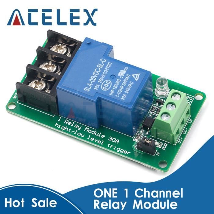

I'm looking for a more robust and versatile solution that can handle both setups:
A 30A relay module ([see here](https://m.media-amazon.com/images/I/61A ... L1500_.jpg))
A 40A SSR relay (but will it overheat due to the pool pump's power consumption?)
Adding a diode to protect against inductive loads?
Keeping the snubber for the pool that uses a contactor?
Do you have any recommendations?

I just received the 5V 30A relay module as a replacement for the smaller 10A relay module, and it works perfectly (both unloaded and with a simple 230V 60W light bulb).
I doubt this module can handle such high currents, but since high-power filtration pumps use a contactor and only low-power pumps don’t, I’d say that for a 500W pump, considering the startup peak, the current shouldn’t exceed 16A, and only for a very short time.
Of course, I will add an RC snubber in parallel with the contactor.
I tested the GND and GPIO2 pins that activate the relay, and I’m getting 3.15V, while the relay is powered at 5V.
So, it looks ESP32-compatible, meaning I can skip the logic level converter and save space on my PCB.
I also tested the status feedback using my 230V to 5V optocoupler, which connects through the PCF8574 module.
Since this module is powered via I2C at 3.3V, and despite the 5V coming from the optocoupler, the I2C voltage remains stable.
As integrating this module into my PCB was too complicated, I just hope I didn’t make a mistake by directly implementing the PCF8574 chip on my PCB.
For the PCB routing, I used:
2mm traces for AC
0.5mm traces for DC
What do you think?

The trace-width should be related to the max. current.
The used voltage doesn't have anything to do with the trace width. The distance between traces is what matters with higher voltages.
As a rule of thumb, keep at least 1 mm per 100 V.
For mains voltage this means you need to keep at least 3 mm between traces and preferrably double it for solder joints. (the 'green' solder mask on your PCB is a remarkable good isolator)
For power nets upto 1A, I typically use 15 - 20 mil trace width. When you really need to carry a beefy current, don't hesitate to use wider traces and multiple vias when you need to switch layers for such a current.
About switching the relays...
You better still use a FET or normal transistor to switch the relais as the GPIO pin of an ESP can only source a few 10s of mA.
Also don't forget to add a diode over the coil to protect the electronics when you switch the coil current to 0 as the coil will then generate very high voltages (can be as high as > 1000V) to keep the magnetic field the same.
If such a circuit is already present on your relay module, then you don't need to add it of course.
Those "230V to optocoupler" boards like the one you're showing is quite a waste of energy.
See the beefy resistor, which has to be this large for a reason.
If it is just an occasional detection, then it is probably not an issue, but keep in mind this is quite wasteful when ran continously.

Thank you for your clarification.TD-er wrote: ↑10 Feb 2025, 21:53 The trace-width should be related to the max. current.
So, if I set the AC part with a 2mm trace width and 3mm spacing between traces, and 0.5mm for all DC traces with a 0.3mm spacing, it should be okay?
Am I really required to add this? If so, what exact component should I use, and how should I connect it to my PCB?About switching the relays...
(Sorry, but I don’t know much about this, and I’ve been struggling with this PCB for a month now, all alone, with no prior knowledge
I can't tell if this is already installed on the relay module since I don’t know what it looks like.
Can I remove my logic level converter since my GPIO is correctly running at 3.3V?

The only thing I can say is that currently, on my prototype, I am using a PCF8574 module, and it works perfectly. So far, I haven’t had any issues in my tests.
Due to the limited number of available GPIOs on my ESP32 ETH01, I am using the PCF8574 exclusively for my switches connected to GND:
Forced filtration mode
Stop mode
Auto/manual mode switch
"Auto" mode for ESP Easy rules
"Manual" mode for using the pool’s original system
I also use it to monitor the state of the 230V optocouplers.
I just hope that on my PCB, I have correctly integrated the PCF8574 chip, the pull-up resistors, and properly connected the A0, A1, and A2 pins to GND to maintain the same default address as the module.
The relays and temperature sensors are connected directly to the ESP32.

In your PCB drawing tool you probably have some option for "copper pour".
This way you can draw an area and assing a net to it (e.g. GND).
What this does is it will fill up any holes between the traces with copper and connect it to this copper pour net.
This way you have much wider traces at no extra costs.
Since you have 2 sides of your PCB, you could use GND on the bottom and 3V3 at the top.
When you place the parts not too tightly packed on the PCB, there is lots of room between the traces and thus you'll have a proper power net on your boards without much to worry about.
N.B. do not use copper pour near high voltage nets.
The relay board you have seem to have some extra parts, so it looks like these actually do have an optocoupler on the module.
Thus the load of that relay board to your ESP is the same as if you're connecting a LED.
This way you probably don't need to add any level converters for them to use.

Indeed, I forgot to mention it, but the module does include an optocoupler (YYG-3 high-power bidirectional isolation relay 30A (5VDC) from Amazon).The relay board you have seem to have some extra parts, so it looks like these actually do have an optocoupler on the module.

One more thing...
You seem to have 5V to your PH sensor.
What (analog) voltage does this sensor return?
The analog input of the ADS1x15 should not exceed the supply voltage. (3V3)
And the 1-wire sensors...
They both use the same GPIO pin, so you technically only need a single pull-up resistor.
How long will the wires be from the board to those sensors?
With 2 sensors it probably isn't that much of an issue, but typically you should not have an Y-shaped bus.
Now you have a very short trace from the ESP to the bus and then the sensors 'pointing away' so it is more like a normal bus.
But still if running long wires, this might be an issue.
The on/off switch and the modes switch do not have a pull-up resistor from 3V3 to their non-GND pins.
Maybe good idea to at least add those pads on the PCB to place some 10k resistor (or 4k7, doesn't really matter what exact value you're using) when it might be needed.
No idea how strong the pull-up resistors in the PCF are, but they might not be enough if those switches have long wires to them and pick up all kinds of noise.

Indeed, I recently replaced the 3.3V with 5V because one of the PH modules I found required 5V. I thought that, just like the PCF which was powered by 3.3V and received 5V from the optocouplers without affecting the I2C voltage, it would be the same.You seem to have 5V to your PH sensor.
So, I’ll switch it back to 3.3V; there are plenty of PH modules that work from 3V to 5V, so it will be fine. Anyway, many say that PH readings are fine but problematic over time because they require regular adjustments/calibration. I’ve made it optional
But thanks for the info, I’m correcting it right away.
Regarding the 2 temperature probes, I have to say that, indeed, the distance of one probe (the water temperature one) is very long… at least 8 metersAnd the 1-wire sensors...
Currently, I’ve never had a problem with the Arduino version that is working right now. On the Arduino, I soldered resistors directly onto each of the wires of the DS18B20 probes, and the 2 probes are connected to the same GPIO. I was planning to do the same.
I didn’t quite understand the Y story.
Do you advise me to remove one terminal block and connect both probes directly to a single terminal block?
For the switches, initially, I had them connected directly to a GPIO of the ESP32. But that caused problems and wasn’t reliable at all. They would turn on or off by themselves, I can’t remember exactly.The on/off switch and the modes switch do not have a pull-up resistor from 3V3 to their non-GND pins.
It was only when I connected them to the PCF module that everything worked perfectly without any issues. I had actually bought this module for that purpose, if I remember correctly, because I had read somewhere that it was great for switches, relays, and anything binary.

I did find one big error when looking at your schematic...
You have directly connected the USB-C connector to the output of the HLK...
Please check if the HLK accepts 5V on its output when it is turned off in the datasheet of that module.
For sure you should never (!!) connect it to an external power supply or a PC while the unit is also powered via the HLK.
It is best to add some diodes (1A capable, like 1N4007 or something similar) between the HLK and your 5V net and the USB and 5V net.

Of course, there will always be some parts of these traces which have to be routed on 'the other side', but when possible you could 'flip' those to the side where you have the GND copper pour and then the autorouter will find it easier to route your board.

Oof, thank you very much! I hadn't noticed the distance between the fuse terminal and the track going up to the negative terminal of C1.
I'm going to place C1 at the top, near the 5V of the power supply.
As for the antenna, indeed, I had thought about it and already read about it. I'll exclude copper areas around the antenna.
Regarding the power supply, I suspected that both shouldn't be connected at the same time. However, if I can add a safety measure, I agree.
If I add the two diodes, assuming that the HLK advises against powering the 5V when the 230V is cut off, would that solve this issue?
As for the diodes, should I place them like this?
There's quite a list of 1N4007, would this one be fine? (1A 1V@1A 1kV SOD-123FL General Purpose Diodes ROHS)
As for the traces routed on the top layer (shown in blue), it might be because the view is displaying both layers. You can even see the silkscreen on the copper side (under the ESP32).
Thanks again!
I would place the capacitor C1 inbetween the 2 diodes, so the + of the capacitor is at the +5V net symbol.
This way the C1 will also help when you power it via USB.
The orientation of the 2 diode is correct.
This way there is no current flowing in the wrong direction.
I just named the 1N4007 as that's one of the most standard diodes out there capable of handling 1A.
You can also pick 1N4001, or 1N4002 ... 1N4007.
The last digit is about the max. voltage, however the 1N4001 is also good enough with its 35V max. voltage. (1N4007 is upto 700V)
There are lots of other options, maybe even better ones, as the 1N400x does have quite a significant voltage drop of about 0.8V.
If you never ever will connect the USB while also connected via mains power, then you could leave out the diode for the USB port.
This way you won't run into problems with the "5V" input voltage on the ESP board if your USB cable isn't thick enough.
The 0.8V drop from the HLK is probably not a problem as there is no extra voltage drop from USB cable/USB connector.
One more thing...
Do you have the 220 uF capacitor at hand? If so, please check if it will fit inside the enclosure where you plan on placing it.
It does look a bit 'small' for 220 uF.
Thanks again for the info! I want to avoid any issues as much as possible, so if I can prevent problems with USB cable thickness, etc., I'll remove the USB diode and keep the current diode on the HLK side.
As for the capacitor, I don't have it on hand; I was planning to have it soldered during the PCB fabrication.
It's this model:
https://www.lcsc.com/product-detail/Alu ... 43319.html
However, I just realized I forgot something important!
An ON/OFF switch for the enclosure!
But how should I place it, considering there are two power supply options?
Should I place two vias on the PCB, where I can solder two wires to cut the 5V? For example, after the diode?
Would losing so much voltage due to the diode cause power issues for the ESP and the relay modules, optocouplers, etc.? And what if I replaced it with a 3-position switch? This way, I would have the option to choose between the 230V power supply, USB, or even off in the middle position.
3-position switch is also a good idea.
And since you're switching only 5V, you don't need to keep that much distance.
Just make sure you're not placing the switch close to the mains voltage parts
And maybe use one that's not that accessible so you can't switch it by accident.
If you plan on letting them solder the capacitor, you'd better not use a through-hole part for it as that will cost you more.
This time, I hope it's the right one.
So, I replaced the diodes with a 3-pin male connector to avoid the voltage drop caused by the diode on the 5V line.
With this connector, I can choose between USB or mains power using a jumper, and maybe later, a switch.
I also moved the capacitor as you advised and reworked the PCB.
+3.3V copper pour on the component side.
GND copper pour on the bottom side.
I just hope I didn't make any mistakes in the routing.
Hmm the position of the switch is a bit tricky.
Most of those switches have a metal enclosure and you need to reach it with your hands.
Does your fuse have a plastic cap or is the fuse reachable by hand?
You always need to assume you're not the only one to operate the unit.
If the fuse isn't shielded with a plastic enclosure, you should add something there to provide shielding.
Do you have a 3D printer?
Or maybe you can cut some shield from a "Chinese take-out box".
To quote Dave from EEVBlog: "My Chinese take-out oopsie box" when he covers his mains connected parts with one of those food boxes from the local Chinese restaurant so he can't touch those parts by accident... or when things go wrong his parts don't fly away too far

Oh and when you place a fuse, I think 1A is a bit too much.
At least make sure to take a 'slow' one. 500 mA should be enough, but the power-on surge can be quite a lot, that's why you need a "slow" one.

As for the fuse, indeed, the HLK datasheet specifies a Slow Fuse but at 1A.

Well both will burn in nearly the same time when you short circuit them.
And the traces are wide enough to handle a few Amp, so the fuse will burn first anyway.
I’ll listen to you and add a 0.5A fuse.

I was about to order my PCB, but...
I have a doubt about the pull-up resistors I added with my PCF chip.
Before, on my test PCB, I had this PCF module: https://passionelectronique.fr/tutorial-pcf8574/
On this link, they use 1k resistors. However, on the chip’s website, they mention a 1k resistor, and then for typical applications, they mention a 10k resistor. I don’t understand anything
https://www.lcsc.com/datasheet/lcsc_dat ... 652271.pdf
Now, I've integrated it into the PCB using the module as an example.
On my test PCB, everything works perfectly with the PCF module, the ADS1115 module, and an OLED screen.
This ADS1115 module: https://passionelectronique.fr/tutorial-ads1115/
I tested a PCF module I have (I have several), and I found 1K ohms between SCL and VCC, just like SDA and VCC.
That's why I put the same resistors on the new PCB.
Anything else, please?

Most pre-assembled modules with I2C components have 10k pull-up resistors on both SDA and SCL, as often they are connected in parallel on the same I2C lines, so effectively with 3 I2C modules the pull-up resistance per line will be 3k3. Having also a set of 1k pull-up resistors in parallel to 2x 10k resistors will result in an effective resistance of 833 ohm
. But the actual resistance should be 1k or higher (unless really long wires are used), so using 10k pull-up resistors should be just fine here.
Thank you for your quick response.
I'm replacing the two 1kΩ resistors with two 10kΩ ones right away.
