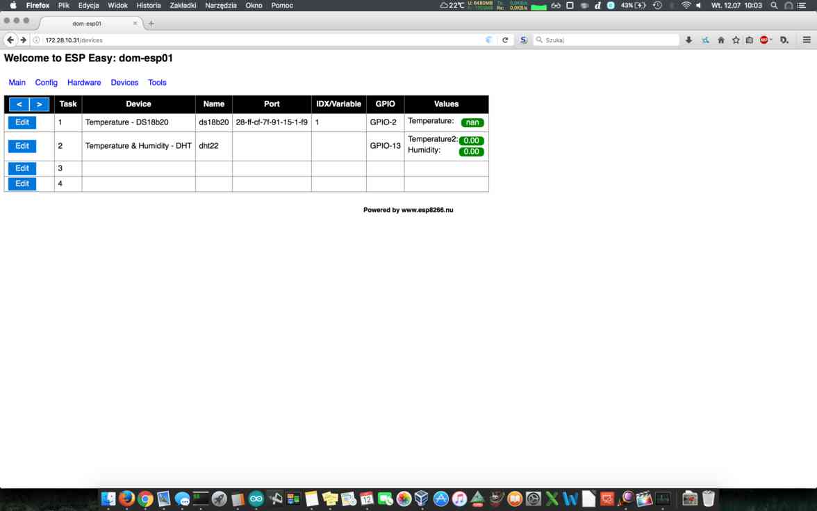

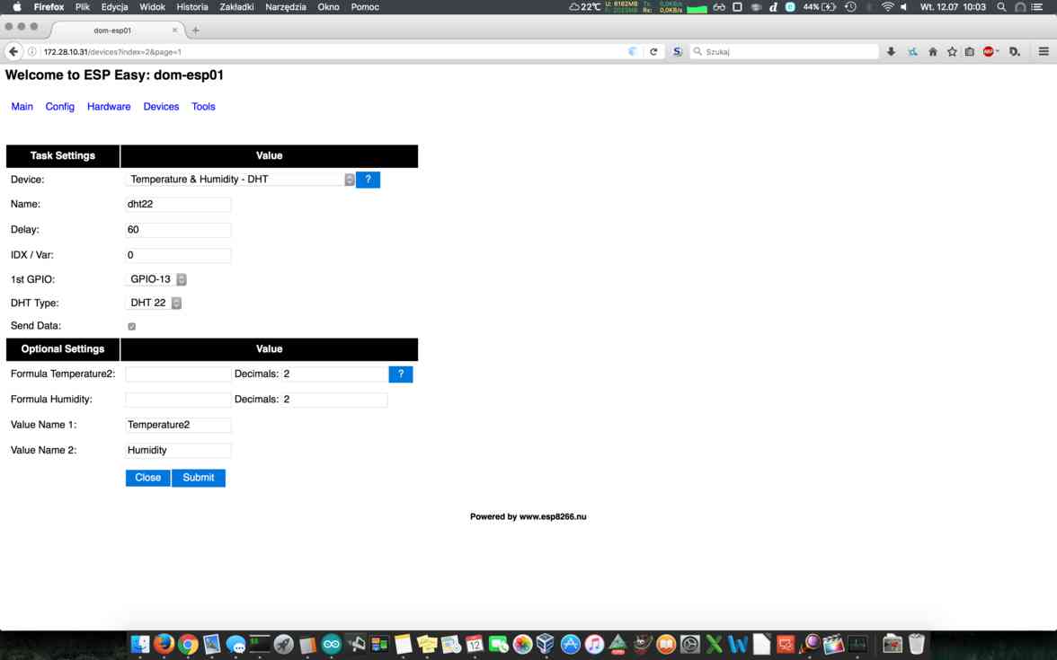

2. DHT22 doesn't work, I tested it with Arduino Leonardo and Adafruit <DHT_U.h> and it works, but not with ESPEasy. My config of DHT22 is on screenshots.

My dht22 works. I'm thinking it's because idx is zero. Assign a number.

This is solution, after setting idx dht22 starts to work.

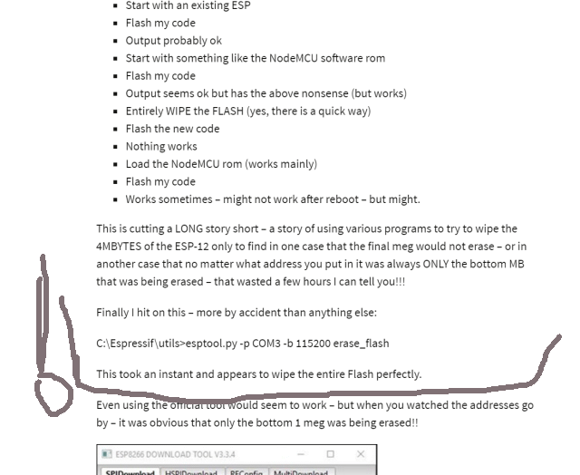

#7 Post by tozett » 17 Jul 2016, 17:37
since i follow the version/rom upgrades, i always had this similar issues with error-reboots after upgrade.
mostly i had assumed the flash-information left over caused this.
peter scargill reported similar and had a total solution.
maybe one has to try this, but it wipes all conifg. maybe one makes a config backup-before...(it this holds the new version clean ??)
http://tech.scargill.net/esp-sdk-and-rboot-woes/
