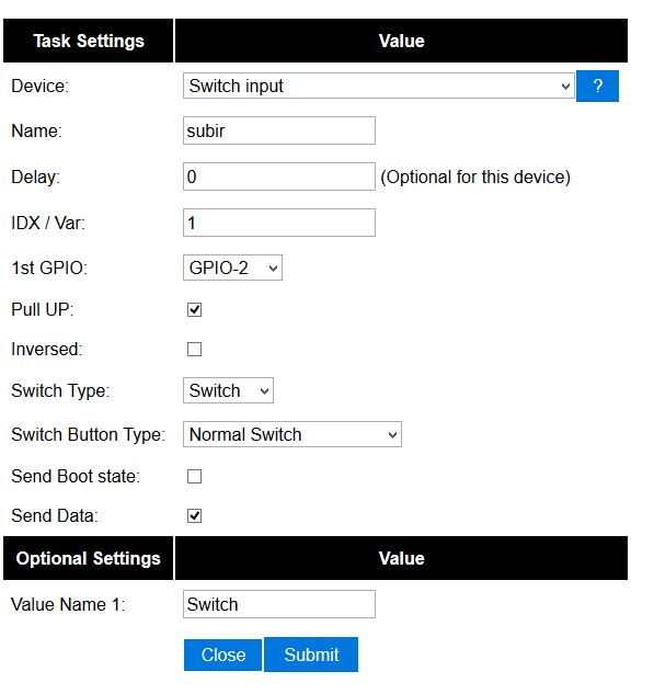

Continue with my test of ESPEasy and mqtt, i want to publish by openhab to mqtt to switch on GPIO2 on device with ESPEasy.
After configuring and touch many configurations in ESP Easy, i decided to reset device, to begin from 0 (i did it by rule like this):
On System#Boot do
  publish /nodemcu/cmd reset
  reset
and worked because i tourned to R108.
After rebooting device, i update to R113, and then I configure, IP device, mqtt server, and devices (rules are all 0):
In hardware menu, i have PIN 2 like default.
Well, when i switch on device, led in GPIO Switch on. and then by http i turn it off, becaue i want begin with my test.
I dunno why, after a few seconds, after turning off led by http, himself turn it on automatic, there are logs:

I dunno why, each time when device lost connection to broker and connect again, always switch to 1 GPIO 2.
maybe is a bug on R113? Why this occurs?
thanks

The only thing that was wired is a led. to show if GPIO is 1 or 0. But well, at the end i found which was the problem, but i don't understand why. The problem was other esp that i have plug, but with other name_device, and other devices name, that each time (publish something) and led on esp1 switched on, every time that i switched off.
