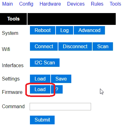

The easiest way to upgrade your modules is using OTA (unless you have the classic 512k modules
). Just upgraded 15 modules, 100% success rate.

I tried a sonoff-device, now I cannot reach it any more. It said, Update ok and then it dissapeared.
Re: ESP Easy Releases
That problem i had to when i diid a update on the fly..ambassadoro wrote:I tried a sonoff-device, now I cannot reach it any more. It said, Update ok and then it dissapeared.
Just the "old" way is the best in my eyes..
SonOff devices usually have a 1 megaByte flash chip so if you make the binfile yourself you have to choose these values:ambassadoro wrote:I tried a sonoff-device, now I cannot reach it any more. It said, Update ok and then it dissapeared.

If you choose a different FlashSize/SPIFFS your ESP and OTA will not function anymore and you have to re-flash it with a USB/Serial converter using USB.
