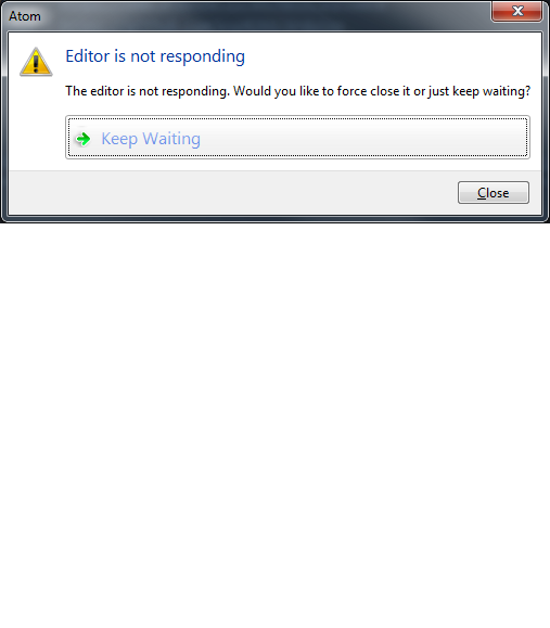

Still the same problem. When I press F7, i get a pop-up saying that the editor is not reponding ...

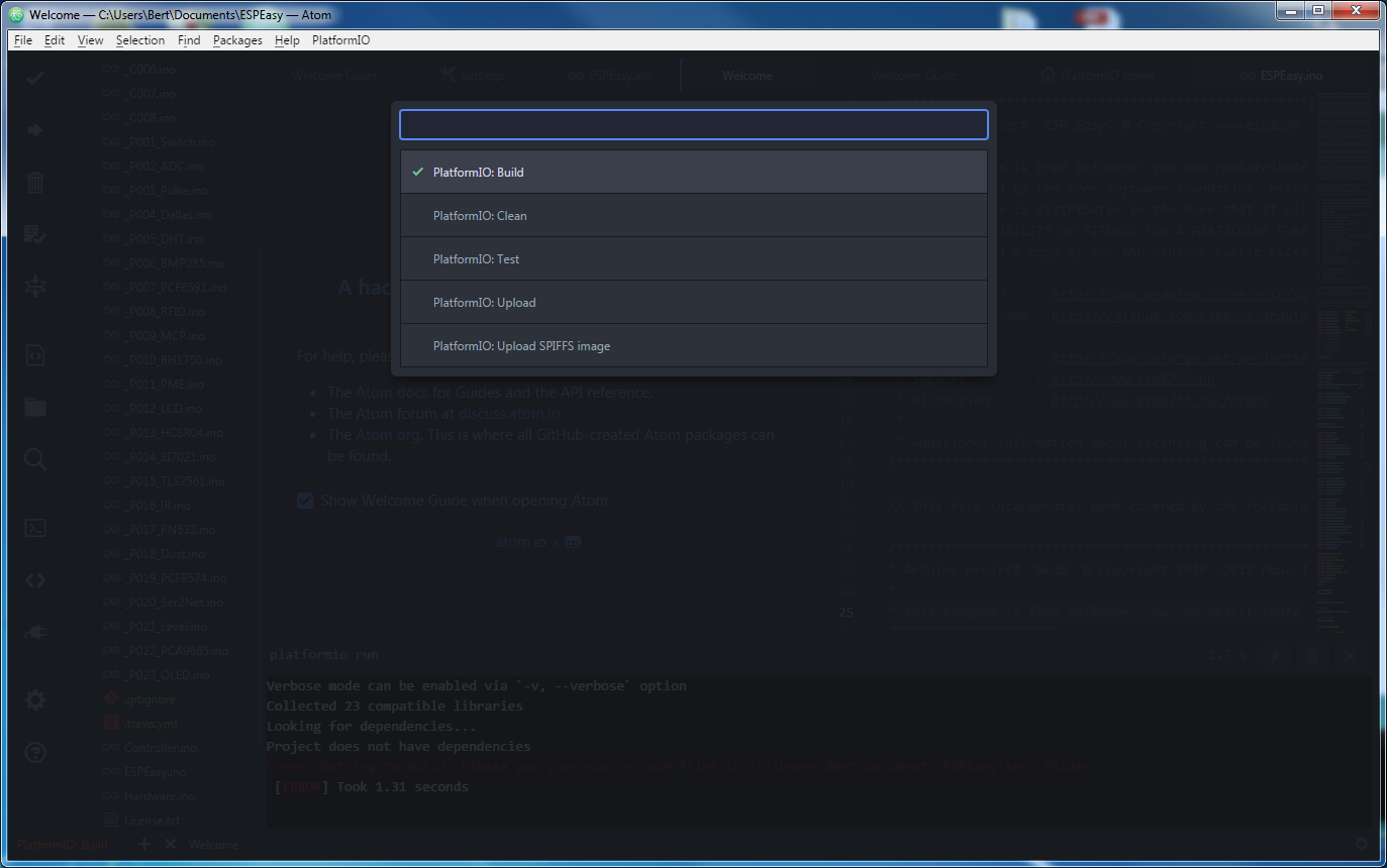

I am a step further, I had to choose a board and now the editor starts but I do not get the options.krikk wrote: ↑06 Mar 2017, 19:09 did you also remove all user directories after uninstall, so that you really start on a fresh base.

This is what I get

Somehow I managed to get the choice to select the Wemos D1 mini, but now Atom says it cannot compile because there is nothing in the .../ESPEasy/src folderBertB wrote: ↑06 Mar 2017, 20:15I am a step further, I had to choose a board and now the editor starts but I do not get the options.krikk wrote: ↑06 Mar 2017, 19:09 did you also remove all user directories after uninstall, so that you really start on a fresh base.

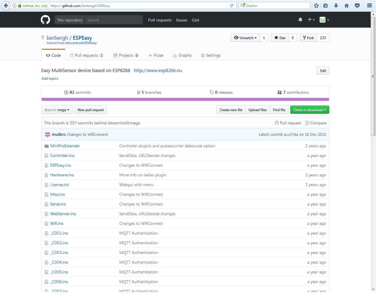

Did you open the ESPEasy folder in Atom, or did you open the src folder directly? (you should open the ESPEasy folder)BertB wrote: ↑06 Mar 2017, 23:08Somehow I managed to get the choice to select the Wemos D1 mini, but now Atom says it cannot compile because there is nothing in the .../ESPEasy/src folderBertB wrote: ↑06 Mar 2017, 20:15I am a step further, I had to choose a board and now the editor starts but I do not get the options.krikk wrote: ↑06 Mar 2017, 19:09 did you also remove all user directories after uninstall, so that you really start on a fresh base.

Hi. Thanks for the reponse. I am desperately trying to get things up and running, cause I have a lot of ideas, however this kind of programming techniques, I am not familiar with. So please forgive me for asking many stupid questions.
Before I first managed to get any reponse to the F7 keystroke, I had to choose a board with the initialize or update button.
My working folder is /Documents/ESPEasy. In it are:
.git
.pioenvs
lib (with only readme.txt)
MiniProExtender
src (with some files starting with a . (dot)
and a lot of 'normal' ESPEasy stuff.

Re: ESP Easy development status
By the way,
I do not get your list after hitting F7, but this:
Then something went wrong. You shouldn't need to initialize. (initializing creates or updates your platformio.ini, but we've already created a platformio.ini for you with all the nice options you should see in the F7 list)
Can you remove the ESPEasy directory completely, clone again with Github desktop, and then open it again with Atom and press F7.
If it hangs again when you pressed F7, wait a while (30 seconds or so) and then an error will pop up. Please create a screenshot of that.
Edwin
I did as you suggested.
This is the result.
This is the result.
I have gone through the setup all over again and now I see the fault is maybe somewhere in my interaction with Github.psy0rz wrote: ↑15 Mar 2017, 01:53 In the meanwhile i also fixed building in Arduino IDE again and updated the wiki.
Use at least v2.0.0-dev7 and the changes i made here: https://www.letscontrolit.com/wiki/inde ... are_Upload
When I am at letscontrolit/ESPEasy, I see: And after Fork:
I think the Forking is not actually been done.
the file structure looks like the naster branch, although github says mega-branch for some reason.
github should always fork all the branches i assume.
Okay ... so I went kamikaze and deleted my repository.
After that, I forked ESPEasy again and now things start to work.
