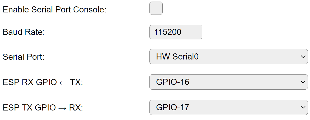

I just bought an NSPANEL UK.
I flashed it in "20230623 Display 4M" version.
When I set the device, nothing works (while the screen works well under tasmota).
NB: I have unchecked the box concerning the serial in advanced setting.
I checked with the Nextion software, the connection is indeed 115200 on my screen.
When I do in chrome "http://IP_OF_MY_NEXTION/control?cmd=NEXTION,dim=50"
It display : "NEXTION075 : WRITE = dim=50 OK"
But the screen stay Dark instead of showing me the page I configured via the NEXTION editor.
Could you tell me what I need to do to make it work?
Thanks in advance.

#547 Post by Smotek7 » 18 Jul 2023, 08:19
Now I noticed that you have Tx Rx on the contrary.
I think that it is wrongly marked in the HW display.
This is how I do it.
Yes, I use the Nextion plugin on NSPanel.
US version 1pc,
EU version 1pc (works approx. 1 year)
flightman
